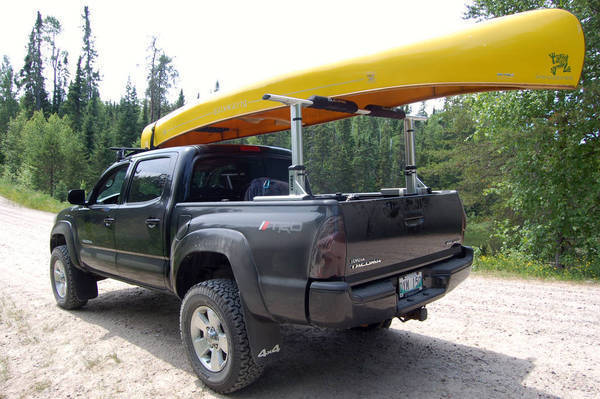

    I can answer this.
    That is a 14.5' solo woodstrip canoe I built. I needed to use my front rack bar and the rear bar of the bed rack I built. It wasn't going to clear adequately otherwise.
    I have a 17' Wenonah as well, same thing, I need both to clear the cab.

    Mwall, Any luck with cap rack? It looks like a factory rack with a cap rack will be the best way to carry the canoe. I'm curious to hear how your rig worked out?

    Nice canoe, Nat. I think i'm dealing with a 15' canoe (mad river Intrigue). It looks like I have two options: put a factory rack on as well as the cap rack or use the cap rack plus a third bar over the dbl cab. How do you like the factory rack...I've read good things about them. Not a fan of how they look on BSP colored trucks, like mine, though.

    Had to chime in.
    Nat. Are those 255 or they 235!
    Just a word if caution for anyone transporting a canoe. The truck bed can move independent of the can. A tightly strapped canoe can experience some pretty rough forces if you are leaving smooth roads...
    Something as solid as a Coleman ram x probably won't be affected. Lighter canoes don't like it...
    If you have a rack on your cap you can always add canoe stops. Basically an l bracket. Not only do they provide lateral support but they will life the boat up another inch or so...
    Just something to be conscious of.
