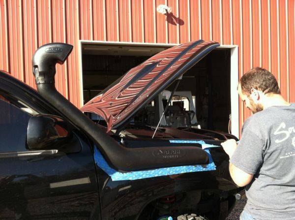

    Installed my Snorkel with some help from jandrews and lurry. Didn't need anything extra except for some silicone to seal everything up. Maintained the stock intake hose too.

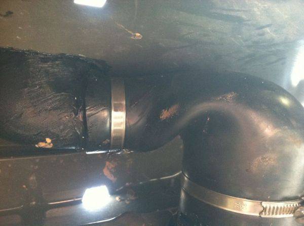

    Got in there today to ensure everything was sealed good and saw this. May have to play with it some, but I am not throwing any trouble codes and the truck is still running good. Gonna try and adjust it some tomorrow, if not may have to do something else.

    Try sliding that metal component out of the rubber sock a bit and further into the stock intake tubing. I'd just loosen the hose clamp over the metal insert, try to work everything straight, and then re-tighten the hose clamp.
    People bitch a lot about "restrictive airflow", but it only matters at the track, and almost nothing is more restrictive than your air filter. That's why a lot of track cars run with open intakes, no filter at all.
