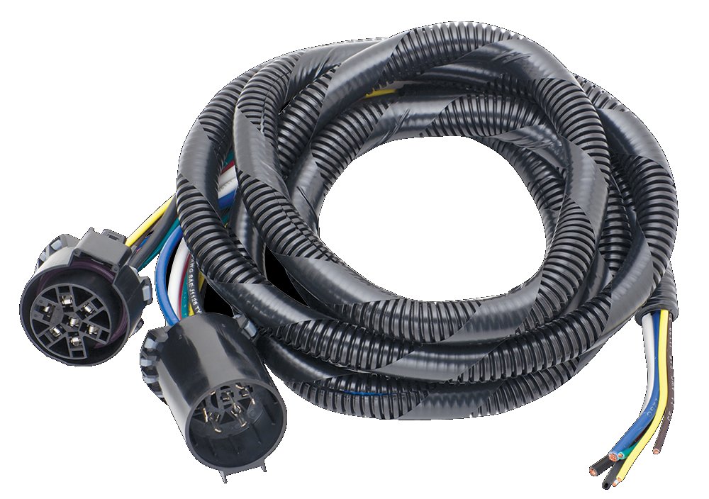

    The trailer I tow only has blinkers and break lights. I believe the harness you sent me is the one. Looks like it will work great.
  13. Oct 22, 2020 at 1:59 PM
    caribe makaira
    caribe makaira Well-Known Member
    Feb 13, 2011
    #51121
    11,734
    Caribbean, Puerto Rico
    05 PreRunner TRD Offroad AutoTrans
    Hood Struts, My version Fogs always ON, Map & Overhead Light Mod,

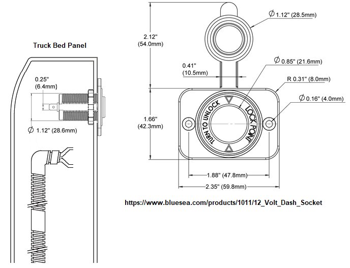

    FYI, I recommended the OP get this:
    https://www.etrailer.com/Custom-Fit-Vehicle-Wiring/Tow-Ready/20140.html
    so as to have a no cut Y harness.
    Just use the Towing Battery Charger circuit and the ground. Other circuits tap for later mods.(Maybe)
    Site mentions is for a Tundra, but it fits the Tacoma.
    This:
    https://www.bluesea.com/products/1011/12_Volt_Dash_Socket
    And this:
    https://www.bluesea.com/products/1010/12_Volt_Plug
    To add juice to the fridge.
    Also recommended lowering the fuse amp type to 20A from 40A.
    All wires not used insulated and secured to minimize flopping around and sound.
    It's a little overbuild...
