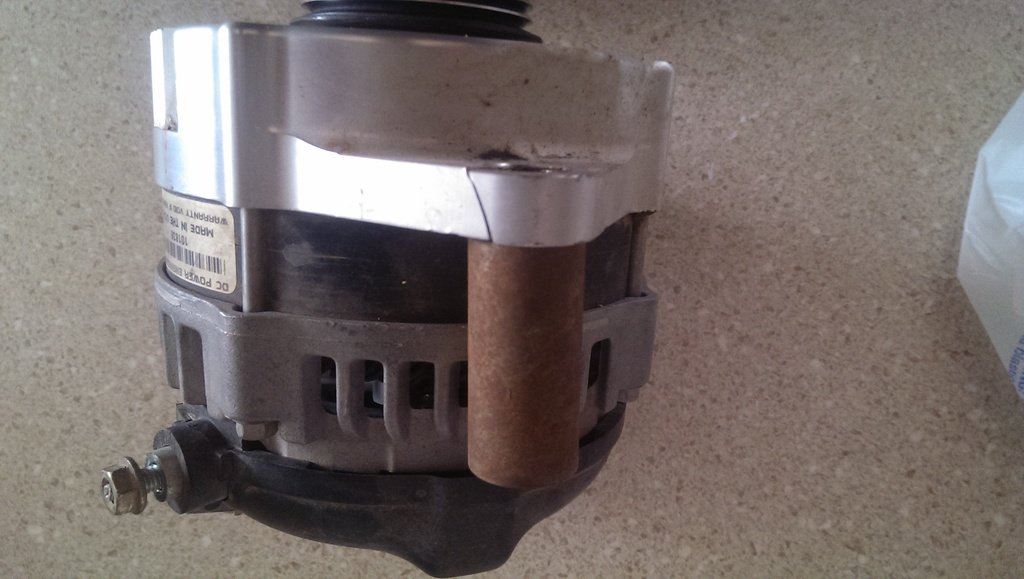

    Welp, Just had another issue. Now the damned adjustment bolt on the lower alt bracket broke. Sigh.. Its gotta be this dc alt not being 100% perfect fit. Something is obviously not right making it keep doing this, and Idk what. Because I torqued everything down last time, and tightened the belt perfectly. I did do some offroading recently as I haven't in quite a while. So the extra vibes might be causing it to get stressed even more. Seems like this happens shortly after I do go offroading now that I think about it. For now I'm just gonna order up a couple extra of the adjustment bolts as well as another bracket. If it happens again, probly gonna contact dc and see what they say. If nothing else, I'll be looking for a different alt.

    That's the thing. I did just get it cinched on there. I torqued the top bolt to like 35 iirc. The bottom bolt I put a nylock on and barely tightened that one as well(the one that broke that has the threaded insert for the adjustment bolt to thread into). I tightened The belt first before tightening that bolt. Then I literally barely tightened the adjustment bolt again just to have make sure it wouldn't fall out as it seemed too loose. It's like there's too much stress on it regardless of what I do. Any looser and the alt will loosen up and the belt will slip. I was actually expecting that because I thought things WERE too loose last time.
    Idfk.. I don't think there's any way to further reinforce it with an extra bracket or anything either. Certainly don't have the tools to make one. I'm wondering if I should try hardened washers instead of the tiny spacer they have in there for that lower bracket and bolt. Think I will. Just don't see how that'd help now that it's the bolt that broke and not the bracket.

    It almost sounds to me like that bracket is too short for the new alternator, though from looking at the original picture again, it looks kinda like the spacer is not the right size. Something is definitely not spec.

    Negative. If you look at my previous pics you can see where it get a tightened down. And the top bracket was a really tight fit. Kinda seems like the spacer in the top was a hair too long, that it's not getting tightened down on the alt and bracket itself but the spacer instead, allowing it to come loose on top. Now that I think of it that be the issue. Its probly not getting tight enough on top, but only the bottom causing more stress on the bottom components. Probly why the case cracked last time because I tightened it too much. Idk. I feel I should contact the company again and see what they say. Doubt many tacoma owners actually use this alt. I may be the only one. Ha. Maybe there's fitment issues they aren't aware of.

    I think I just figured it out guys.. I think this design, is just not a good one. If you look at the pic, the top support uses this long spacer that is pressed into the front billet case on the alt. And there's no support in the back. So most of the weight is being transferred down on the lower components. I would think the top support would be enough, but it's gotta be that.
    Compare that to an oem one or the singer that @ramonortiz55 posted above. You'll see that it has an extra case support for the rear as well! Might not be the issue, but certainly seems like it's a possibility. Its too damned heavy, along with the extra turning torque required on this alt, I bet it's flexing under load, as well as extra vibrations and stress while offroading!

    Well I haven't had any issues as of late. Haven't done much offroading lately. I was concerned the extra vibes might affect it. But I believe the case broke because I tightened it down a tad too much. And I mean literally a tad. It's just snug in there now. Including the lower alt bolt. Hasn't come loose on me and cause slipping. Yet. So I believe its just more sensitive to torque, as far as the top bolt goes. And the bottom, well, I have no idea. But I got spares in my truck ready for it. And yeah, they should have included a special extended bolt for that lower mount. Or like you said machined it down thinner.
