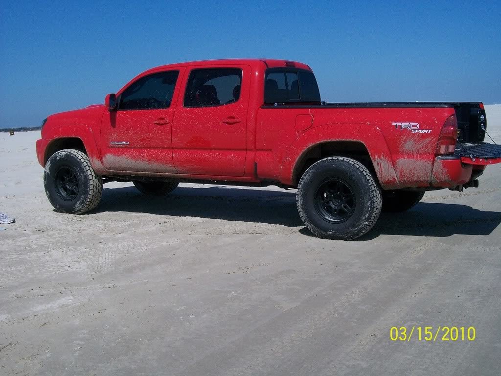

    I tow and with my 5100s set to 1.75" I was definitely nose-high. Even when I wasn't towing (see pic above) it "looked" nose-high even though measurements from the hub front and rear were level.

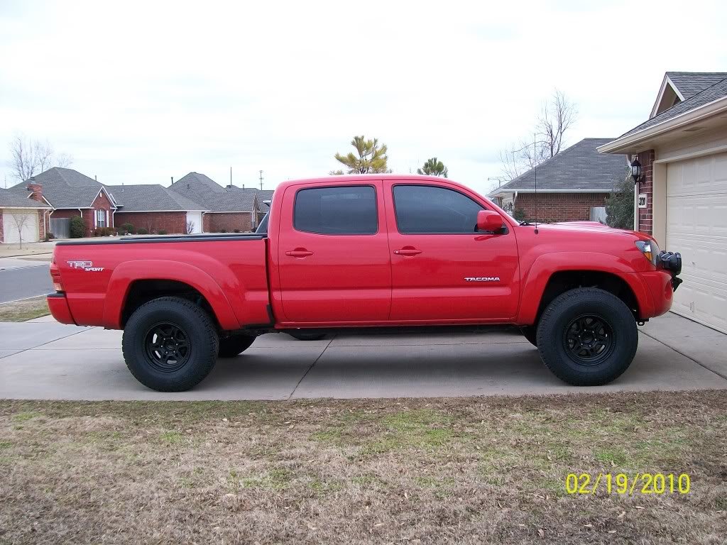

    TSB Rear and Billies set at 2.5" up front. TRULY level in my opinion. Merry Christmas.
