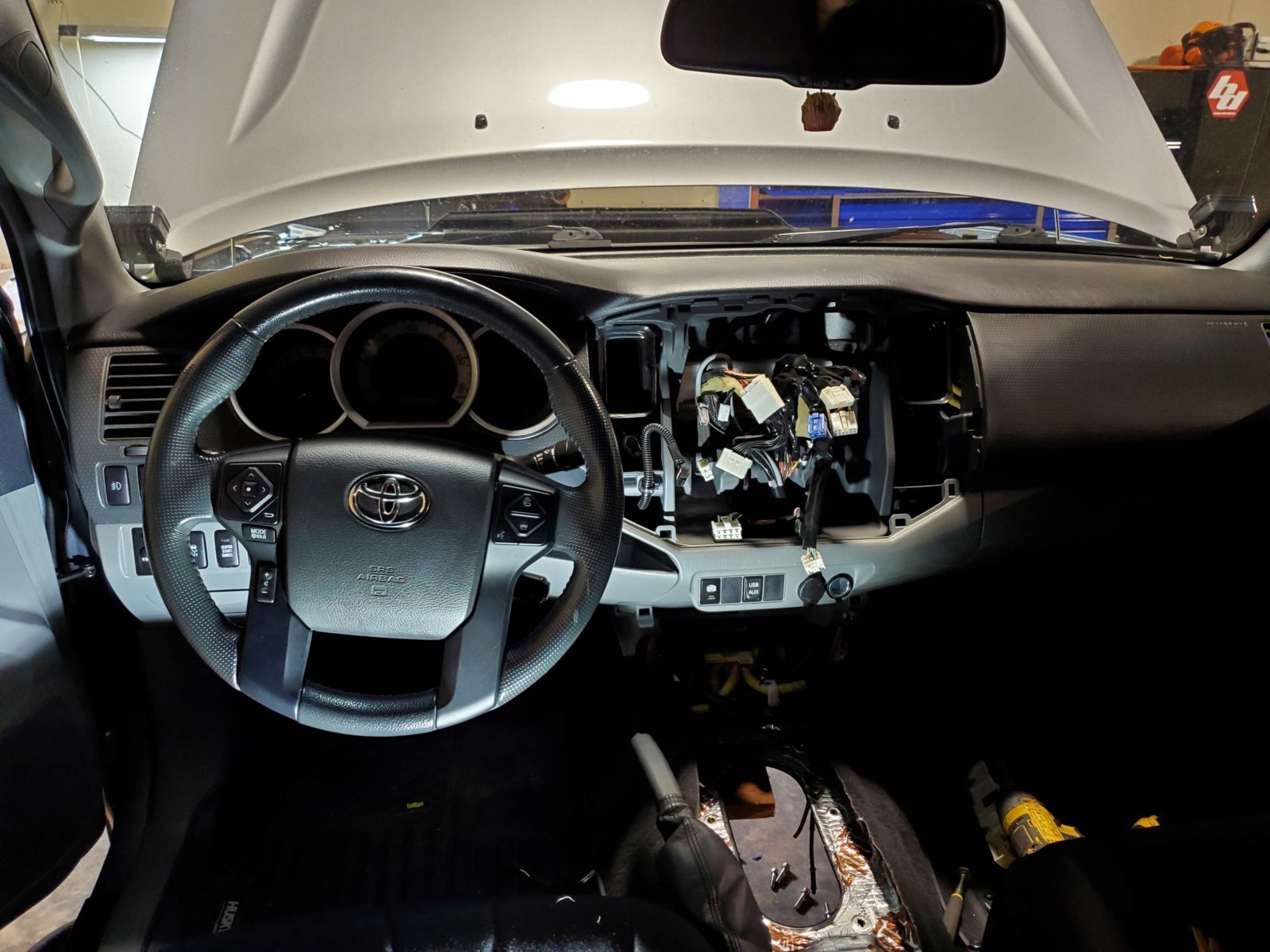

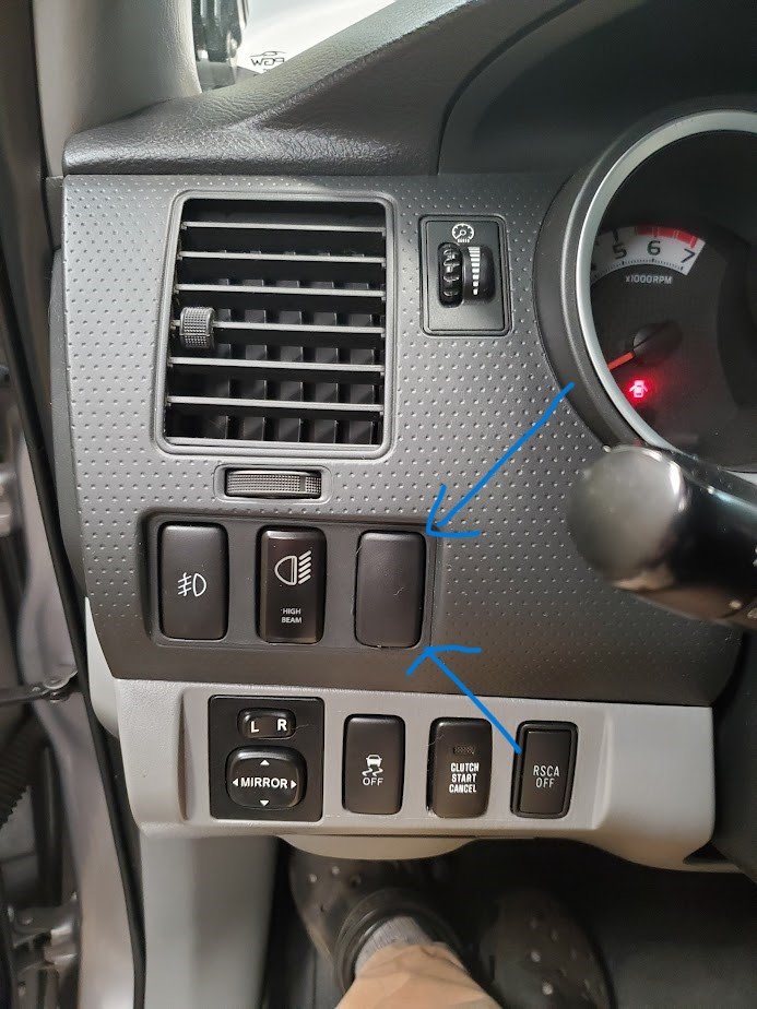

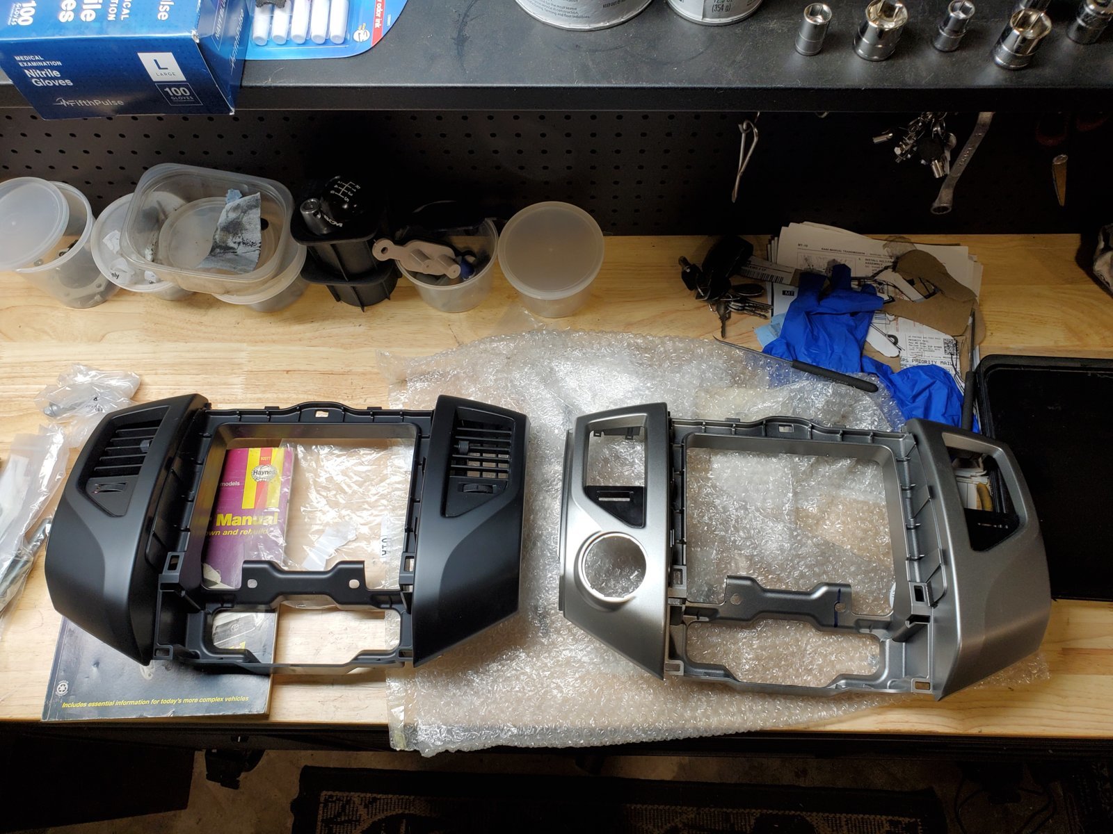

    I needed to order some Toyota hardware, including the aforementioned flywheel locating dowells/pins so thought I would check prices on some interior parts. Turns out the new parts weren't much more expensive new than they were used on ebay so figured I ought to just save some shipping and order them with the hardware.

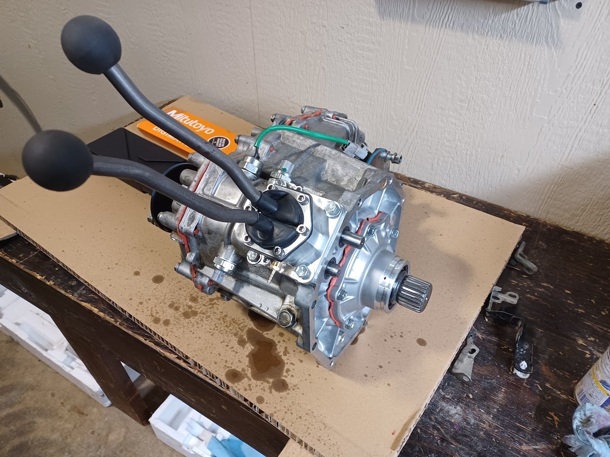

    Because of the manual t-case, I wouldn't need the 4x4 switch anymore. Changing out the center dash vent panel to a non-4x4 one was something I thought I'd get to someday when I upgraded the stereo but I was kinda itching to work on the truck this morning and finalize things so away I went.
    I always thought the silver dash trim looked funny, especially since it was just slightly off from the Silver Sky Metallic exterior paint so if I was replacing the panel anyway, thought I would try the matte black one. It's from a base 2WD/Prerunner and the part number is 55412-04100 if anyone is wondering. There are a bunch of different variations of it so that info might help someone down the line. I also ordered the matching matte black steering controls. Pretty silly and frivolous detail for the money but I am so stupidly deep at this point, what's another $100? Its part number is 84250-04040-C0.
    Chipping away at everything but now the gauge cluster trim rings and tweeter trim rings really stand out. Argh. Add painting those to the list.

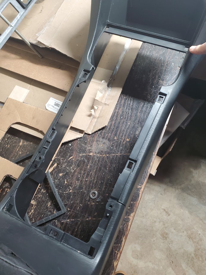

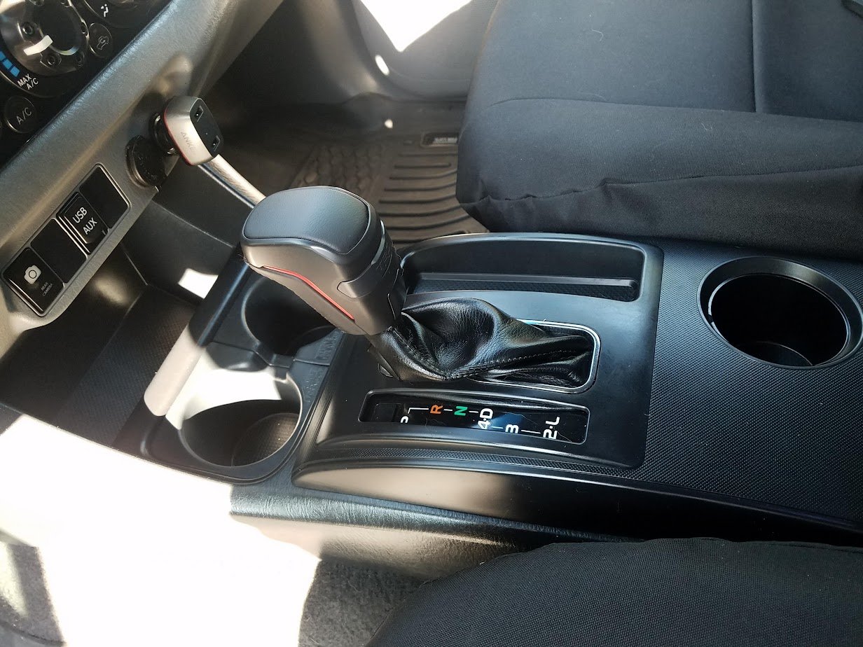

    Curious if you're going to stick with your modified auto center console or swap out for a manual one.
  7. Oct 22, 2023 at 1:02 PM
    #67
    DesertRatliff
    DesertRatliff [OP] Well-Known Member
    Jan 14, 2012
    #70618
    2,517
    Mt. Hood, OR
    Mas Tacos Por Favor

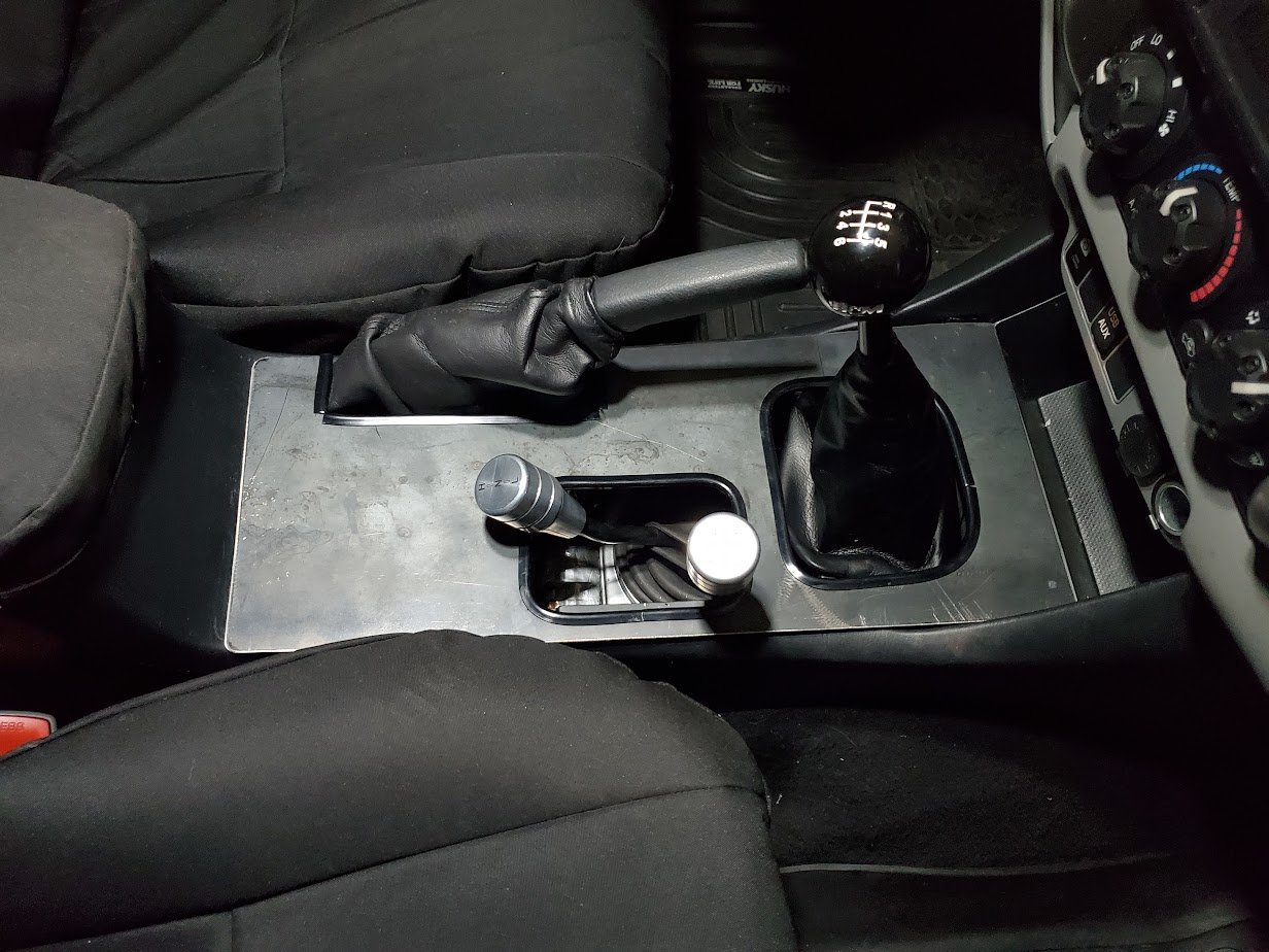

    With all the sticks poking through, including the e-brake, I quickly ruled out modifying the auto center console. It would be a complete hack job. But I followed your advice and reached out to Will at Blue Dog Designs. He seemed receptive to the idea of building me something but I'm still waiting to hear back from him if the 19" overall dimension will fit in his printer. For now, I'll stick with my sheet metal cover plate but if all else fails, I'll likely have a similar piece waterjet cut out of 3/16" ABS and affix it with rivnuts in the center console or maybe even plastic weld some bosses so I can use the yellow factory expansion clips.

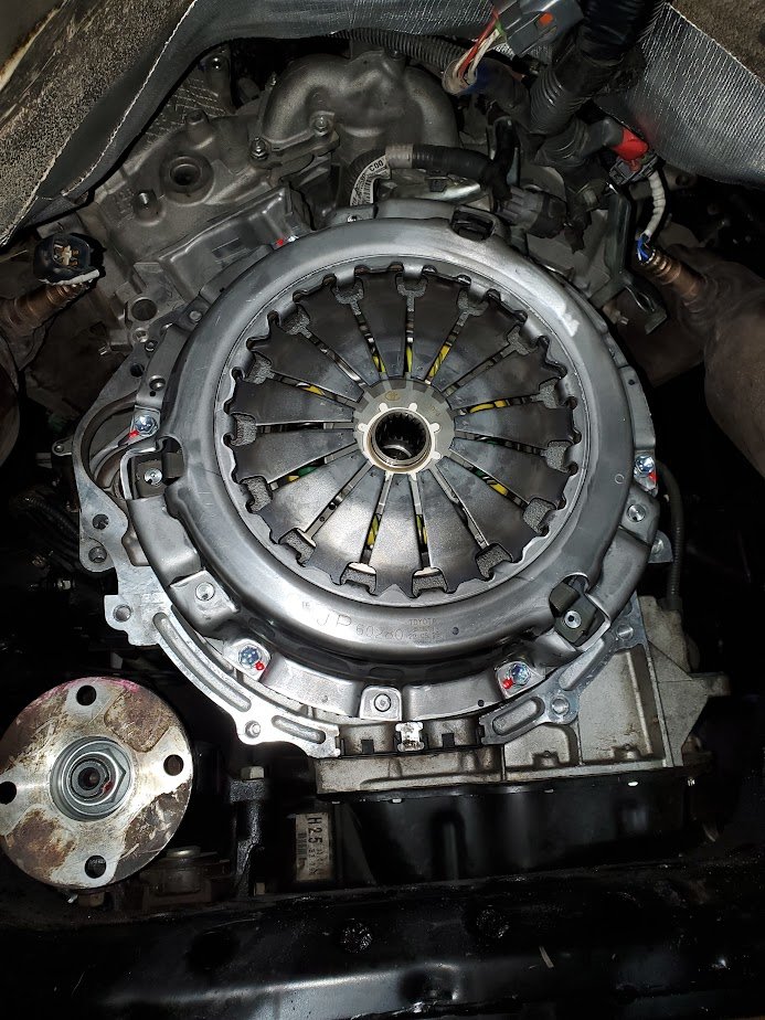

    I ended up sending the Stage 2 clutch back to Competition Clutch to have it inspected and make sure it wasn't damaged with my mess-up. They've been super helpful, ran it through their inspection process, said it was in perfect working order and will be getting the clutch back to me ASAP.
    With all that said, I ended up deciding to go with an OEM Toyota/Aisin clutch. I had almost 200k on my supercharged 1st gen on the original clutch so figured I just can't go wrong with Toyota parts. I'll use the Stage 2 at a later date or might try to sell it at a loss here.
    Here it is installed WITH locating pins! LOL!
    And the tranny tunnel with my touch-up paint. Lit by an LED shop light, the photo makes it look like a bad match, but in person it's much closer to factory. Hopefully I wont see it so soon again anyway.

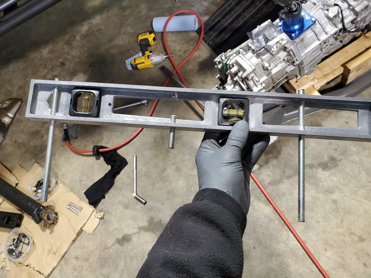

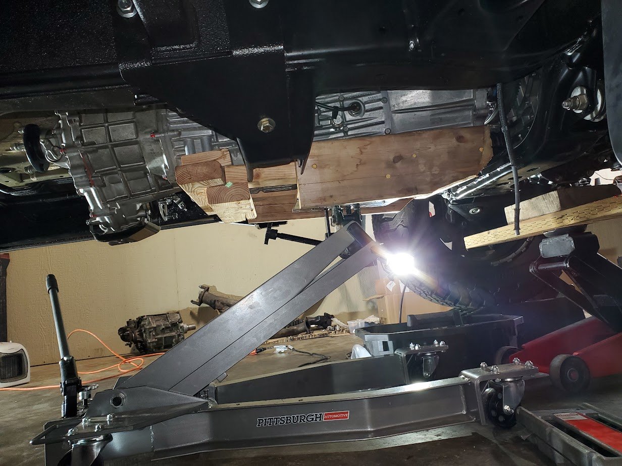

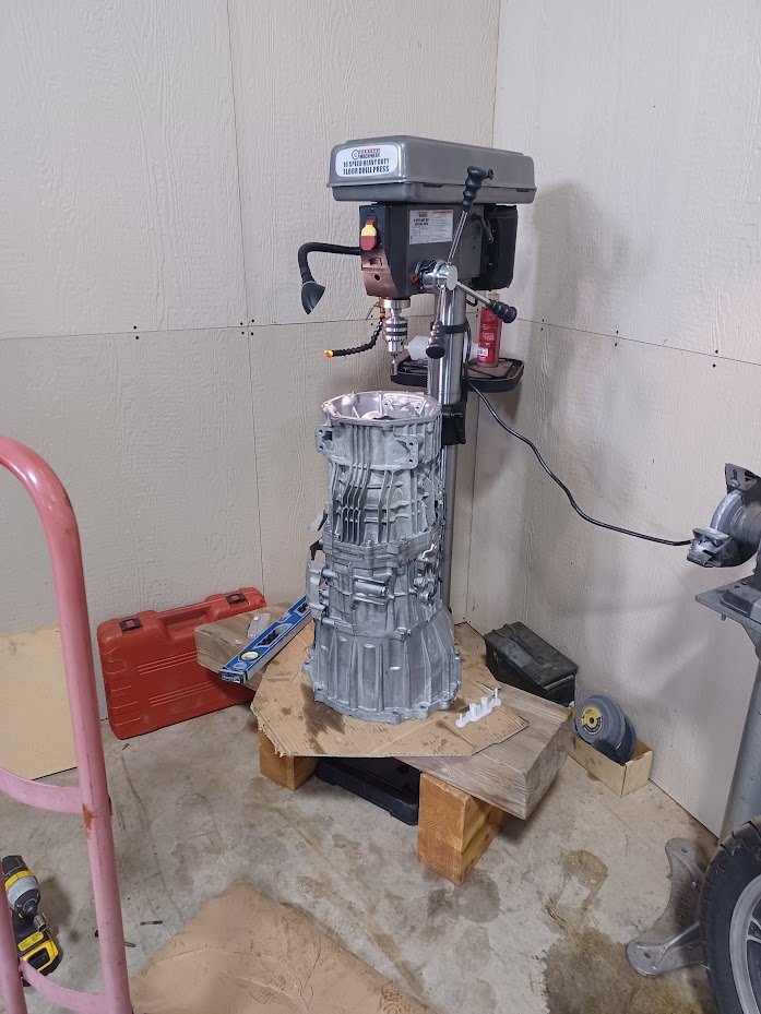

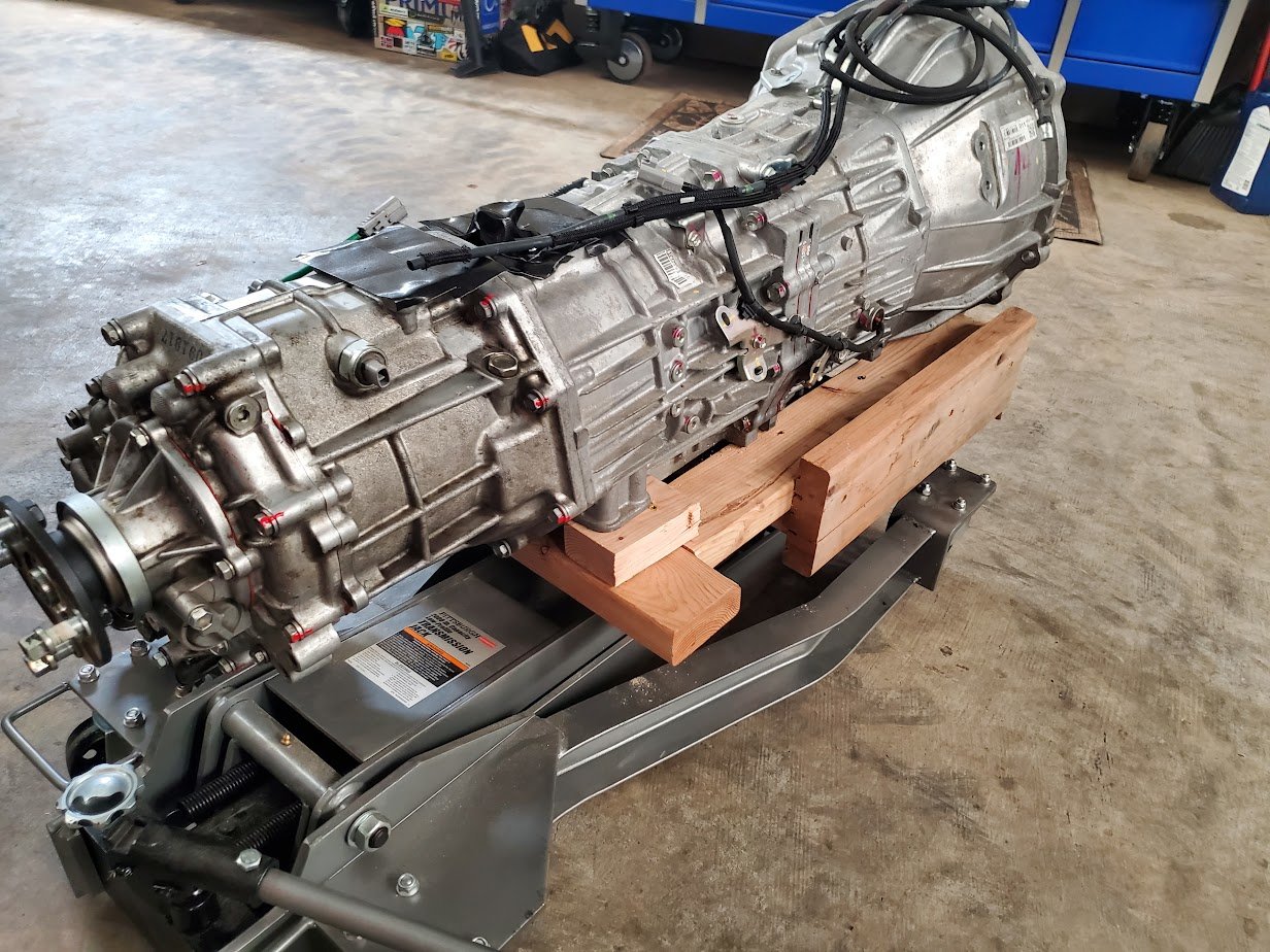

    Now time to nail the air gap again. I modified an idea I saw here and made this out of a cheap plastic level and some all-thread drilled and tapped to fit. It worked perfectly.
    Very occasionally, Harbor Freight tools work ok and their tranny jack (with a homemade cradle) helped make this a one man job.
    You can literally dial in the level of the tranny to match the motor. Definitely worth the $200.

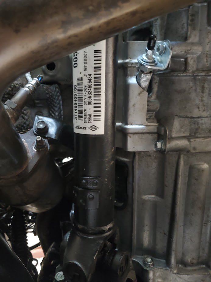

    Once the tranny was landed, I went about installing all of the other stuff. The factory clutch hard line didn't really fit right, so I got another one using another stock part number I saw listed and it didn't fit right either. Plus, I didn't love that I needed a 10mmx1.0 to -4AN adaptor to fit it to the Tilton. I searched for a company that could build me a custom line and finally found HEL. In a couple days from phone call to having it in my greasy hands, they built me a custom length stainless 3AN sized clutch line with a 10mm x 1.0 male fitting on one side and a -4AN fitting on the other so I wouldn't need to run an adaptor. Pretty slick, all for around the same cost as the factory hardline.
    Here it is mounted at the master cylinder.
    Clearancing the slave cover for the bleeder
    Factory fresh looking
    Another small detail is I wanted to extend the gearbox breathers a little higher. I found someone selling an ARB breather in the 3rd gen classified section here on TW. It was a good deal so I snagged it. I noticed that there aren't good factory spots to hard-mount anything to the firewall so I looked around at the next-highest point. I really wanted to use Kasbien's RA60 bracket he included in his origanl kit for something, too. It was too nice for it to just sit in a box in my shop so the hunt began for a good, higher location to mount everything. With the extra mounting hardware included in the Tilton kit, the bracket and hardware made for a perfect way to mount the Breather.
    And went on to the manifold strap at just the right angle, almost like it was made for it. Now all those gearboxes (and the ADD actuator) have a few extra inches to breathe if I ever go swimming.

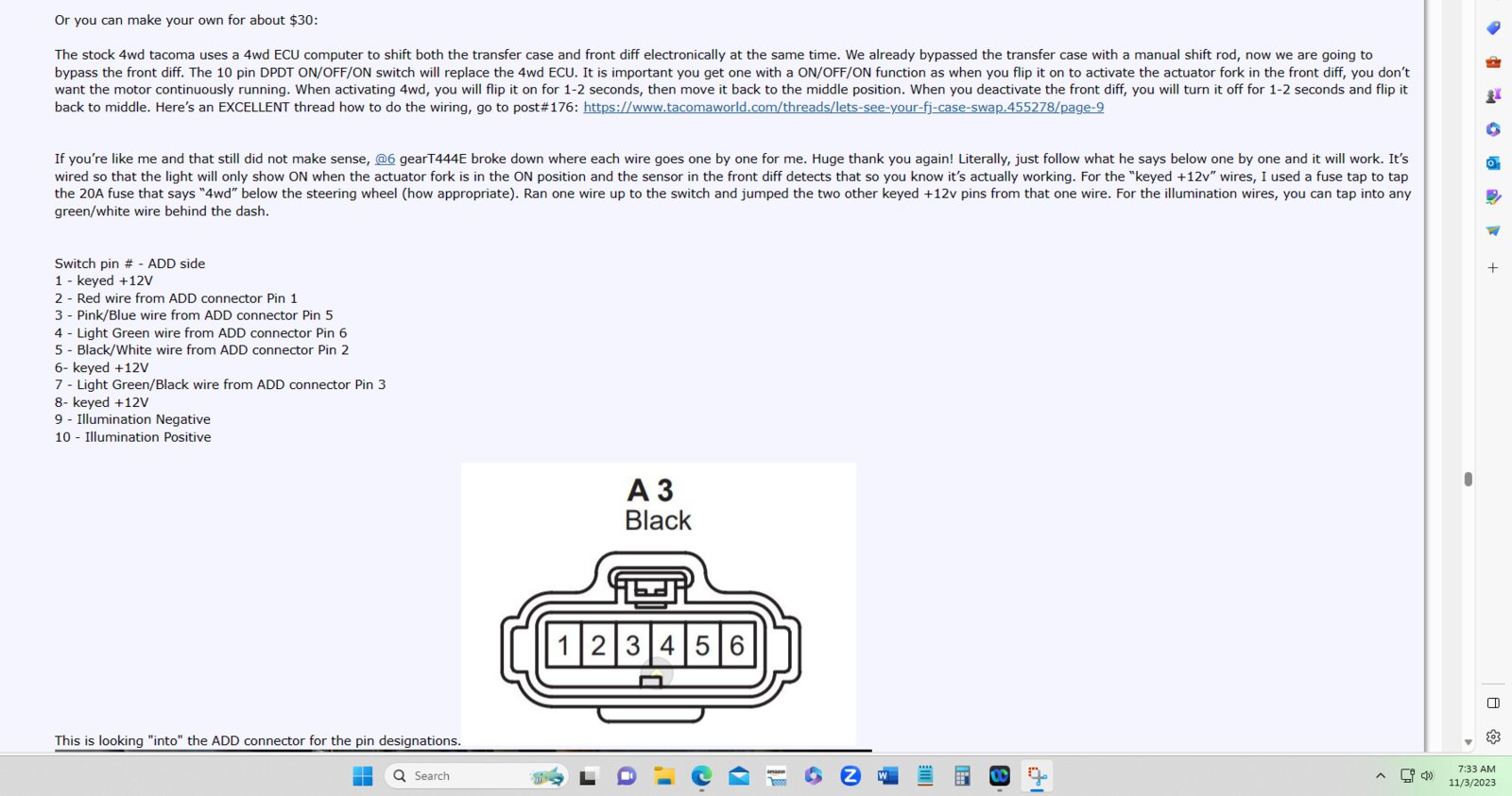

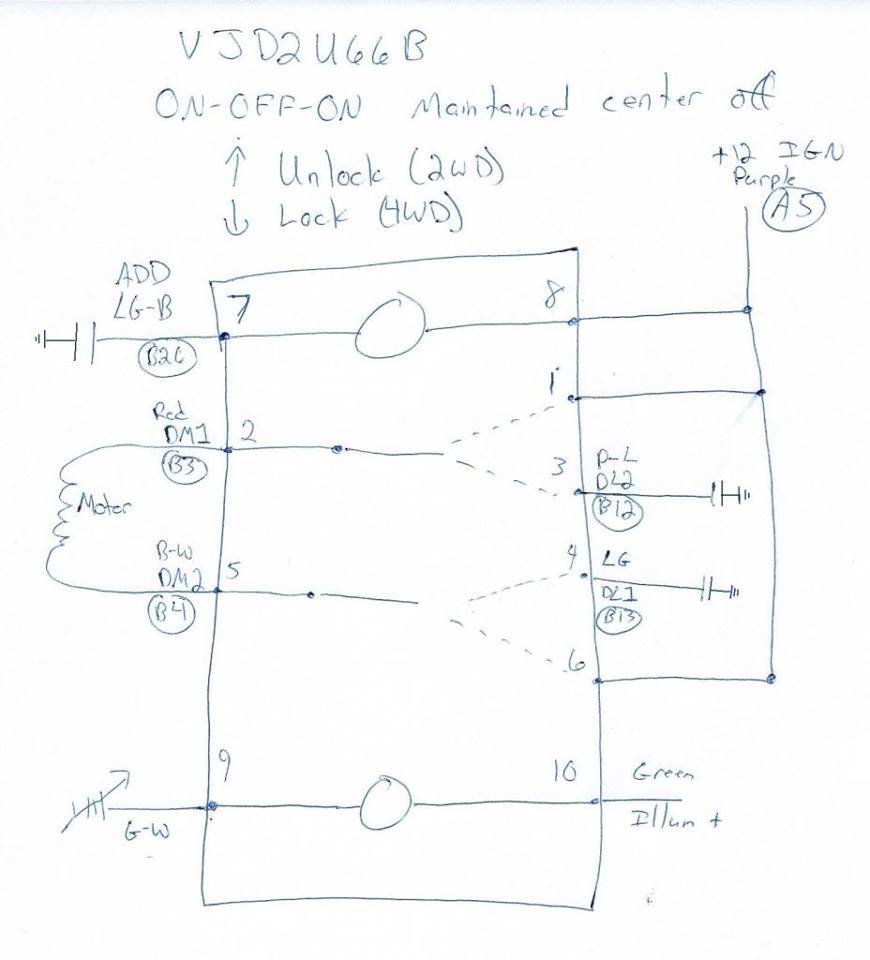

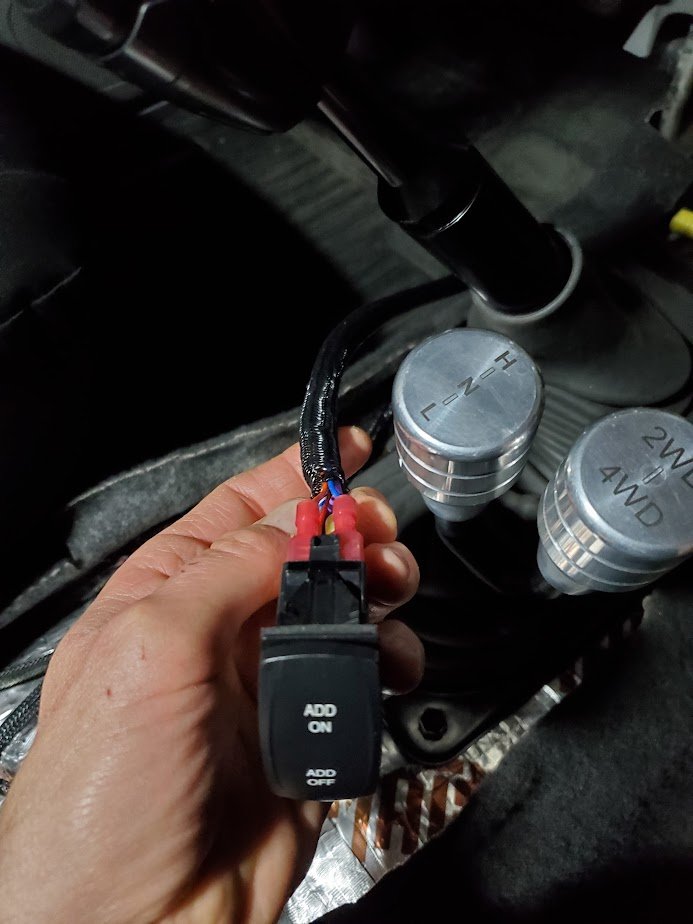

    I've kept going back and fourth on what to do with the ADD. Definitely have ADD when it comes to ADD. Sorry, I'll shut up.
    Initially, I thought I would remove the entire ADD system and use the FJ diff tube but it turns out, that's more involved than I originally thought and I figure, if I'm that deep, I may as well re-gear. But a re-gear is big $$$ and definitely waaaay beyond my yearly Tacoma budget right now. The FJ tube with a re-gear (and a Torsen diff put in the front from an 86/FR-S/BRZ) will be the long-term plan but for now, winter is fast approaching and it'd be nice to have 4WD. So time to research 6 Gear's diagrams and make a DPDT switch.
    The DPDT switch came in from OTRATTW with a custom ADD ON/ADD OFF face plate as did the order of lots of multi-colored wiring from Corsa Technic.
    Always nice to have Bailey close by for quality control.
    She approves

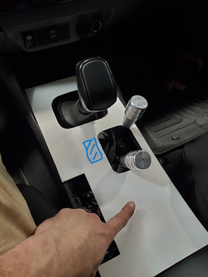

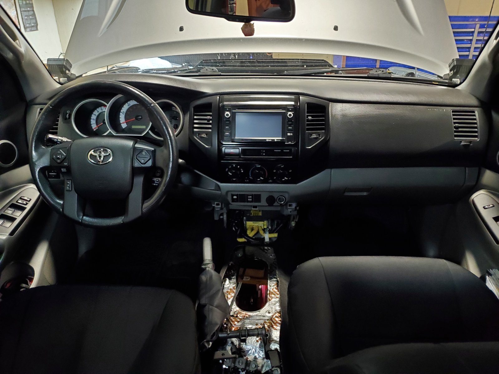

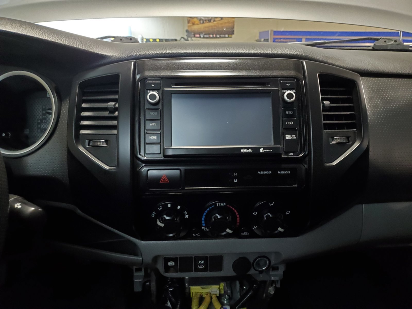

    Now to figure out where I want it. This factory location would be nice but then I'd need two hands to shift and engage the ADD.
    As it turns out, the center console is the area I ended up choosing. To get the new ADD circuit to work, you need keyed 12v for the switch and I wanted illumination for it, too, that would turn on with the headlights. All of that is easy available from the automatic tranny shifter assembly connectors that are no longer in use.
    So that made the center console location the easy choice and at this point in this build, the path of least resistance is a good thing, especially if it's simple and slick.
    But I don't want the passenger to inadvertantly push the ADD button, so I still need to sort out the exact location for it. Thinking it'll go where I have it in blue. That way it's hidden from the passenger yet still accessible with my right hand for shifting with my left hand on the wheel.

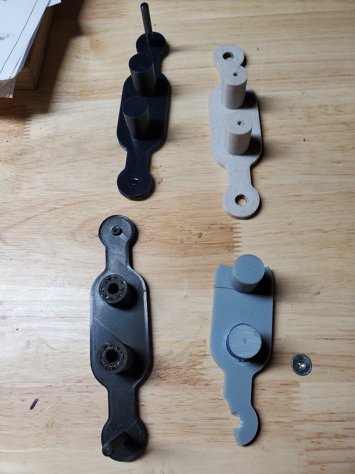

    The next step will be to send my center console to Will at Blue Dog Designs for 3D print mock up to build me a shifter face plate and have him add the spot for the ADD. Ok...no more ADD jokes.
    Happy with the results. Many thanks again to TW, @6 gearT444E and @pdaddy for all of the info here. I could not have done this without your writeups.

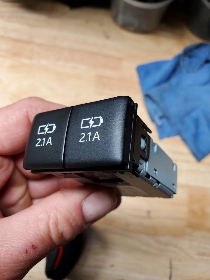

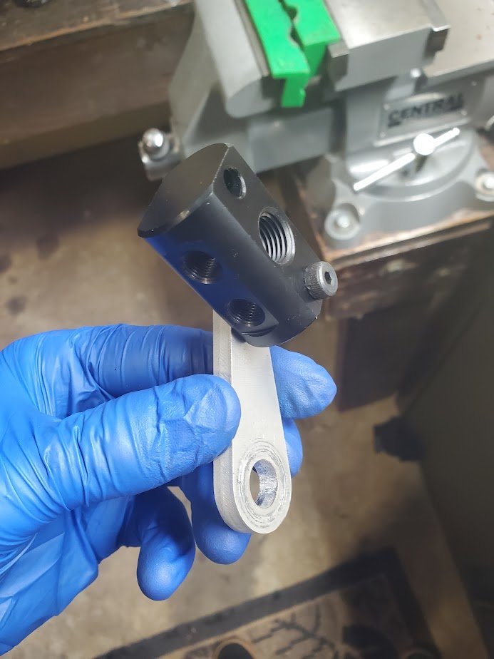

    Also had a USB charging port from a 3rd Gen that I got when I got the e-brake. Now was a good time to get that wired with keyed 12v, too, so wired it in. I'll have to figure out where it will live, but happy that the connector for it is soldiered and heat shrunk along with everything else.

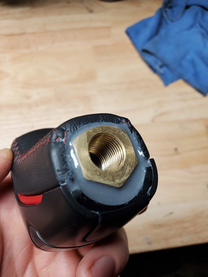

    I really like the 3RD gen TRD shifter I had on my auto shifter. I even made a shift boot for it at some point in the past.
    And I'm not in love with the B&M ball shifter but found the B&M shifter's thread pitch of 9/16-18 is pretty uncommon and, because of that, there aren't a bunch of shifters available for it. So I ended up drilling out the TRD shifter, epoxying a slightly modified brass NPT air fitting in to the bottom, drilling and tapping that to 9/16-18 and Bob's your uncle, I've got a TRD shifter for my 6-speed.

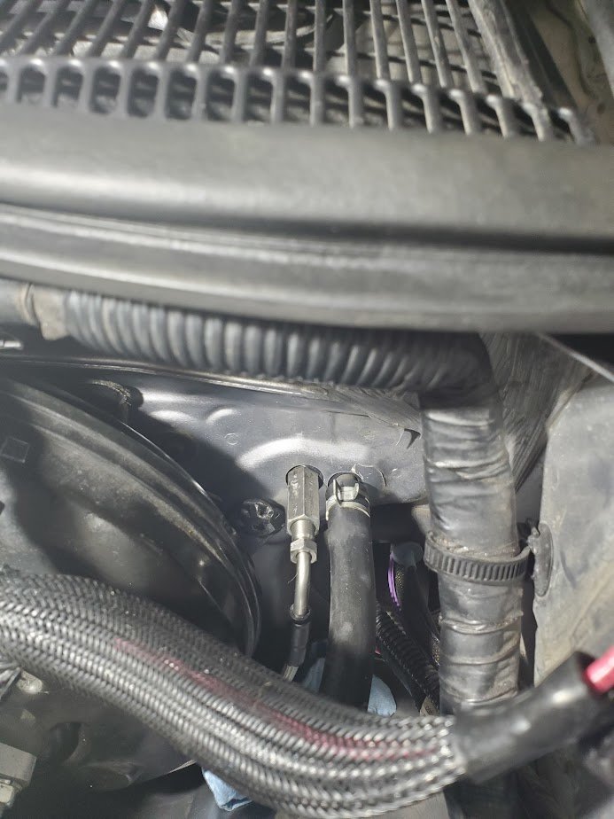

    I want to mention that I had one issue with bleeding the HRB in case this info helps anyone in the future.

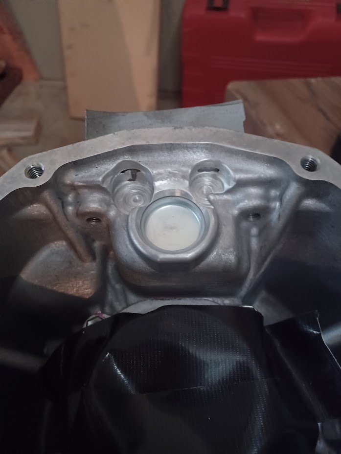

    With the tranny at its home, I checked the inspection window and was pleased I had ~3mm of air gap, so I proceeded to put everything back together from there. The pedal stop was set from my previous install. I never really had time to set pedal freeplay during this time but for this, I didn't mess with where it was from previous.
    Tranny home and everything else installed, I set out to bleed the system with help from my wife, but she kept telling me the pedal felt soft and wouldn't return back "out". We pushed and bled a pint of DOT 4 through the system but still no avail. Having just done this a few weeks ago during my first install (the HRB bled super-easily in about 2 pumps), I thought all of this was peculiar. So, I went about checking my work and in doing so, pulled the inspection window on the tranny. Horrified, my 3mm air gap had disappeared and the bearing was sitting flush on the clutch diaphragm springs! Dang it! I thought maybe pedal freeplay was the culprit so I disengaged the MC from the pedal with no change. I opened the bleed port hoping the HRB would return to 3mm out but it did not.
    So I ended up calling Tilton support and had a super-informative conversation with Jeff there. He told me that once the air gap is set and the piston has some fluid in it and is pumped once, the piston moves to the bearing and it doesn't return to its bore.
    He also gave me some more bleeding tips and basically said not to depress the clutch all the way to the stop at first, only to where it begins to engage the diaphragm spring, and only then to open the bleed port and press the pedal all the way. My wife was going from fully open to fully depressed on the pedal and apparently, it's harder to get a good bleed, or not at all, that way.
    With pedal freeplay set a little further out, pedal stop location tweaked a bit with the different clutch and following his tips, I finally got a good bleed on the system and have a pretty normal pedal feel (although the throw from the Tilton with the FJ master cylinder is quite short).
    Hope this helps somebody in the future!

    Genius idea with the level. Share it with the main thread! Also it's just a bracket lol. I wouldn't care if joined the other members of your local scrap bin.

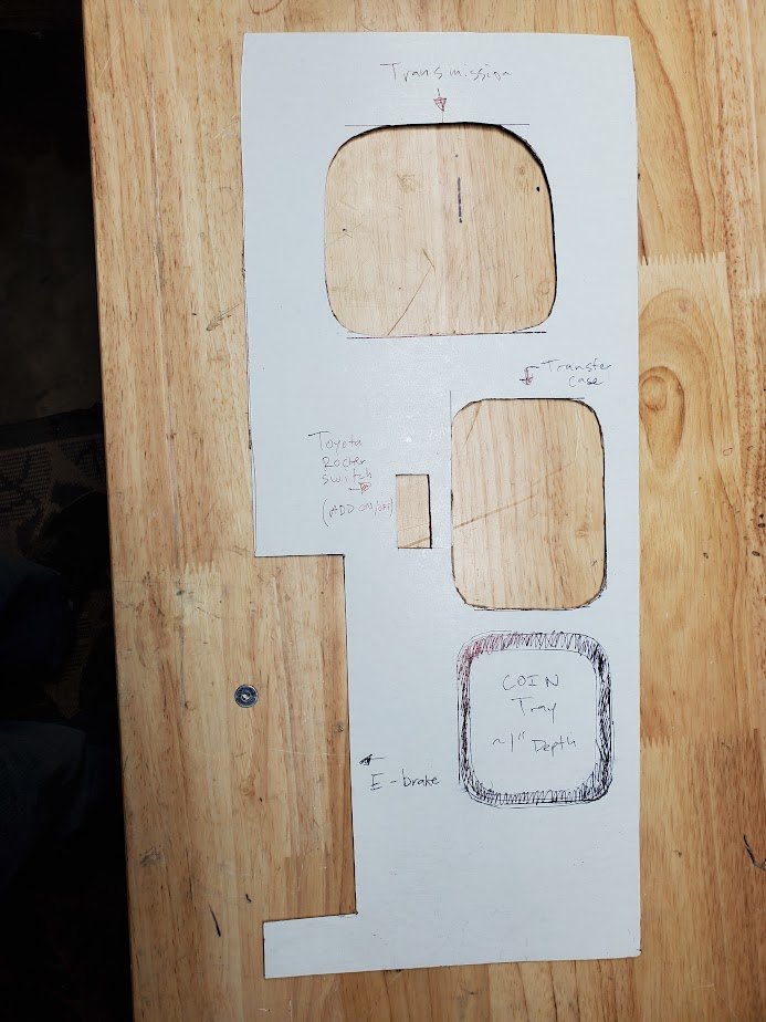

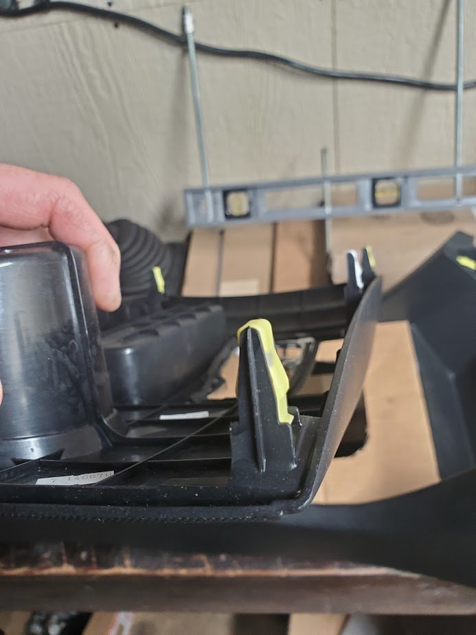

    More arts and crafts. This is the final layout and final template that I thought I was going to mail to Will at Blue Dog Designs, along with both big parts of my center console that he wanted for mock-up. It was a big, rather heavy box and shipping it to him a few miles north up I-5 was going to cost about $50. Hmm...that's 500 miles of fuel money in my little DD Beater.
    I was farting around here on Tacoma World, as you do, and popped on to the Oregon Craigslist thread. That thread is awesome but must get 20 new posts a day. I've had to turn off notifications from Tacoma World because of it. It's too much. My settings are such, too, that when you don't check a thread once after getting a notification, it unsubscribes you. Long story short, I hadn't been on that thread for a few weeks and randomly popped in on a rainy Sunday afternoon. As it turns out, someone in Seattle area was giving away...not selling cheaply but actually giving away...some OME BP-51 coilovers. If I got the story right, they were terribly squeaky from Mag Chloride exposure and needed new lower ends but were not leaking and in altogether decent shape. The owner had been out of Tacomas for a while and just wanted these out of his garage. I re-read his post 20 times, shrugged my shoulders and called dibs.
    Monday was supposed to be rainy again, not good for farm work, and my winter job doesn't start til next week, so why not make a little road trip up to Seattle? I could combine trips and drop off my center console to Will in Maple Valley. If the coilover deal was in fact real, I figured I could just drop them off at ARB USA in Auburn for a rebuild, too.
    Long story short (again), there was an actual human (a very generous and friendly one) who showed up to the arranged meeting spot in NW Seattle and gave me 4 giant boxes of Toyota stuff. BP-51's in good shape, a case of Royal Purple 5w-30, a bunch of YZZD3 filters, spark plugs and new factory front end hardware, all, in fact free. It was like Christmas morning. I still can't believe my good fortune.

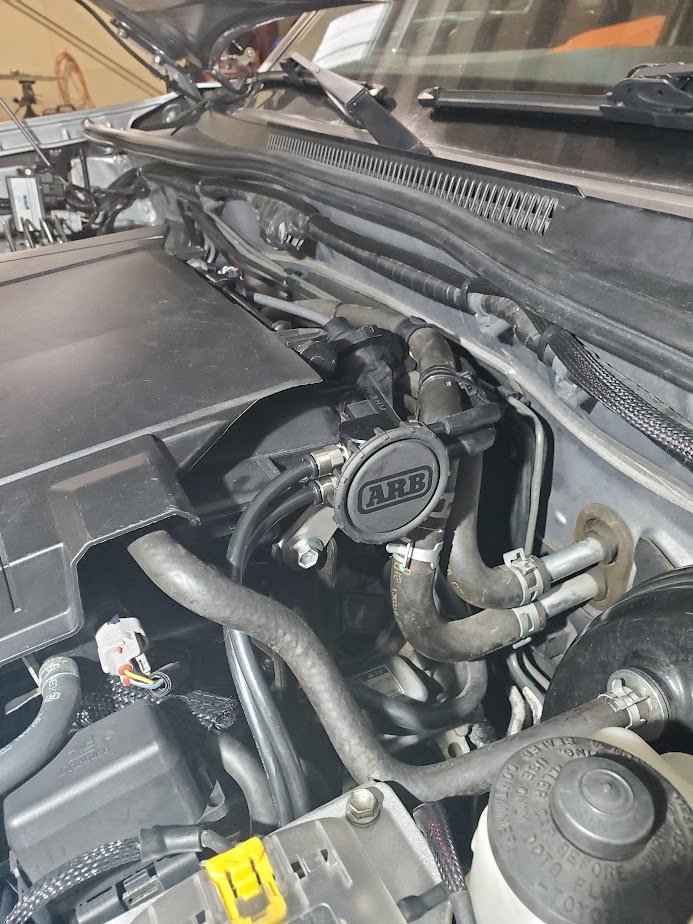

    ARB USA tech support wasn't super friendly or helpful (rainy, cold Monday AM after daylight savings. Who could blame them?) and said since the gear isn't leaking, they don't need a rebuild. I asked if I could stop by and purchase new lower ends and he said their facility isn't set-up for retail but did give me the part numbers I needed. Not a complete waste of anyone's time so I won't even call that part a swing and a miss.
    Since I can't persuade my wife to get rid of her 2006 DCSB, the BP-51's will get new lower ends and hardware and all the parts will go on her truck as the start to a really nice, really cheap front end re-fresh.
    With a huge grin on my face, it was time to bomb over to Maple Valley and find Blue Dog Designs. Even though I emailed him the night before to let him know my plan, Will was a little surprised to see me on his home doorstep holding a big box filled with Tacoma interior parts.
    Hopefully he can knock out a factory looking center console bezel easily enough and have it back to me soon to finally wrap up this chapter of my build.

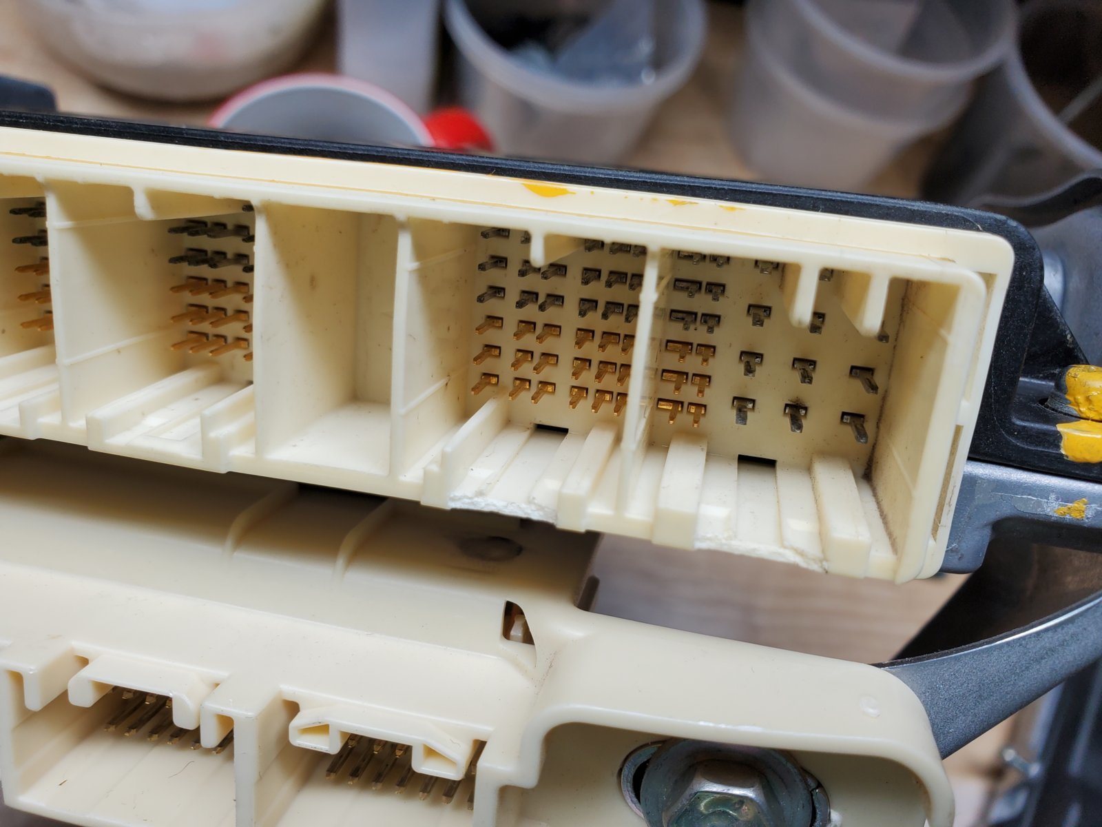

    Update and a little more info that might be helpful for the next person taking this on:
    Truck shifts awesome! I'm really, really happy about the swap but...
    A few weeks ago, I reached out to Justin at OTT to tune out the auto transmission functions on my ECM through HP Tuners. He sent me a tune that I flashed and all the check engine/VSC/trac lights disappeared with the exception of the A/T Temp light. "I'll sort that out later" I thought and took the truck for a few shakedown rides. I was stoked! The truck was so fun to drive and finally felt "right".

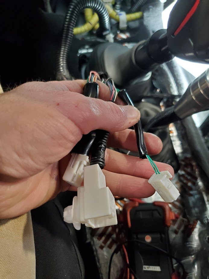

    The only real issues I was having, other than the A/T Temp light flashing, was a high idle speed (1300-1700RPM) even after warmup. Additionally, there was a delay or lag between shifts. When clutch was depressed/throttle released, gear selected, clutch pedal released and gas pedal re-pressed, there was a noticeable lag until the power came back on. It didn't feel like I was in full power mode, either. After the fueling delay, it felt like full power would come on for a fraction of second and then drop off again. I monitored timing via my Scan Gauge and the ECM was definitely pulling timing to go in to some limp mode. Additionally, the throttle felt notchy right at the point where you first touch the pedal. I reached back out to Justin about these issues but he told me there wasn't a way to adjust for any of this stuff through HP Tuners alone. Dang.
    Re-reading manual tranny swaps here, it appears the only way around all of this is with a manual tranny ECU/ECM. So I'm on the hunt for a cheap ECM from a 2013-2014 manual trans 4x4 Tacoma PN: 89661-04G80 or 04G81 if anyone reading has a lead. Thanks!
    Last of all, Cruise Control isn't working. While I was reading and re-reading through some posts trying to figure out the fueling issue, I stumbled on SparkyIX's post here about the Cruise Control:
    "Well final update on this swap, I officially got the cruise control working.
    Ign power to pin 1 of the upper clutch switch, and pin 2 ran down to the PCM Connector E9 Pin 27.
    After a brief test drive, all is working as it should be."
    Looks like I just need to jump a few more wires when I find and plug in a new ECM. I'll keep my fingers crossed nothing changed from 2009 to 2014 in regards to the Cruise Control and give it a shot. Thanks Sparky!
