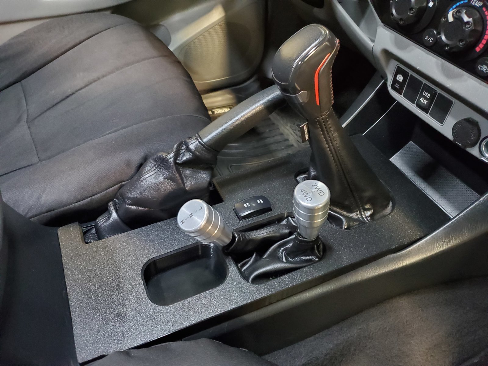

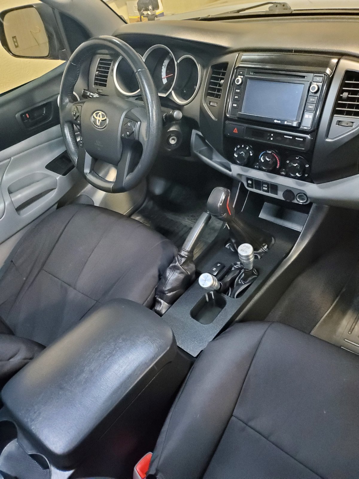

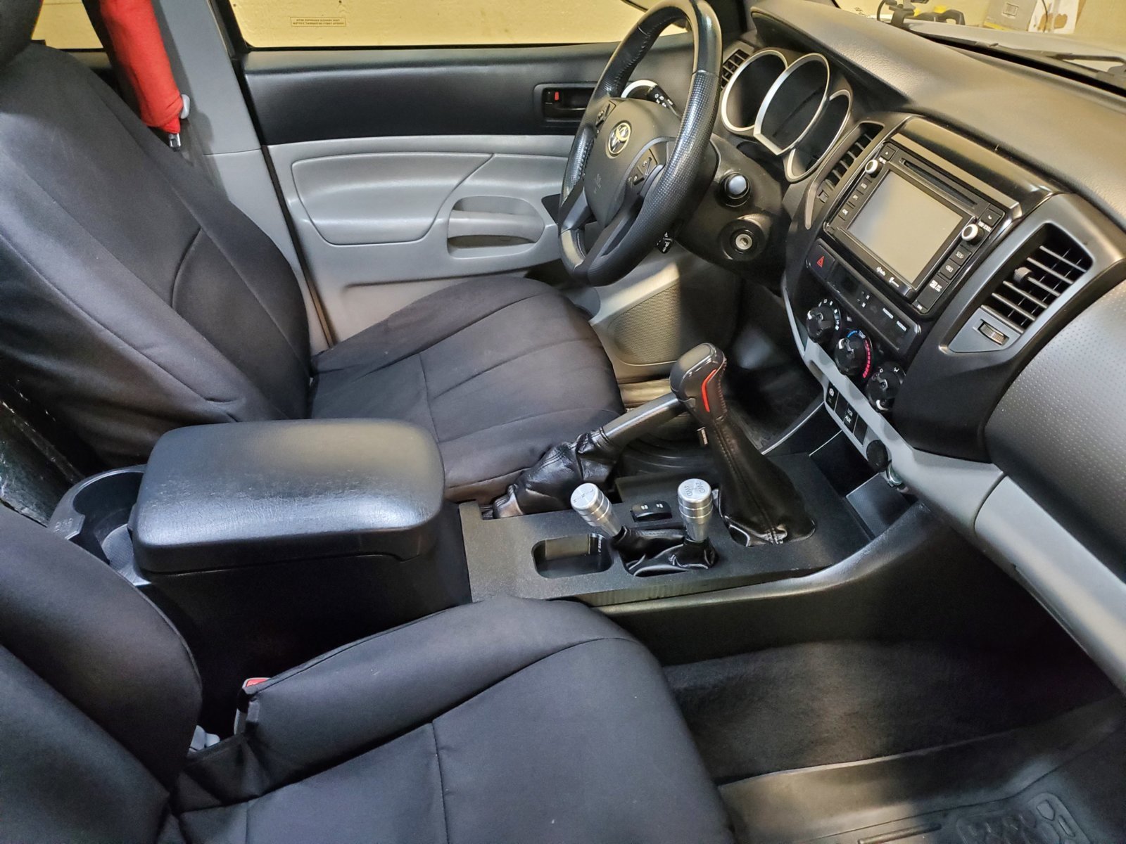

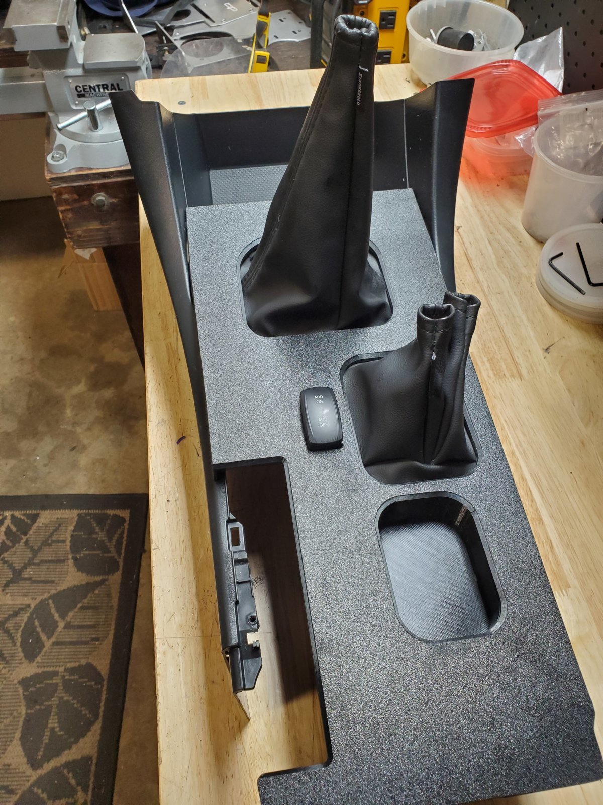

    Got a couple more pics wrapping things up today.
    Shifter boots need some modding. Thanks Mom!
    And getting them permanently mounted using some stainless rod welded up to some stainless washers and plastic epoxy for the studs.
    Test fitting.
    And complete
