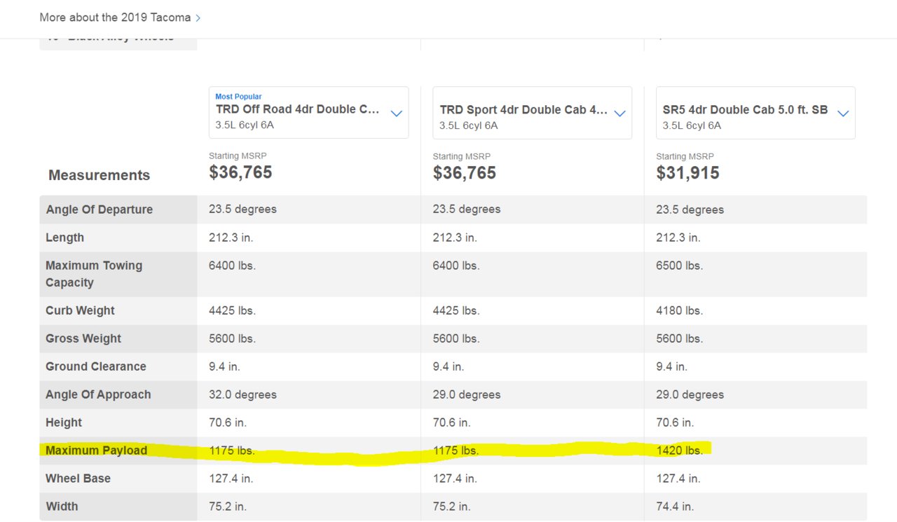

    That seems really low. This is what I found for the 2019 DC.
    mrtonyd likes this.

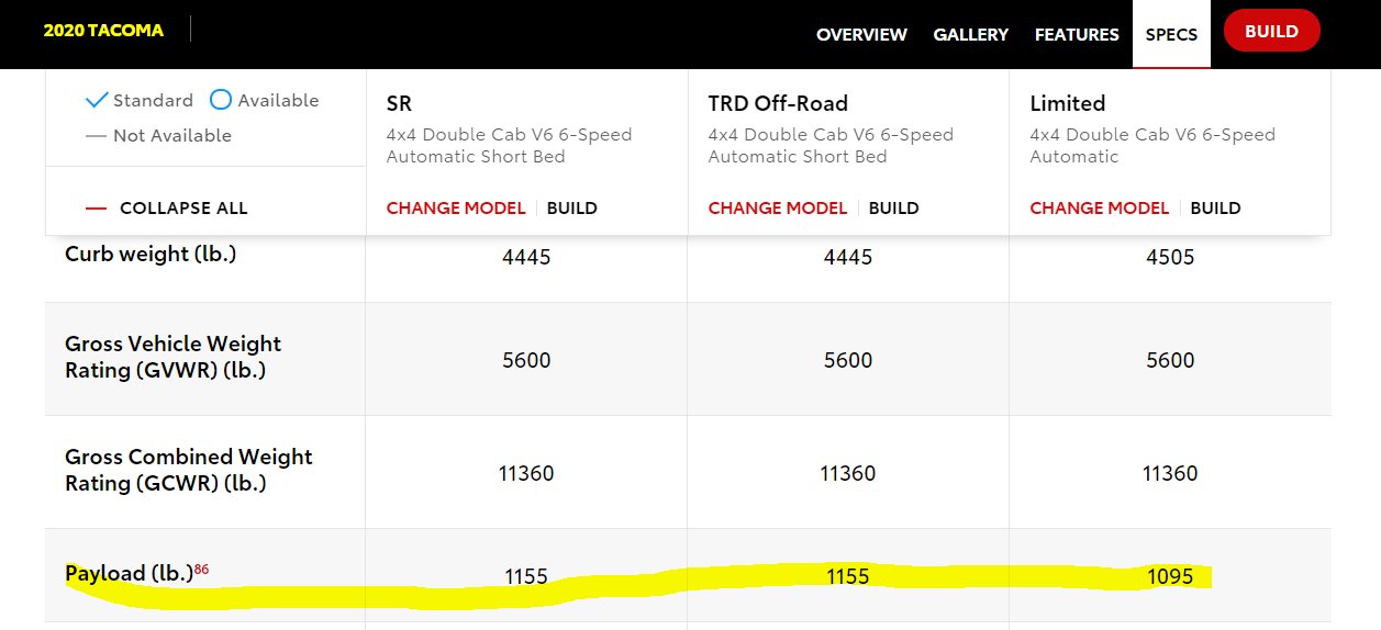

  5. Nov 18, 2019 at 8:16 PM
    Area51Runner
    Area51Runner Well-Known Member
    Jun 26, 2014
    #132748
    11,983
    Northern California, Bay Area
    02 3.4 DC TRD PreRunner 4WD SWAP
  6. Nov 18, 2019 at 8:32 PM

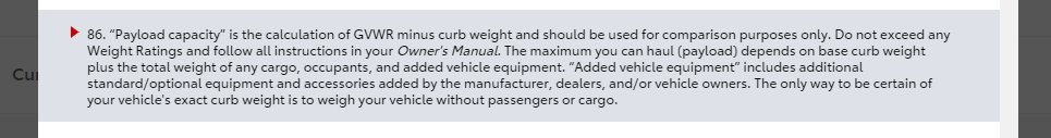

    I think you missed the point, he made the assumption he was good for 1100+lbs (probably found the same stats you did) but actual on the truck stats say something different.
    That little "86" subnote basically says, these numbers aren't real, check your shit yourself to know what your payload is :D

    @calebc - Like many, I never clicked on "Excuse 86" until now.

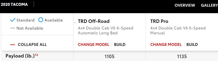

    That said, I went out to the toyota.com website and did a comparison between the 2020 trd DBLB and a Pro. Exactly what @Area51Runner did in a previous post, but this one is specific to the DCLB. The stated payload is 1105 lbs, as seen below.
    I would love it if someone who has a 2020 TRD Offroad DCLB or a PRO posted a shot of their door sticker. I would love to see the real values.
