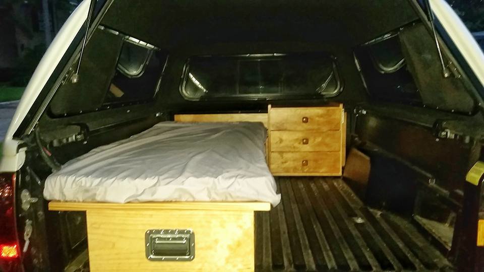

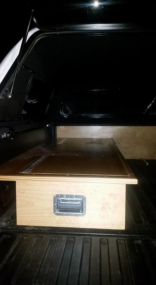

    Needed a handle for the 4ft drawer but it needed to be low profile. found a roadie box handle that is spring loaded to keep it down. started to chisel out the pocket... ended up making a jig to get the router in there without blowing out the pocket. a little over 3/8" deep, fits like a glove.
    13620897_1921246108101950_14183663783229_3affcce66a1028db18e04f34caaad15777bffd6b.jpg

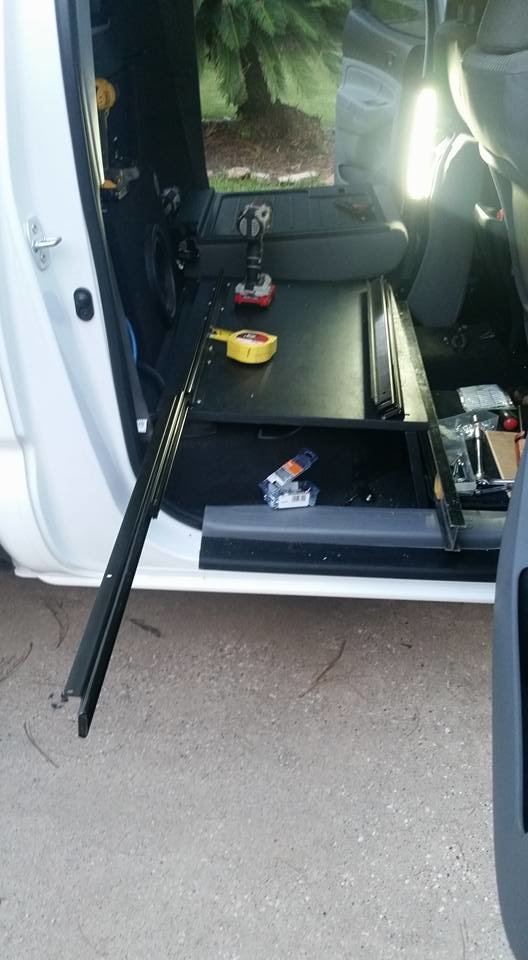

    the whole project should be wrapped up by July 22nd provided the slides for the fridge do not take long to arrive

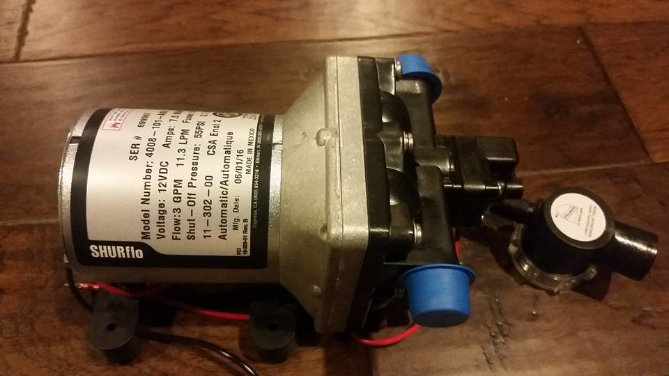

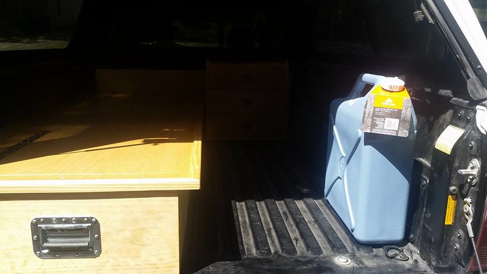

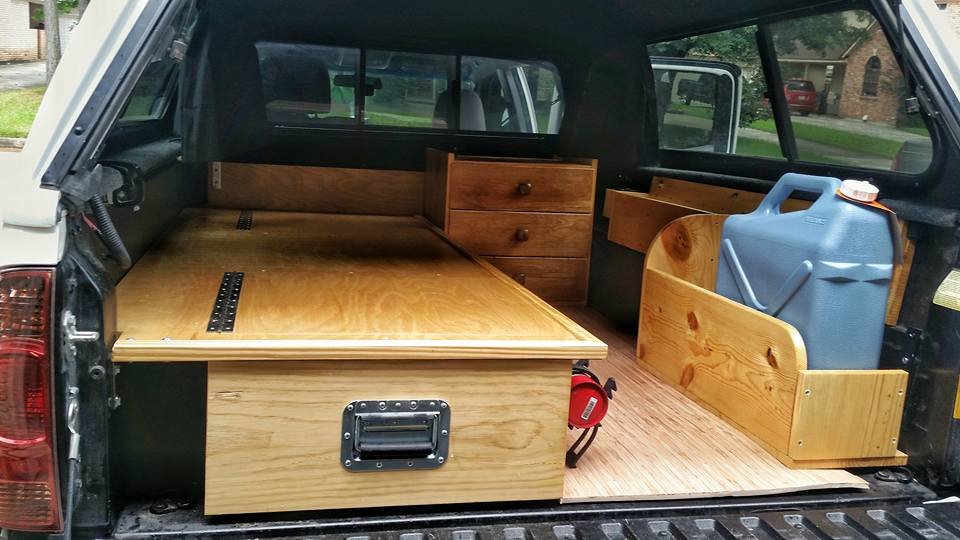

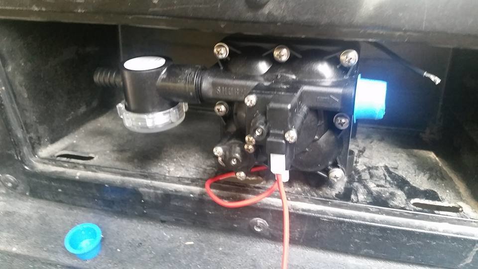

    Figuring out my onboard water setup, ended up with a 6 gallon jug, it should be enough for a few showers in the boonies when im not around a public shower or just bathe in the river.
    The water pump and strainer will fit in the little storage cubby with less than 1" sticking out which is fine.
    13590249_1921702288056332_53488040516187_5babceff1b1cb4fb57fe5f1dec7c540743617c23.jpg
    13567301_1922018294691398_89387061992445_54a66654444cf80ddba4e290cb6544c16e31c22d.jpg

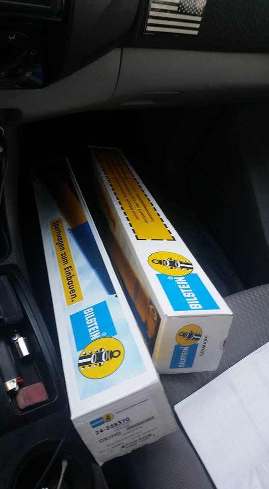

    Picked up the front 5100s which will be set at 1.75"
    13654258_1922126011347293_59476261491712_a090d28b4d9b746bd10d5bedc394ad7f0f58cf33.jpg

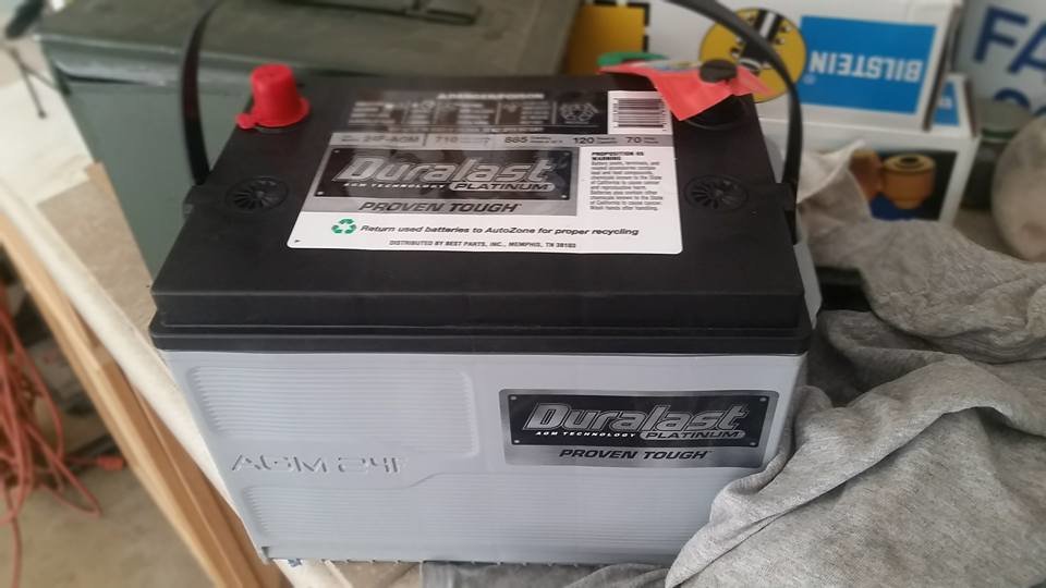

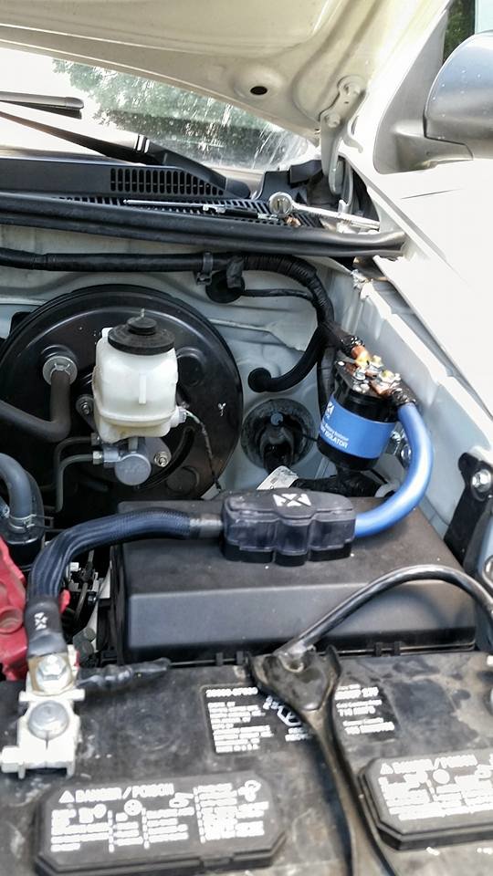

    Picked up a Duralast Group 24 AGM for the second battery
    13754353_1925492274344000_42737269099378_2cc24d69bbd70eaffca77844304d0ed77e4b9f23.jpg
    Got the isolator mounted up and the 0/1ga cut and routed to fit neatly. just need to attach it to ground and an ignition source now.
    13700142_1926413627585198_53157728845714_8f40755a54314d7f1930e41acaf7f10307fad754.jpg

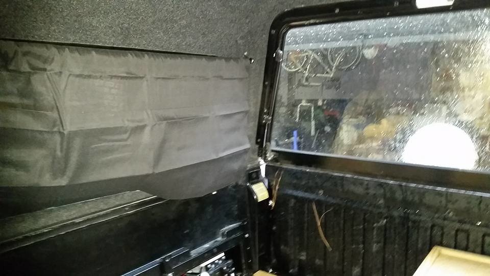

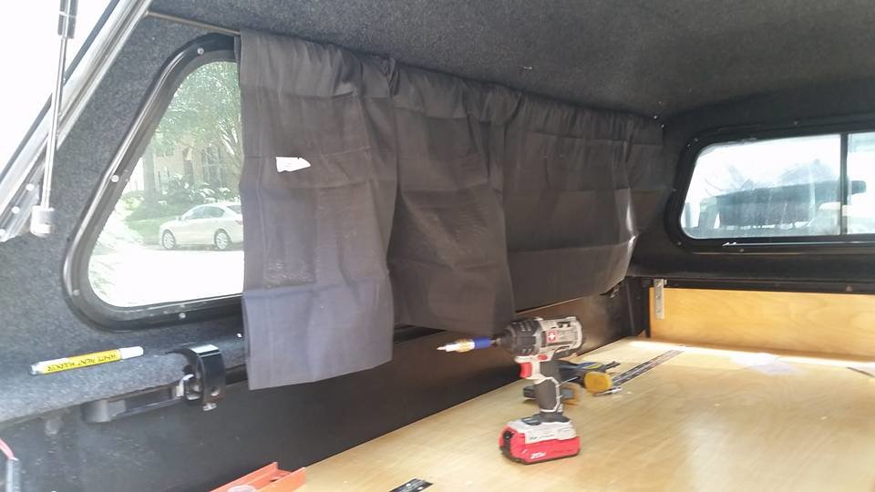

    Got curtains mounted... Never judge the thickness of the shell when screwing into the fiberglass... poked through the outside with the very tip top of the screws. Shit happens, worse things could happen, ill build low profile fiberglass pods and mount some flood lights in there and bolt it down to cover the holes and provide some area lighting when camped.
    13754367_1926448067581754_42977400060737_950ab13612df0d2a07208a998cc3472003591b3a.jpg
    13770309_1926469470912947_37149089480022_02dc6ec594b44a1ac7677bdc294b3820c95aaa05.jpg

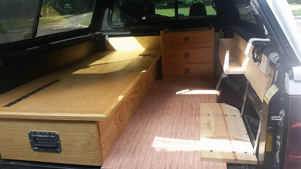

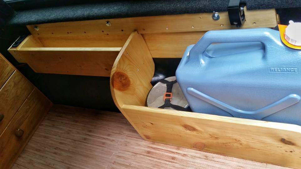

    Water jug/pots & pans storage, and a spice rack/cutting board knife storage box over the wheel well.
    13754208_1925335087693052_41727152716099_c112b7a78694c1388ecf0db3333bd9bab9abd5aa.jpg

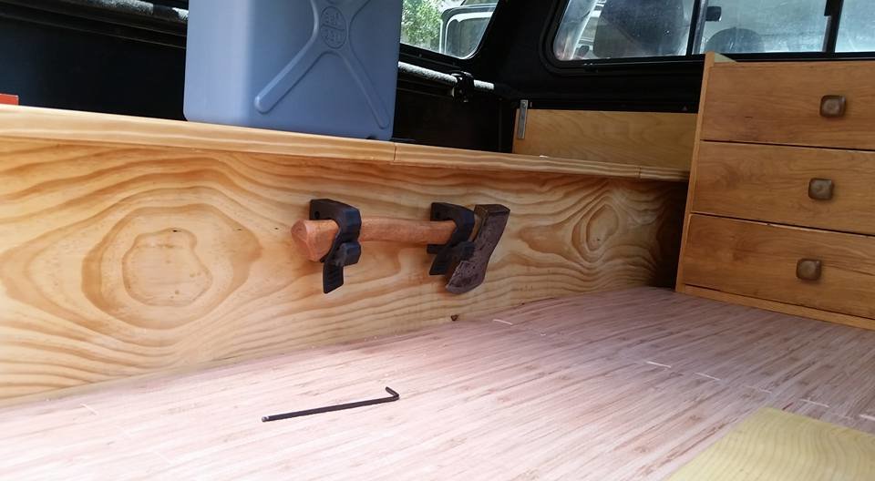

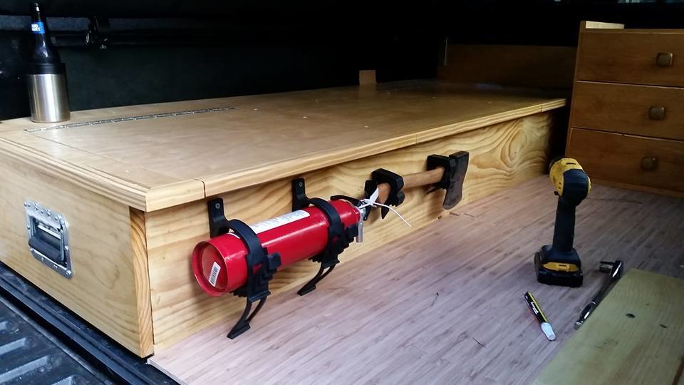

    My Grandpa gave me this US Army hatchet when i was 8 yrs old.The hatchet head is stamped with the year 1945 and the location it was made, that part is now fadded. It was painted olive drab but i wanted a cleaner look and needed to clean the blade edge anyways. I then sanded all the paint off, took the blade to belt sander to reshape the blade and get a nice beveled edge. Then stained the handle and finished it off with a sharpening stone, it is Extremely sharp now. Mounted on the side of the bed with quick grips
    13770473_1926418614251366_88354814151019_81f8b1f49b115fa41d40f2c06feafa7837f41209.jpg
    Also mounted an ABC Fire Extinguisher for safety.

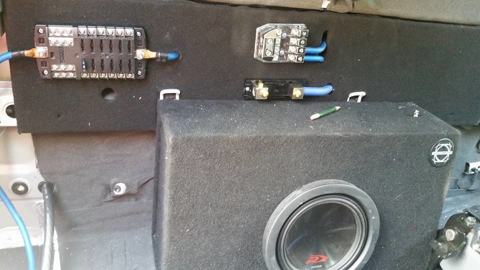

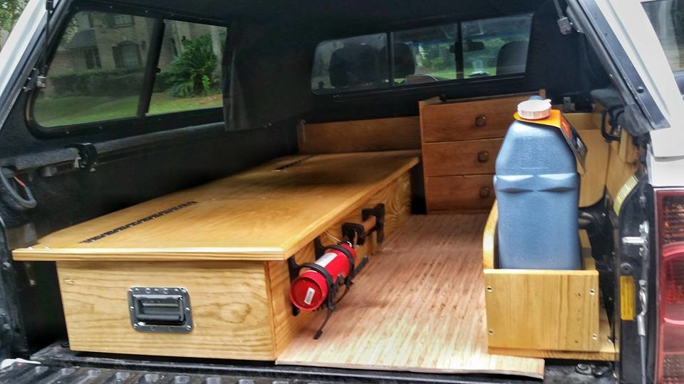

    Finished the build out in the bed today, Only need to connect the wires to the fuse block in the cab once it gets mounted.
    A little plumbing to do from the water jug to the pump and find some sort of nozzle sprayer and the shower setup is done too.
    I wired up two 4ft sections of white and red LED strips for each side of the camper shell, gluing them to strips of velcro and sticking them to the roof for an easy attactment.
    13754341_1926965617529999_17607910566846_2e46d1fbbf170d03bf71d48f7b54081cb3ba6a3d.jpg
    13707688_1926965637529997_90998100606275_a20175926f9a12b9b00d7fd8fba3008cc8cf53ab.jpg
    13710057_1926965604196667_82757665637085_a1f62931a1977a9e79ae1ecf2be2f3c95041e833.jpg
    13770441_1926965577530003_17011915475276_011643e43f3a91e17e64909f15390576a643aaba.jpg

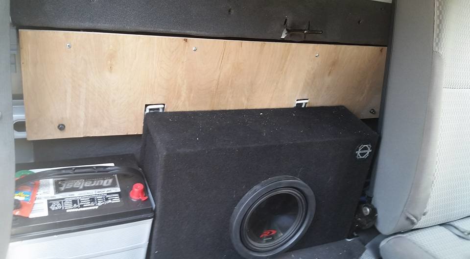

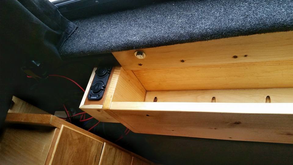

    Its a tight fit but the battery and sub box fit against the back wall, the wood will be covered with black carpet and the blue sea fuse block, fuse for the dual battery setup, and distribution block for the larger power cables
    13709941_1926938990865995_63788149792056_b8da4baad0817636e2bcc516f42431706d2d5983.jpg

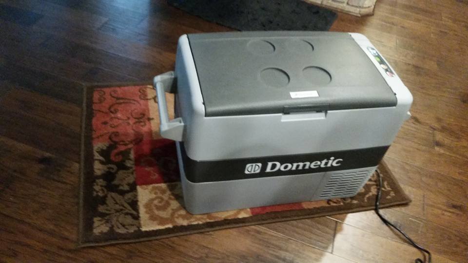

    The edgestar that i got for free because it wasnt cooling that i added leak sealer coolant to it and had it working bit the dust (Anyone in Houston, if you want to try to fix a non cooling 63qt edgestar, its yours for FREE just need to pick it up by this friday the 22nd).
    Luckily PPL RV/Motorhomes had a Dometic 52qt in stock so i shot down there and picked one up.
    13726611_1927500574143170_35941981449671_49a61811f8e931b47adaee0a4feab6b19a5231b2.jpg

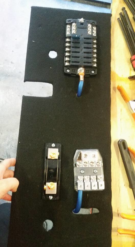

    yes i know the one fuse block is crooked, i fixed it a bit but i am not going to fuss over a few degrees.
    13754462_1927806737445887_46944420834269_148e7e6101e9ff2b32b13fa2ab4696bcf9ba5261.jpg

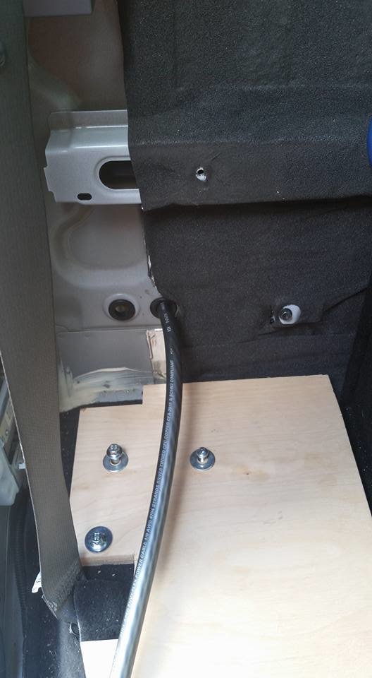

    0/1ga negative battery cable that bolts down to the frame just outside the cab.
    13697137_1927865934106634_33202483442976_6e637e2294e8407db3d8af247649aaef58b875ec.jpg

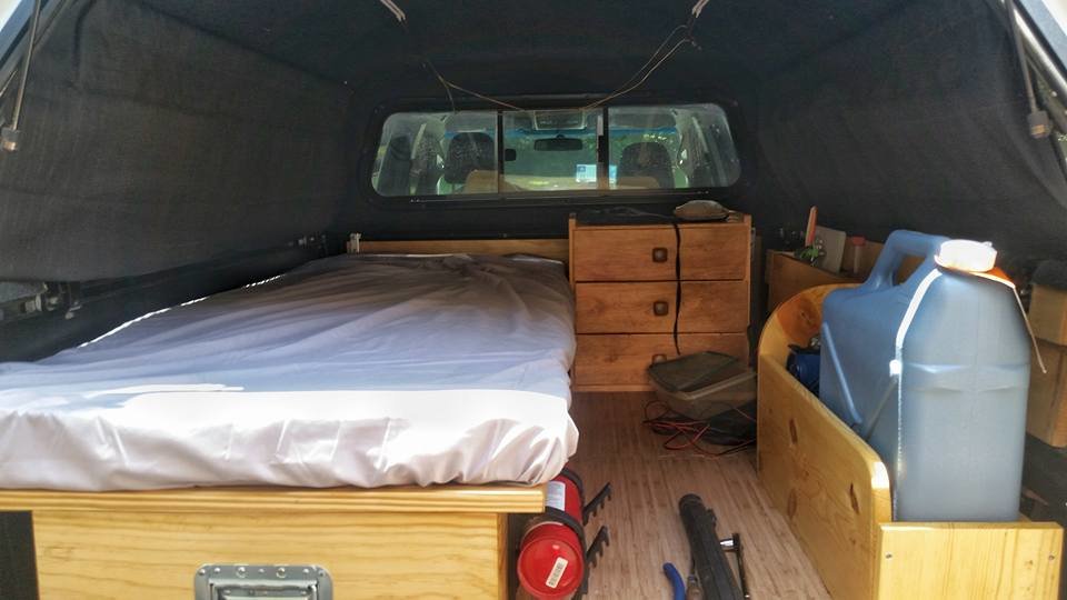

    Mattress installed and looking a bit more like home. there is my very first blue foam egg crate bed roll from when i first started camping with my dad with Indian Guides( father son "tribes" that go camping together... this was before Boy Scouts) underneath the memory foam and my short backpacking bed roll under that. it is very comfortable.
    13692458_1927917950768099_85220893869554_e49928c9ca8d586c8248c58204be8519b06f9ed0.jpg

    Have the fridge slide base platform painted and bolted in, got the one slide installed, thought we had all the screws but were 12 screws short to finish the whole slide platform and the hardware store was closed when we realized it.
    The top part where the fridge sits got wrapped in black felt as well for a nice clean look.
    13769359_1928047030755191_78249401392504_7cbd0429f0ab6a4b578ef9ddd7d782474a807cd5.jpg

    really cool build, definitely going to follow. It's a sleeper in more ways than one. I like that it looks inconspicuous and stock from the outside.
    Don't know if you're finished with your LED lighting in the canopy, but i did something very similar. two strips along the inside with velcro as you have, but then, on a separate switch, i also put a strip along the lower inside edge of the rear canopy door. That way, with it opened up, you can switch it on, and it illuminates the tailgate perfectly for cooking or working on stuff or whatever. Just a thought anyway! my wife loves it!
    also, if you hadn't thought of it already, you can cut small slits in the canopy carpeting, and fish the wires through it to clean up the look.
    EricU[OP] likes this.
  20. Jul 20, 2016 at 9:02 PM
    #40
    EricU
    EricU [OP] Well-Known Member
    Feb 4, 2015
    #147859
    484
    Englewood, CO
    I may have to re splice some wires to get it under the shell carpteting, much better idea than i had planned ha
    ChadsPride and WormSquirts like this.
