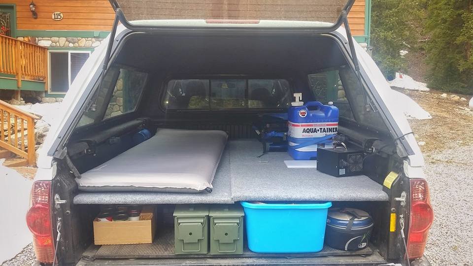

    Slide platform mounted.
    13775354_1928402624052965_65026767422294_010f9f0f385bba5ea3f02d2d996be1d59d199f51.jpg

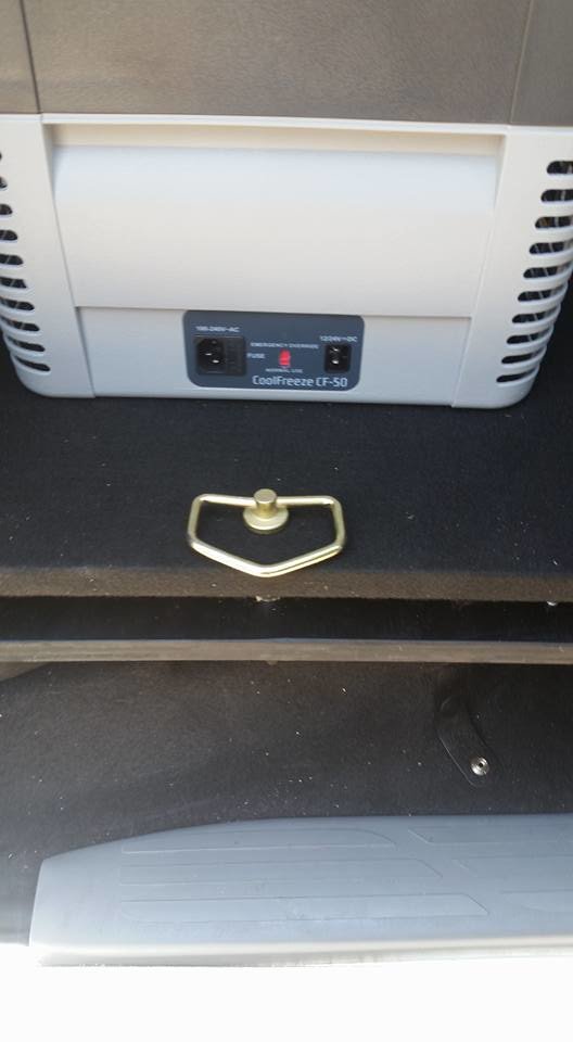

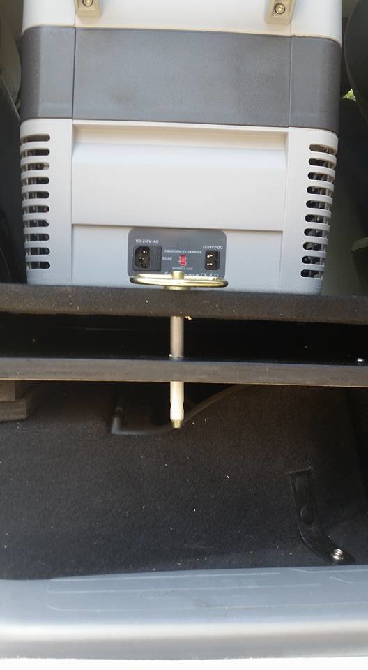

    Fridge test fit, and a hitch pin to keep the slide from moving while driving
    13731697_1928451187381442_71306235588002_5cbd96705de43a27c803a5e6c4f2fb5bda86a177.jpg
    13731475_1928445904048637_69283006112963_19d9379ac38ccc99b9fa6e7ee489b773868b9736.jpg
    13690614_1928445937381967_48643136324701_6f610d5207aa8e70840ba6ae55c06596cecd5d57.jpg

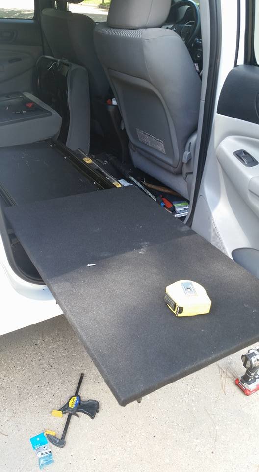

    Made a board to cover the open space below the platform, much cleaner look
    13775593_1928460630713831_75953462778009_cf2cc3502d546d3ec83ad76cf9c45df893a94a7a.jpg

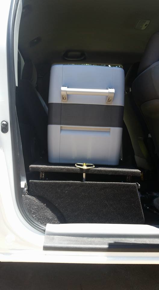

    easy access to the fridge from the single rear seat. perfect spot for a beer bitch... or access to popsicles ha
    13729147_1928438917382669_23491175285587_cb0c833e50de27058295c22dd6c60909fd05298c.jpg

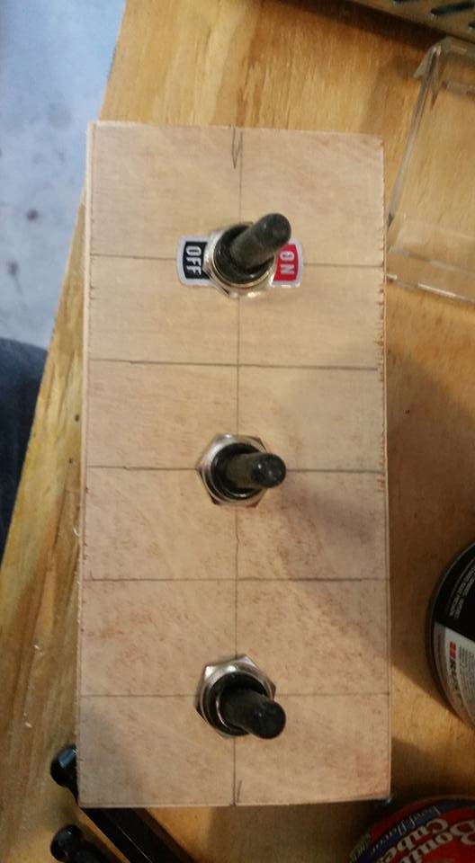

    making a switch box for the LEDs, and water pump. The box they will sit in is going to be wrapped in black felt as well.
    13716091_1928353867391174_11037705109145_73632c417889440dc9c61519ad86d91adc7efe1e.jpg

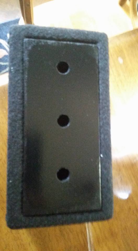

    Switch box wrapped and still drying.. stupid texas humidity
    13754231_1928521147374446_44493093757964_d6e0830338f4afcb6a1093286d35279b88089057.jpg

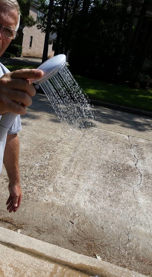

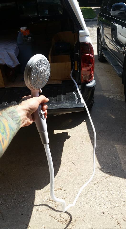

    and the shower head on an 8 ft hose. 5 settings on the shower, with on/off switch
    13770271_1928512074042020_76937801232731_74baadc1d0d5640392e05e6f4f2a46d5e595fece.jpg
    finishing all the wiring of the switches this evening once it cools off a bit and plumbing the water pump into the jug. The end is near.

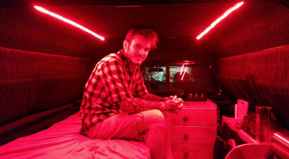

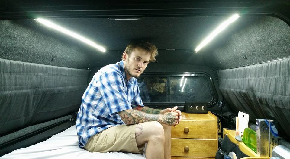

    Pitch black out tonight in the driveway, gave the LED interior lights a test... these strip LED's surprised the hell out of me.
    13775618_1929106987315862_45633927418188_c0897fae1caf6cd395948e620b24956a4a556f88.jpg
    13710015_1929107000649194_33619152795317_083b37a862e9de12473d8e1af1b9c1076f276c78.jpg
    Going to eventually put a strip across the back window so it will light up camp and the tail gate even more, i just need to order the water proof kind this time.
    everything is wired up now. But i will end up rewiring things as I do want to get the proper size wire for everything later as im WAY over sized for most of the components and its bulky.
    Easy_rider, Large, Chipskip and 5 others like this.

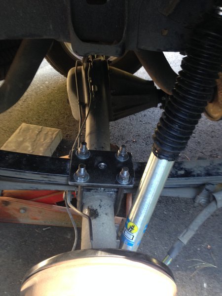

    Went ahead and pulled the trigger on the rear suspension from @allpro , Expedition leafs, 5125's, Ubolt flip, F&R brake lines, timberens.. the leafs are out of stock so there is a short wait on those, but it will be worth it in the end.
    Ordering some Built Right UCA's tomorrow and ill be set.

    Went ahead and pulled the trigger on some OME 886 coils for my 5100s, I figure this will handle the added weight a bit more when the truck starts bouncing around off road. Especially when i add on skid plates next year, because after these suspension upgrades and new tires around November, I will be tapped out of truck funds and back to saving for other things.
    Sway bar will be removed when the lift goes on so if anyone needs stock suspension, i will have stock base model coil assembly, stock 2+1 leafs and base model black shocks as well as the TRD Bilstiens which i had from another tacoma. would sell it all extra cheap (im in colorado)
