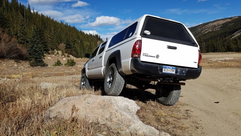

    Back home in leadville. Got gas and other supplies and headed up the mountain to see how it rides off road... no more wheel hop on the smallest bumps! The front is stiff as expected but im hoping will soften uo slightly or a winch bumper goes up for sale locally for a steal of a price.
    No idea if ive hit the timbrens yet, but off road the rear suspension stays planted and i dont even notice the weight any more

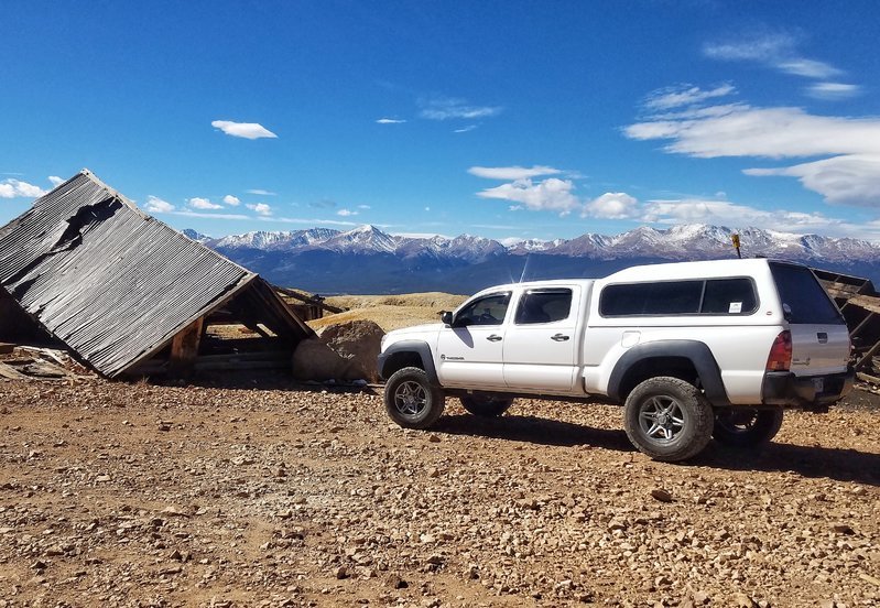

    Took a quick trip up an old trail to see how it handles off road.
    Then i took a 3 hour nap up top.

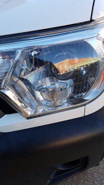

    well we got a nice snow at the cabin i stay at sometimes in Alma.. went out this morning, BOTH projector shrouds fell off due to the glue i used freezing and becoming brittle.. guess i know what ill be doing this weekend... DAMNIT! at least now i can fix the angle of the projector on the drivers side.

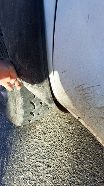

    Flexed pretty good offroad today,front drivers tire ripped the lower part of the fender flare off.... that is just unacceptable Ha. Does anyone have the link to modifying stock flares for 1.5-2" gain of wheel clearance?

    Remove the inner liners and flex, make sure the tire doesn't hit the fender. If it's at the sweet spot you're good to go. If it hits the fenders you might want to add some super bumps with a washer or 2, or trim the fenders which can be time consuming if you don't want it to look ugly.

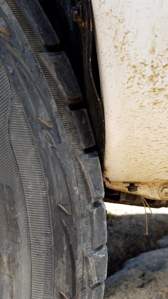

    20161020_083835.jpg i guess the glue i used doesnt like sub freezing temps... fixing this tomorrow. BOOO
    Tire caught the flare and ripped the mounts on the lower portion. Whomp whomp whomp

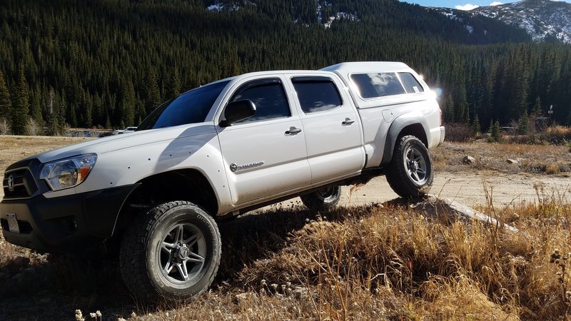

    20161024_144749.jpg well at least i know where it hits :(
    Flexes pretty good though. More pics to come once i get a better internet connection.

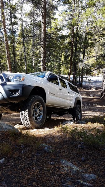

    Super flex ha.
    20161024_145004.jpg 20161024_144934.jpg 20161024_144822.jpg 20161024_142723.jpg 20161024_145623.jpg
