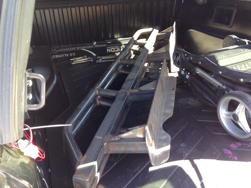

    I asked them same question to Eddy at SOS when I purchased my sliders because I have a DCLB, but I only wanted the sliders to go the length of the doors like they do on the short beds - just didn't like the look of the sliders going past the rear door.
    Apparently the mounting locations are different so bolt on sliders for a DCSB will NOT fit the DCLB. I just had Eddy make mine to 78" like the short beds. Just picked them up today!
    SC2SC and James_Bond[QUOTED] like this.

    SOS sliders do use the factory frame holes, no drilling. Apparently there's a difference between the LB and SB.

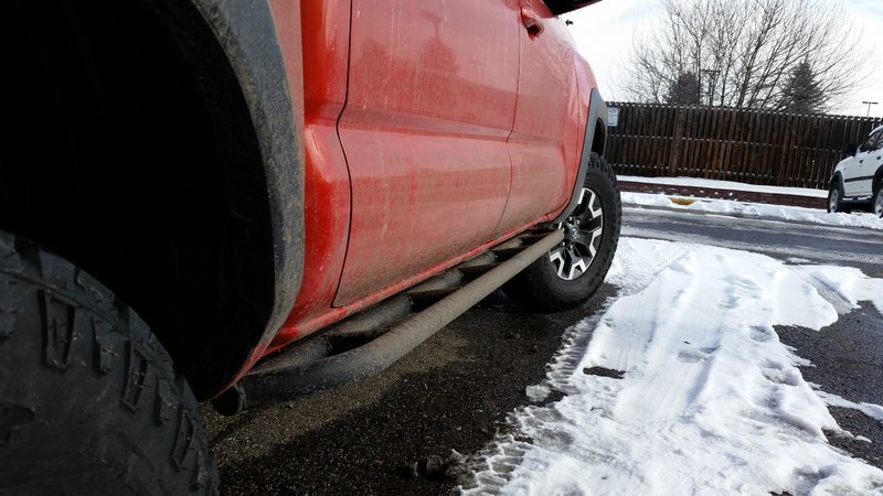

    Are most people powdercoating their sliders? Painting? Line-Xed? What's a good average price to get coating done locally (as opposed to having the builders do it)?

    i got quoted $200 for Rhino Liner.
