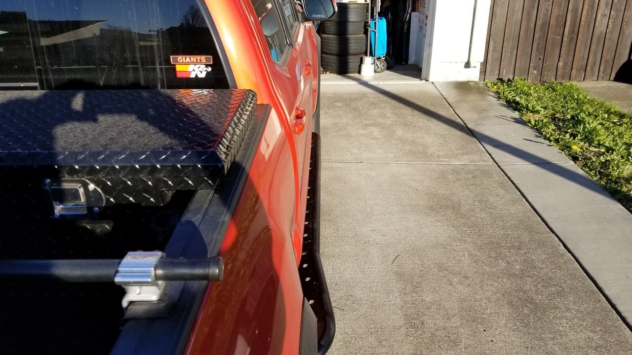

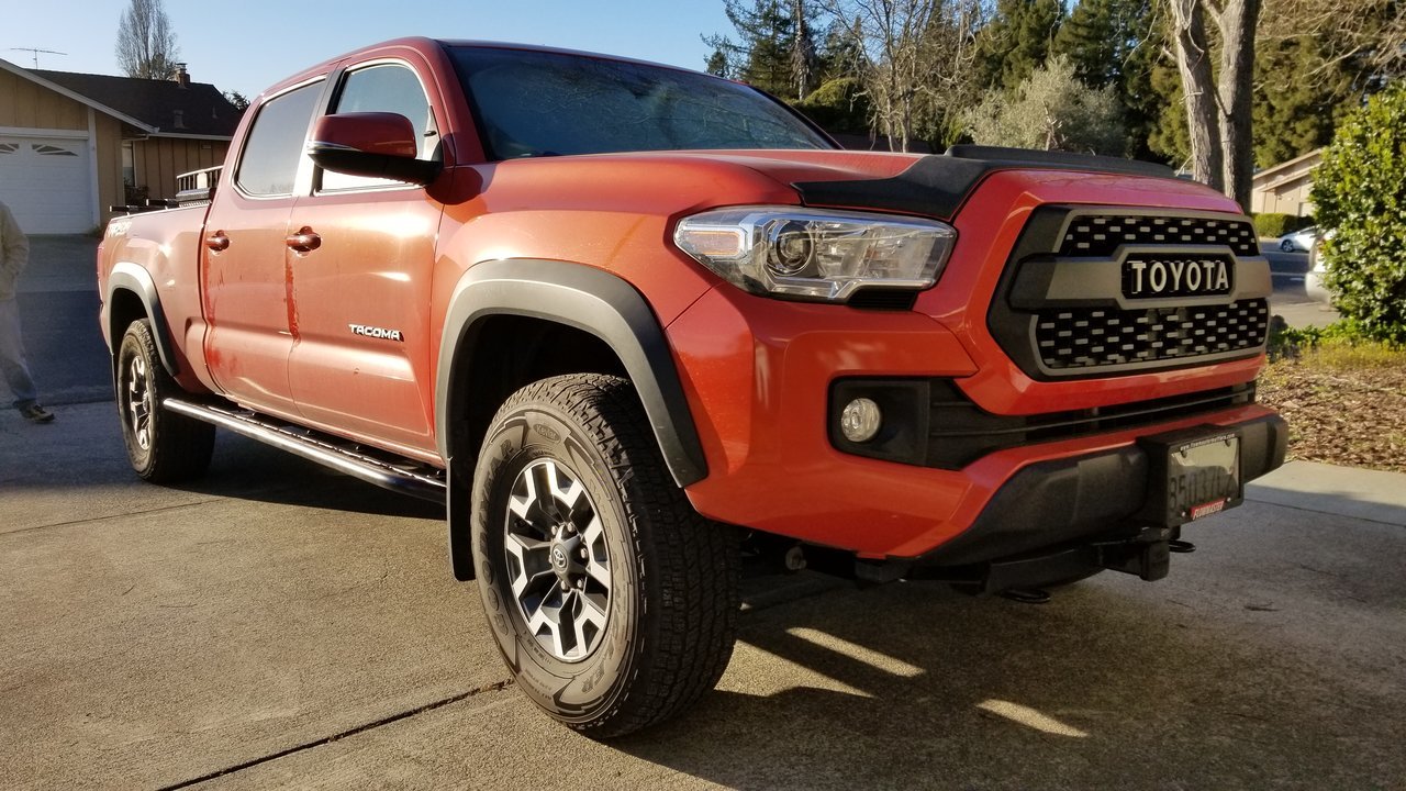

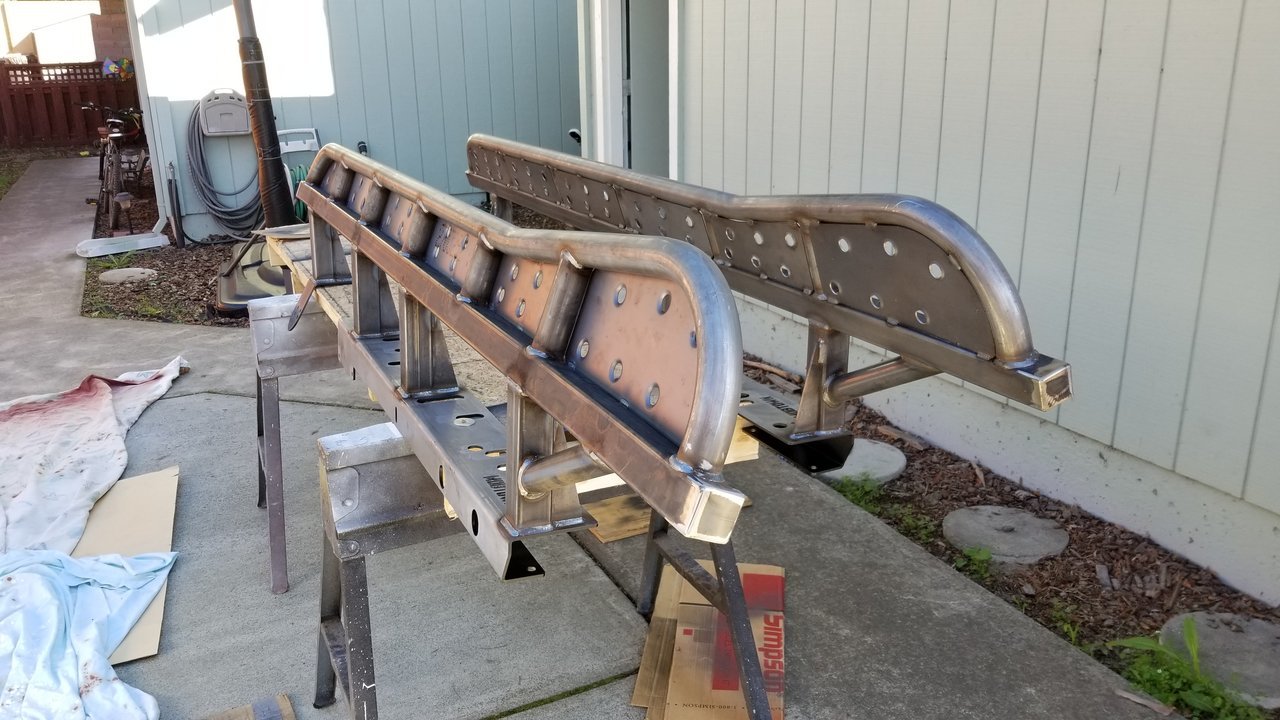

    One vote for Mobtown. They have an extra support bar at the end of the slider.20180217_144336.jpg 20180219_164726.jpg 20180219_164805.jpg

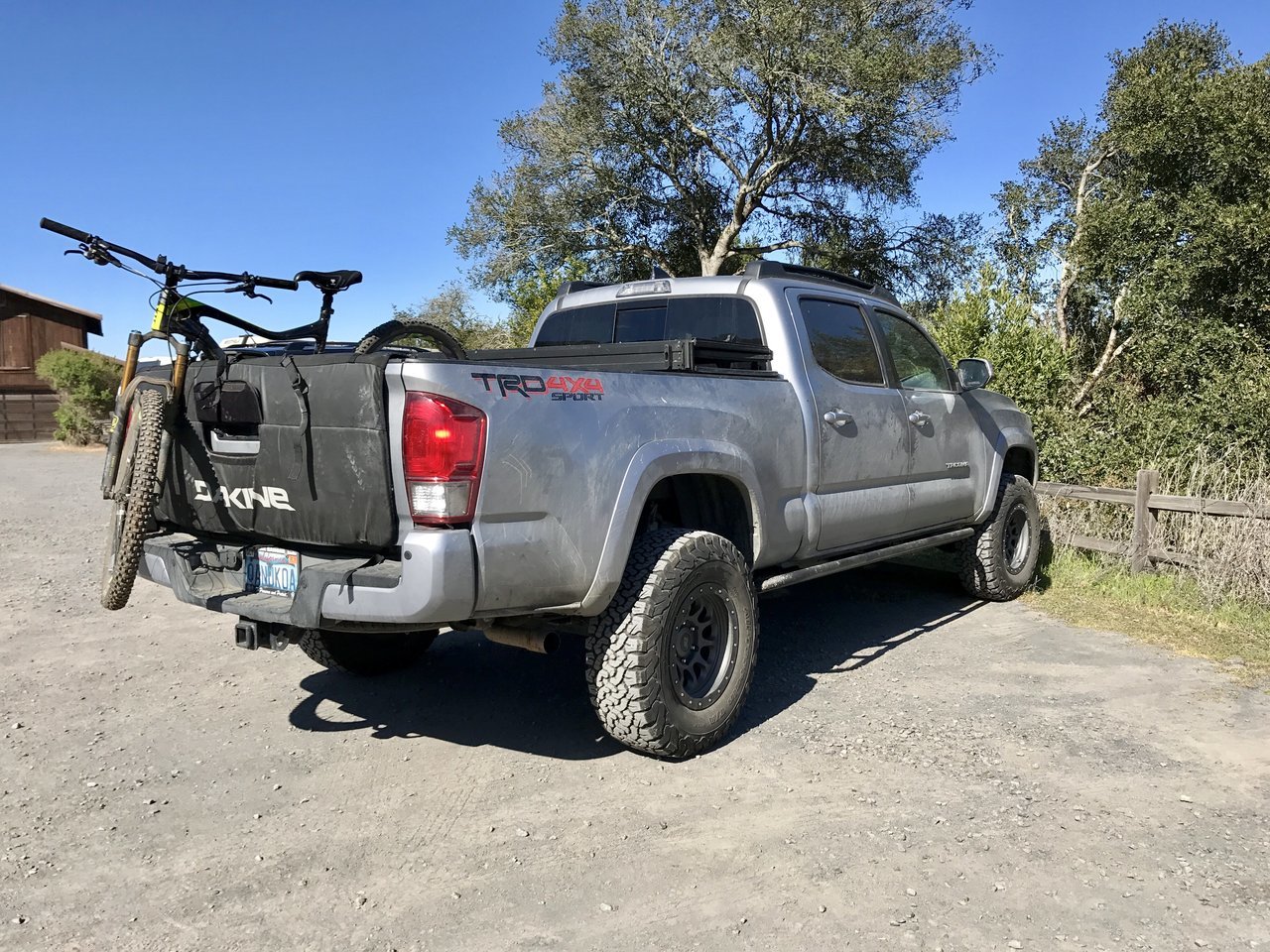

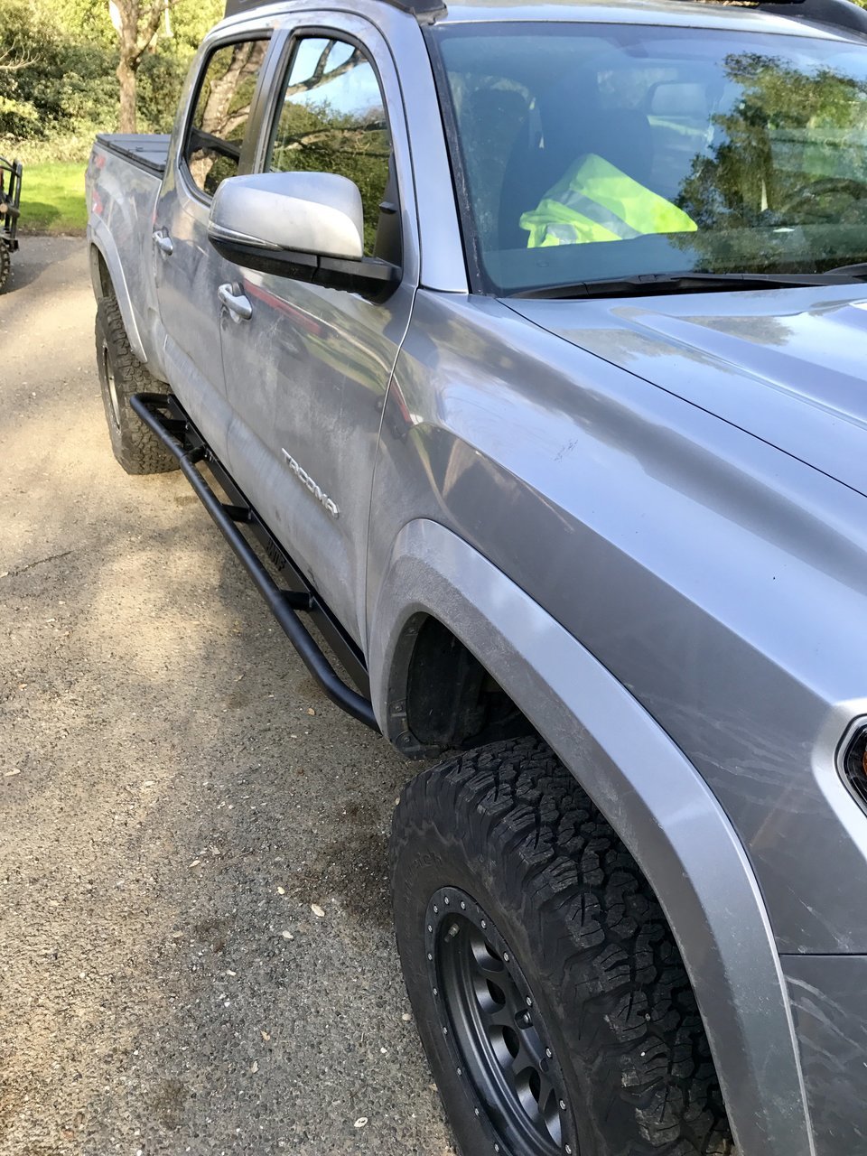

    CBI have not had a chance to test em out yet, but they are good quality, solid, good welds....

    these look really solid! out of curiosity why'd you go with the fill plates? at the 20 degree up angle they aren't that easy to use as steps on a routine basis...does the fill plate really help much with that. all the ones i've had didn't have a fill plate bc i didn't think it was worth the money...wondering if 3rd time around it's worth the extra $$$

    have you tried to high lift off the very end? my original sliders were about 95 inches and they just weren't supported enough at the far end. i love the idea of having them longer so you can dump right onto the rear tire if need be, but if they're not strong enough to support the vehicle without any bending they're not so useful.... (fortunately i tested this in my driveway before embarrassing myself on the trail)

    I find as a step the sliders work fine, however you are correct that at the 20 degree angle the fill plates don't really do anything. I wanted them there to help keep things like rocks, snow, or mud from flying up all over the body of the truck.
