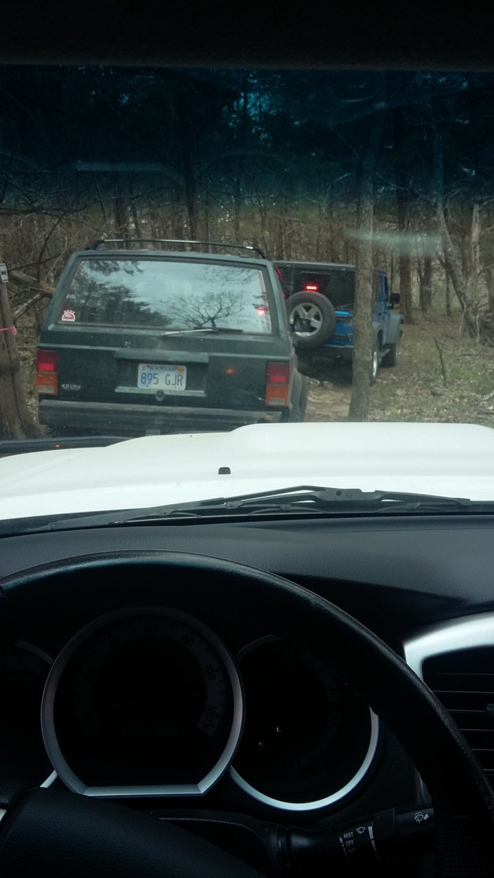

    I wheel my DCLB through trails designed for Heeps. Sometimes you have to make a 3 point turn to make a corner but it's nothing crazy. It helps if you have a front bumper with hoops as a guide to go right up to so you can get the most out of your turn radius. Also learn where your cornering/turning pivot point is. For me its just before the rear fender flares, or so I've learned.
