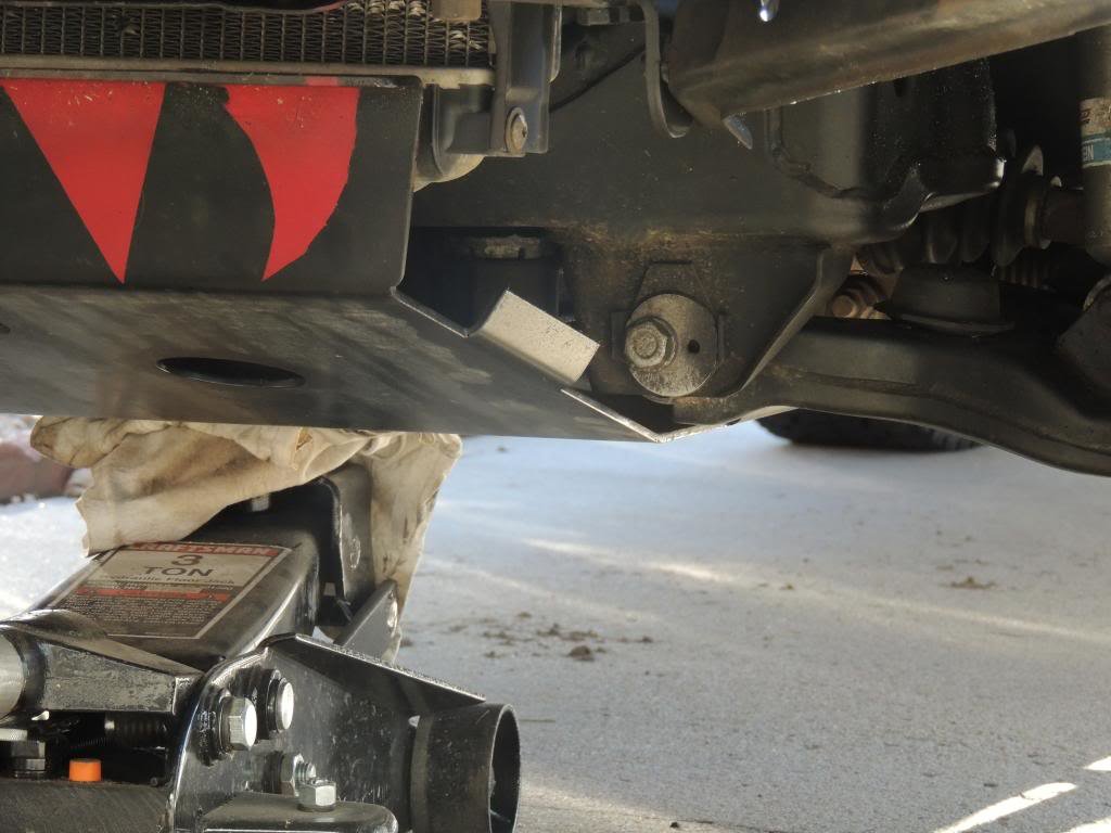

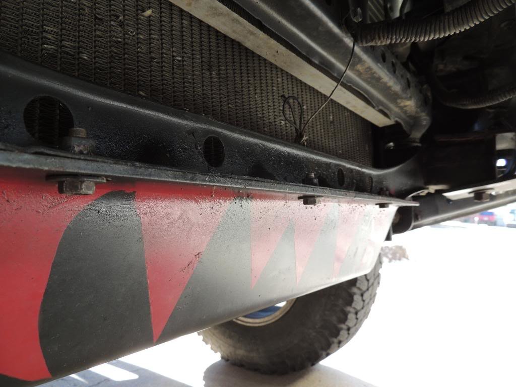

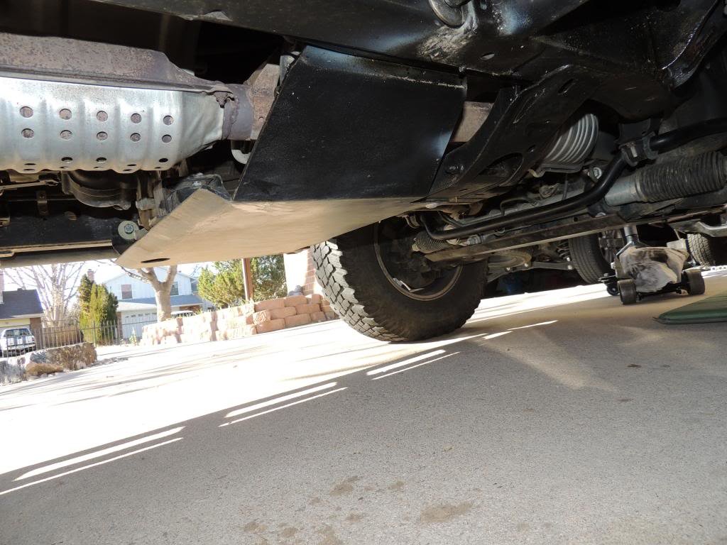

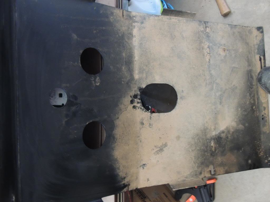

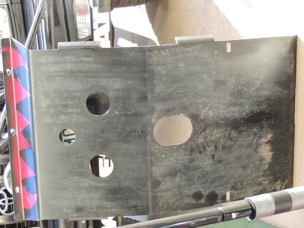

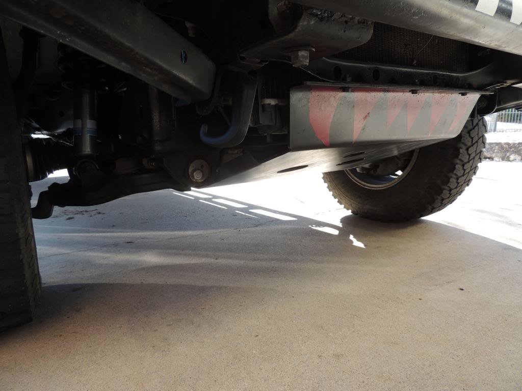

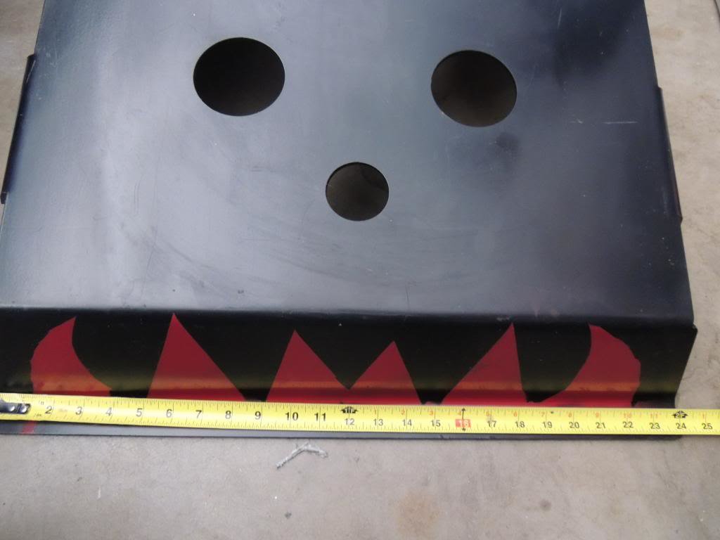

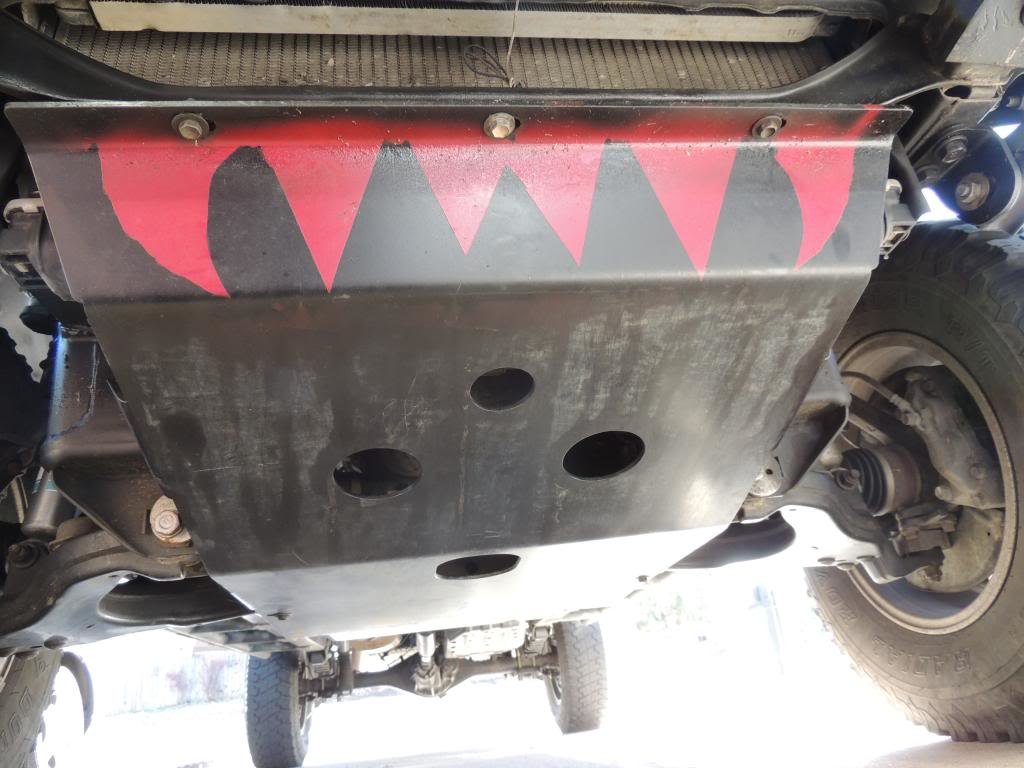

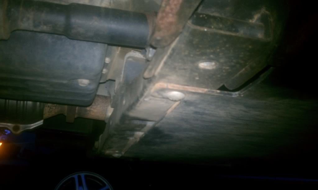

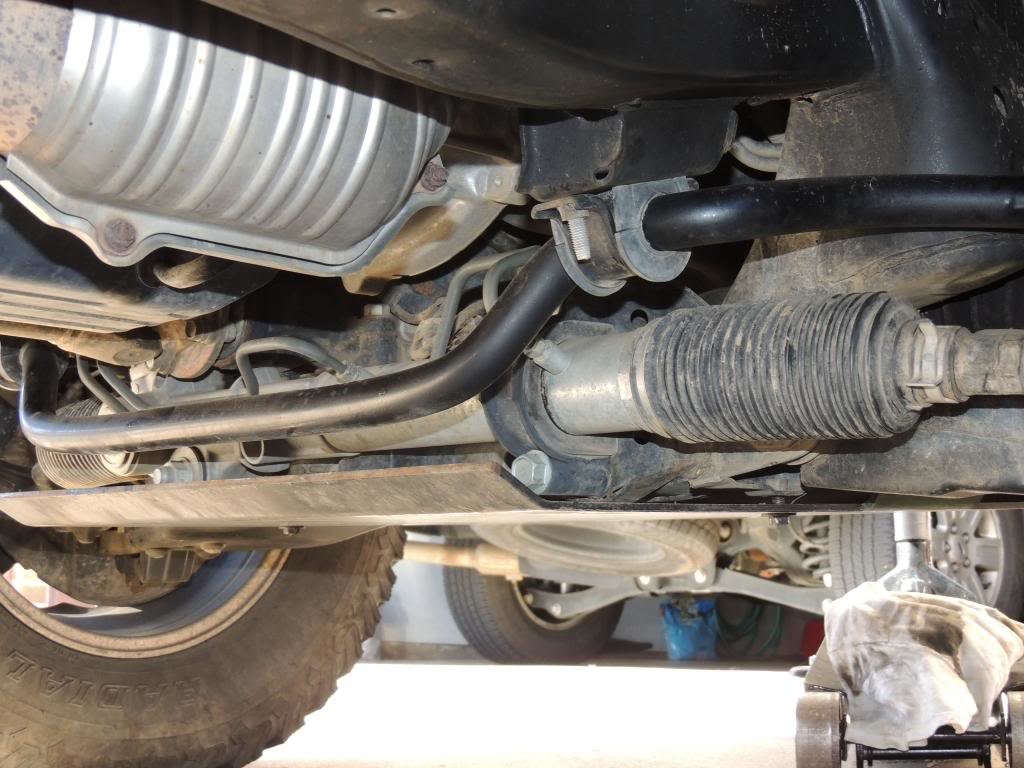

    I shoulda started one long ago but didnt, Im starting by posting some skid plate pictures to help out a fellow tw member build his skid.
    TW sponsored meet (Im the first gen in the corner)
    skid pics
    back part, also showing tcase skid waaayyy better then the factory piece of a piece of a skid :D
    underside a littel dirty

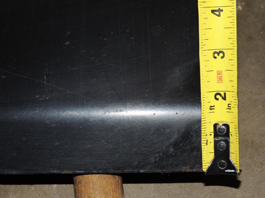

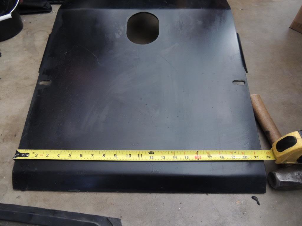

    Lmk what else you need, its off so I can measure it. I might pull off the tcase skid incase you'll make one too. Btw after removing it I bounced it up and down and measureing it went up about 1/4 in (its a bit heavy....)

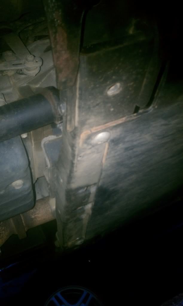

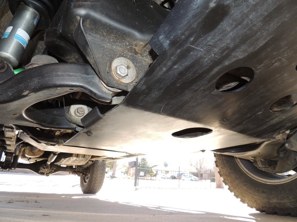

    Nice truck man. A couple questions about your skids. How did you attach your t-case skid to the frame? And what thickness metal did you use for both skids? I'm getting ready to build myself a full set and I'm just trying to gather as many ideas as I can before I start mocking them up and gathering supplies.
  9. Dec 4, 2012 at 5:13 PM
    Dcpsychobilly
    Dcpsychobilly [OP] Well-Known Member
    Feb 29, 2012
    #73880
    3,362
    Aurora Colorado
    04 dbl cab Taco
    Bumpers, skids, lights, cb, trail gear sliders, front lift adj bilsteins, dakar lift leaf springs rear, smittybilt seat covers
    :woot: :woot:
    Thanks man :thumbsup:
    It has 6 bolt holes, front two plus two on each side
    (I'm only running 1-reason > I see it as a trail rig not a crawler)
    Its from 3/16
    I can take pictures of it for you, on how it mounts. I could remove it and post pictures on then ?

    You don't have take it off but some more pics of it installed would be awesome.

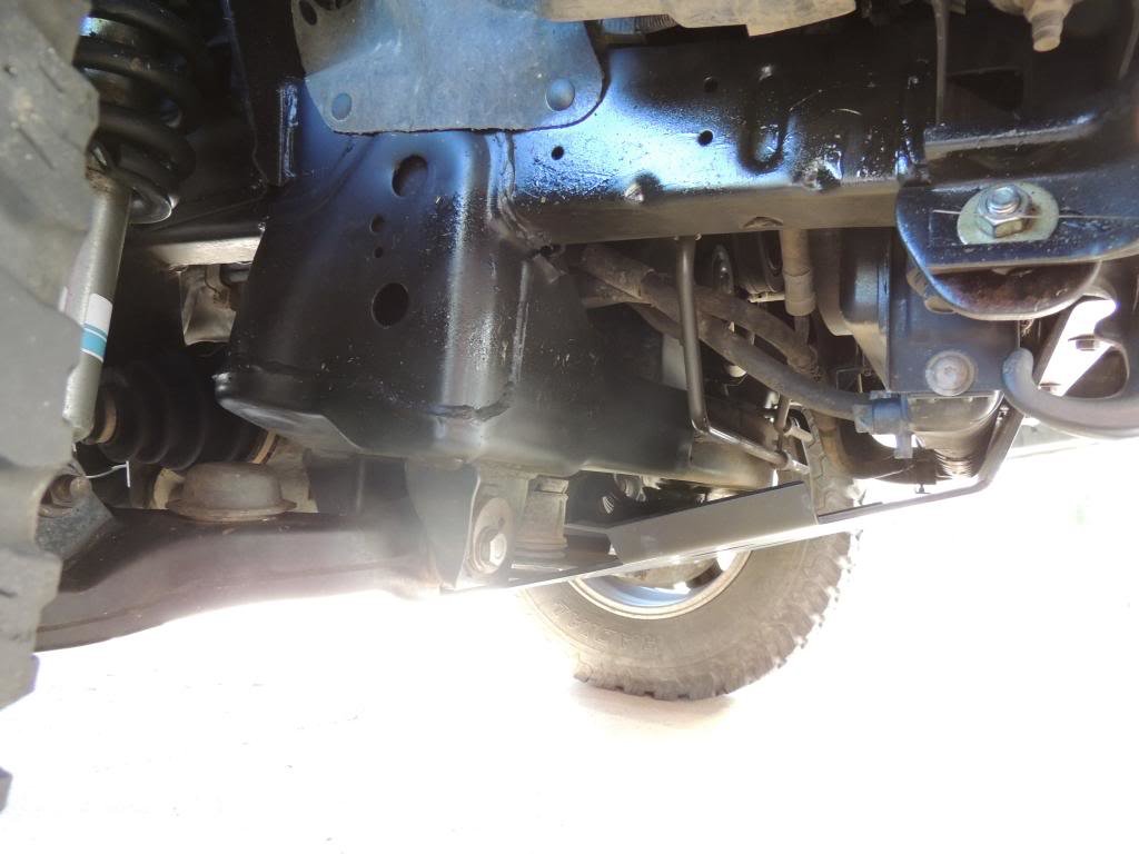

    Took a couple pics for you, but they came out pretty ugly lol
    Ill get some better ones with my camera tomorrow
    You can see how the front mounts (see the bolt with the round head) the side of the skid bends up and has two holes, two holes through the frame then bolt through it.

    Oh ok awesome. I understand now. I'm probably going to mount it basically the same but weld square tubing to the rear of the skid that will bolt to the frame rails, kind of like a rear crossmember.

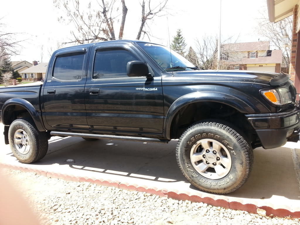

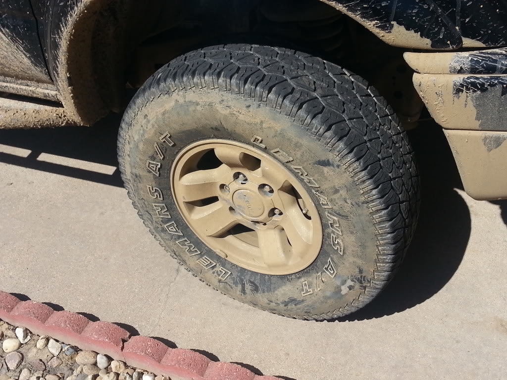

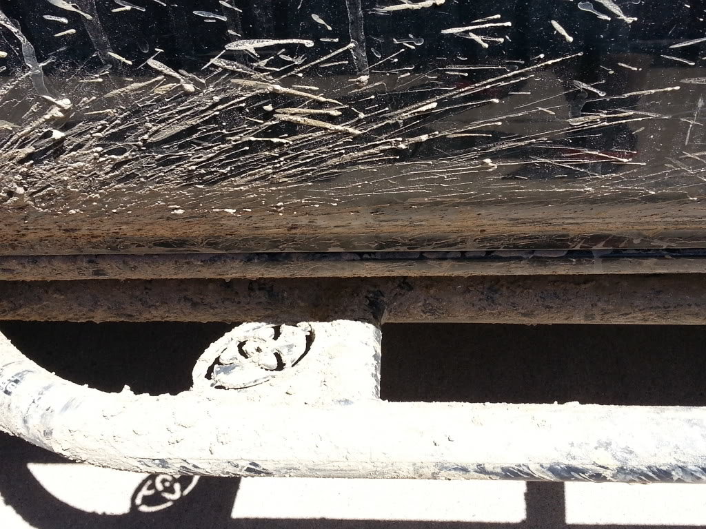

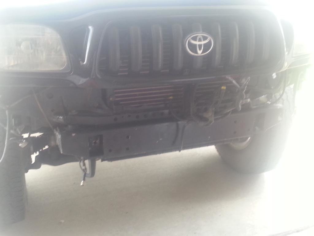

    Some kinda recent pics
    When I got back
    After a quick wash (maybe to quick it was still dirty)

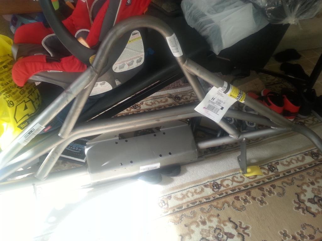

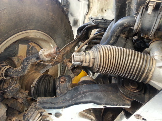

    What needed replacing after (and causing me getting a bumper made pushed back, way back :()
    After (in process)

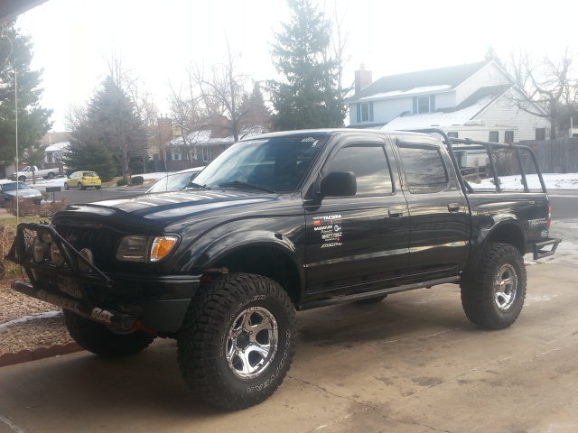

    Time for an update
    Since the last post the list of mods
    Spc uca's
    285/75 Duratracs and rims
    Toytec Boss Coilovers
    Bed rack (Tonto27 's old rack)
    Some other random gear also added, arb snatch strap, quick fists, random tools etc etc.
    And a pic
    To come
    Redoing front/rear bumpers, redoing lighting /adding a light bar or two
    (bumper /roof) and last but not least it's getting a baby seat installed :D
