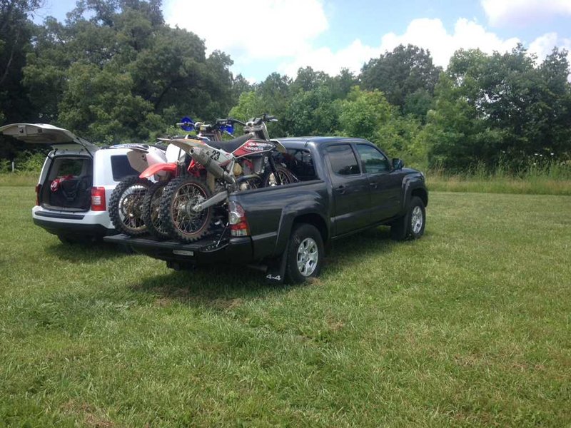

    here she is with 3 bikes.

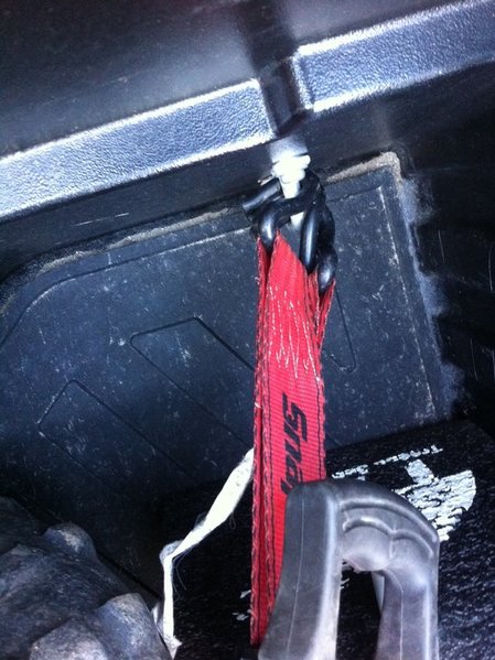

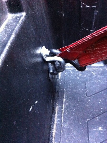

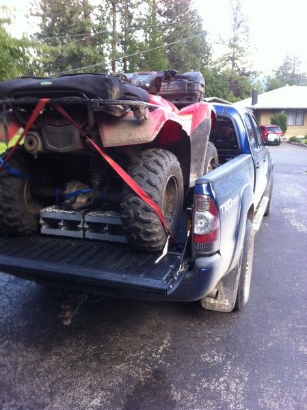

    image.jpg image.jpg image.jpg My 2010 didn't come with anything in the front so I installed some D rings and they were fairly strong. Here's what came stock on my 2014 up front... They are definitely strong, way better than those slider cleat things at the top sides of the bed.

    The ones in the bed should be ok. There are places that make nice motorcycle mount for the bed a few guys here have them so maybe try a search. I wouldn't trust the plastic things on the bed rail. Also may wanna look into a tailgate cap from KB voodoo. To save your tailgate from bending.

    I've never had a tailgate issue loading my quad with either trucks (10 & 14) but my tires weren't resting on the gate like they are with your bikes. I would probably add a reinforcement to the gate if I had weight on it like that while in transit.

    I hauled my bike (1 bike, long bed) many times with no tailgate issues but I went ahead and got a tailgate reinforcement anyway. With 3 bikes, tires resting on the gate, plus the weight of a man moving around on the gate during loading; I think you should get the reinforcement. Better safe than sorry.
