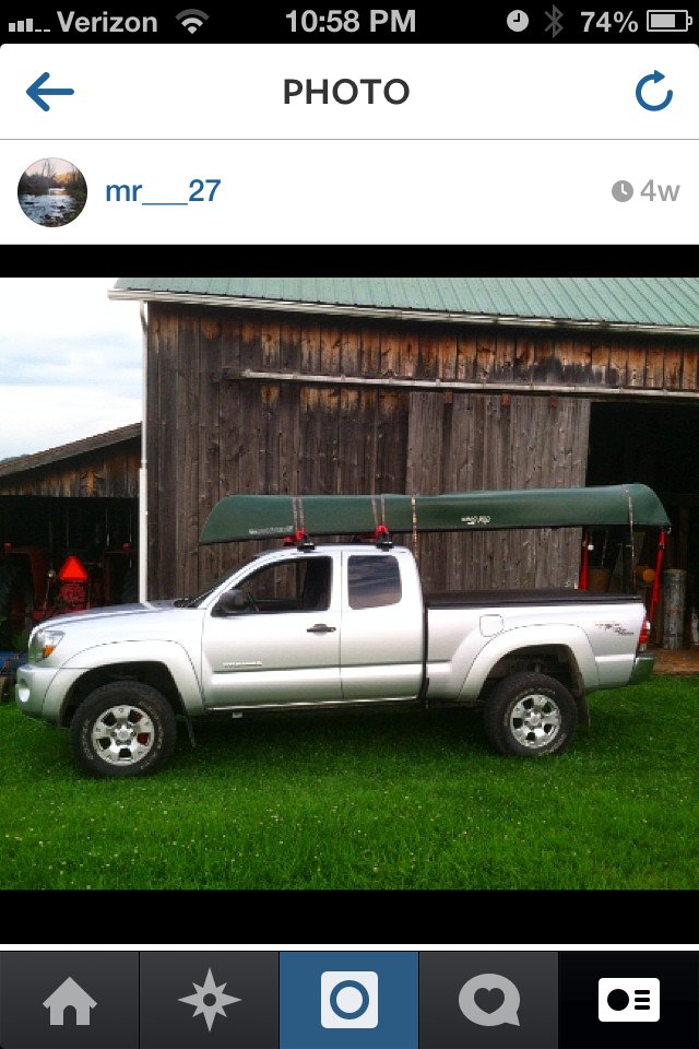

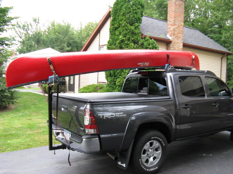

    This is how I do that. However this is on the OEM rack witch seems to be holding up? At the same time seems to be a bit weak. Got me there and back! I am using the Yakima attachment for yaks.

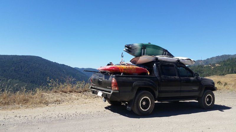

    I absolutely frll in love with my 2015 outback! last sunday had a 17 bass day here in lv nv! fish on!

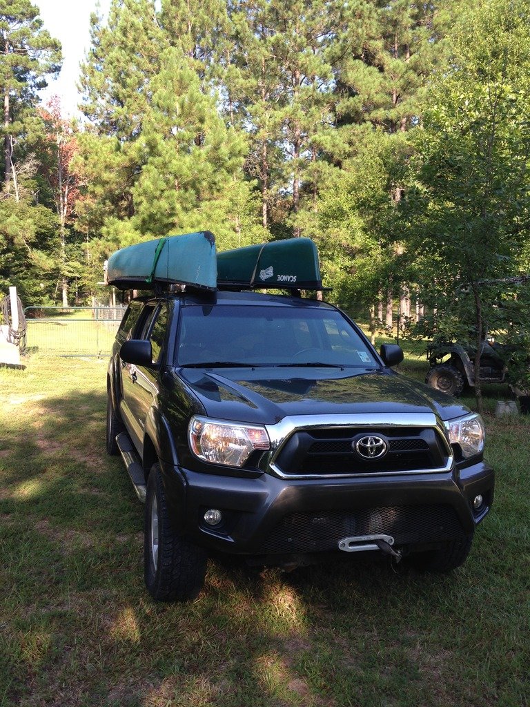

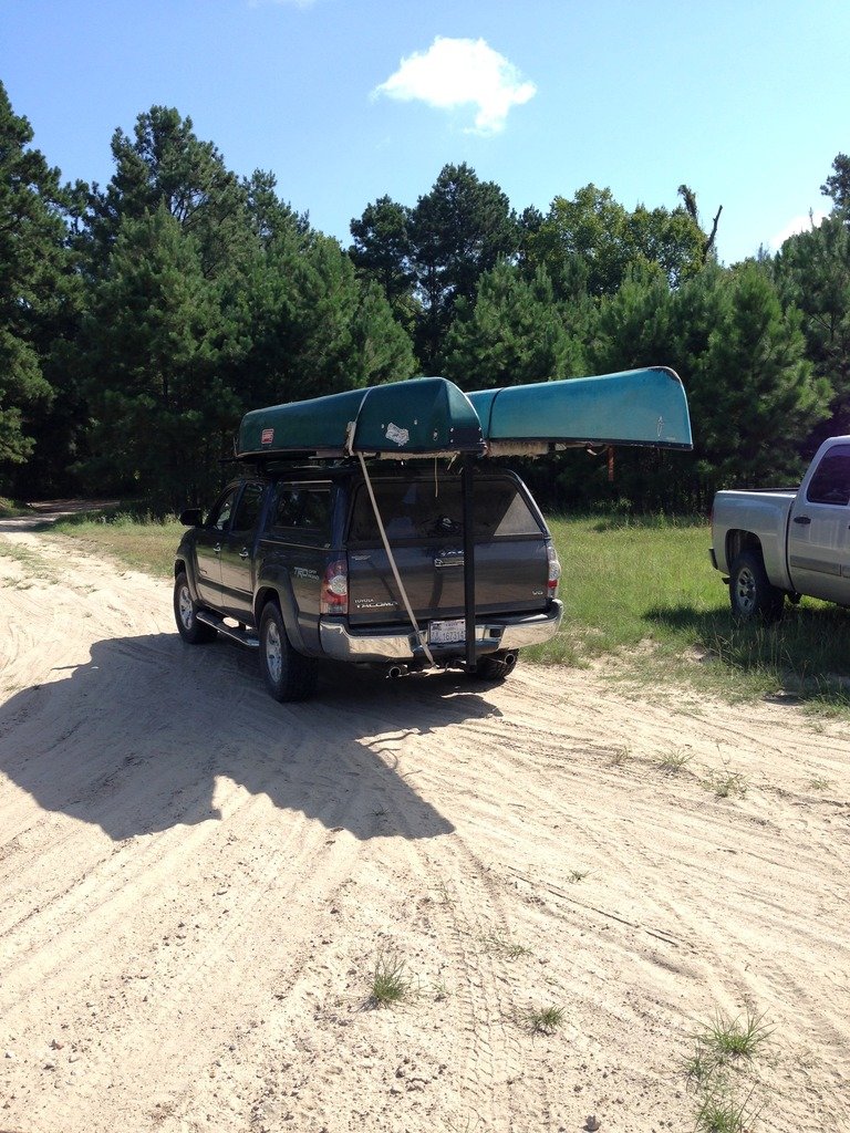

    Forestree
    Forestree New Member
    Aug 2, 2015
    #160891
    3
    2012 Tacoma

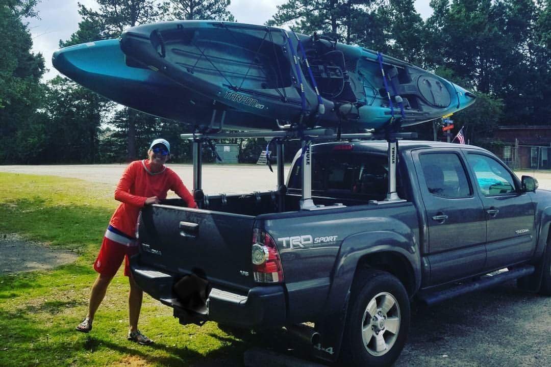

    I plan on getting a rack put on top of the camper but this is how I hauled 2 canoes a couple of weeks ago on my new to me Tacoma. Yakima towers and bar over the back doors and a redneck modified extend a hitch over the back (which makes it impossible to get in the camper)
    On my older Tacoma

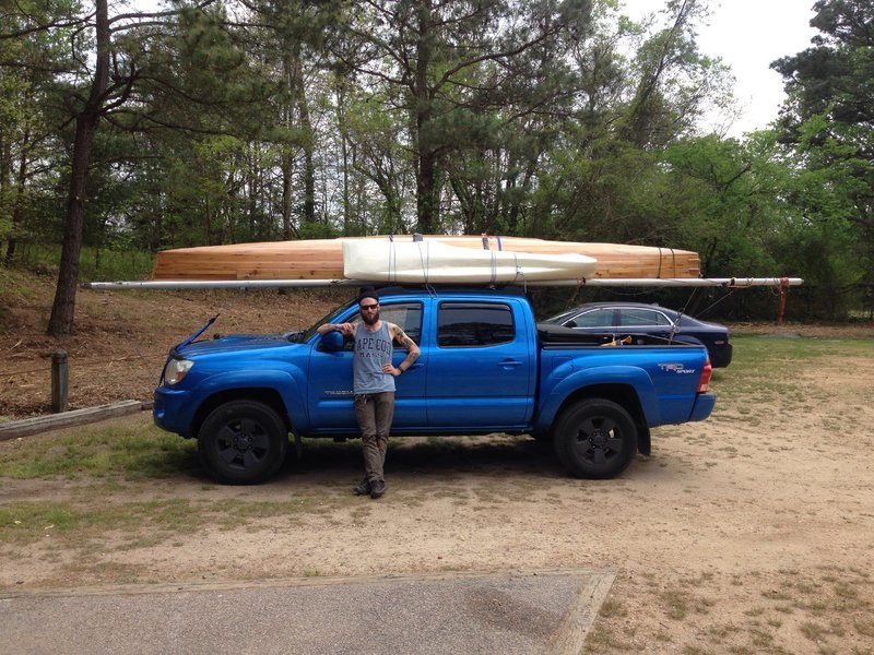

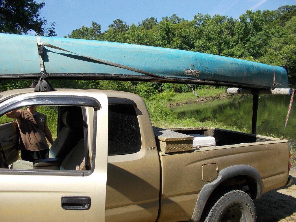

    my 18 foot canoe travels on OEM racks, tied down on the sides, front and back. It is fine on the highway, and the racks could probably support much more - if the oem toyota rack can do this, then a Prinsu rack could probably do more

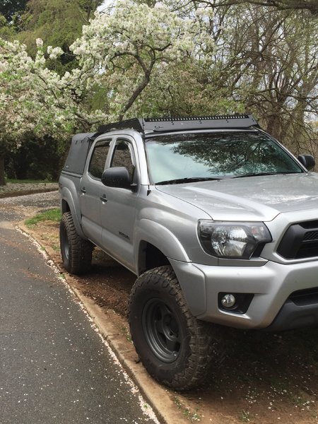

    Did you do a light bar on your Prinsu? I'm wondering if I need to get a taller point to rest the boat on as I don't want it sitting on my light

    More photographic evidence to advocate for cab canoe travel (oem rack works fine, but I may in the future get a sturdier rack)

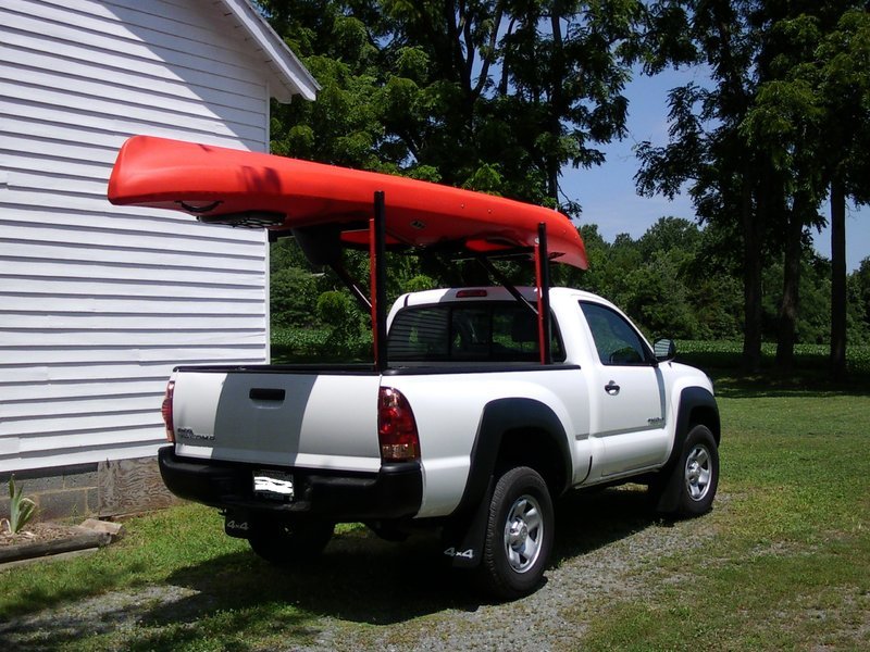

    I jerry-rigged a $99 Harbor Freight ladder rack to fit my 18' tandem kayak. Has worked flawlessly over the last 5 years, still use it to this day with appropriate tie-downs.

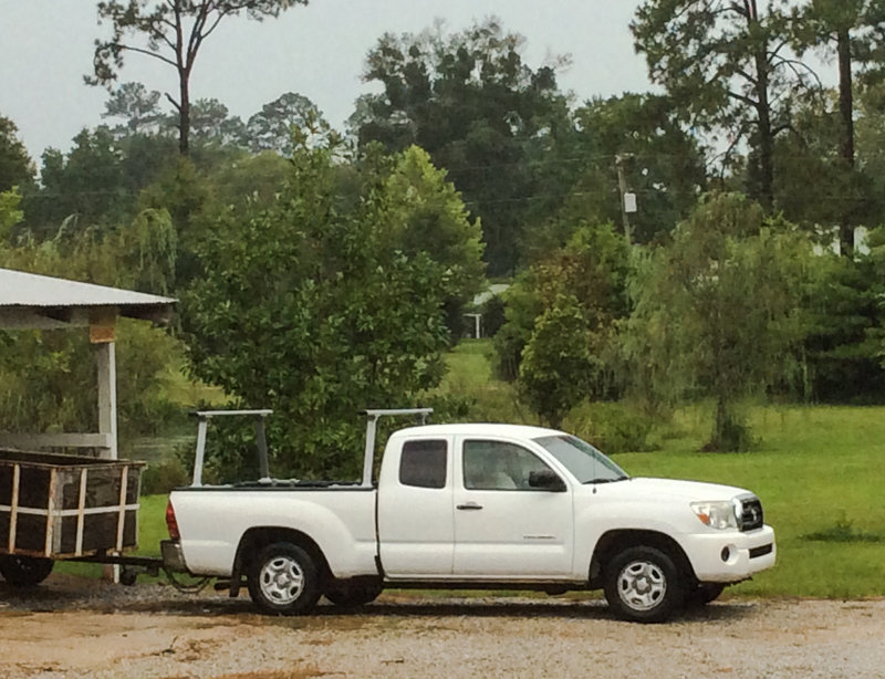

    Here’s my setup for 12 ft boats with the 5ft bed. Nice and secure. I run bow and stern lines if I’ll be traveling fast or far. The two can be thrown into the bed, tailgate down, for short trips @ low speed.

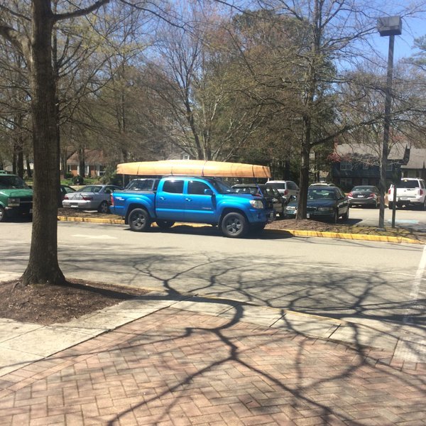

    I broke down and bought some Yakima J cradles. The cradles themselves are nice, but the arrangement with the truck being so tall and the factory roof rack isn't ideal.
    Our roof racks are quite flimsy and I'm not happy with how the weight "throws" around the roof rack bars. I'm about at 100lbs in that picture, so just at the rated limit, and it's not exactly a great solution. Might need a beefier permanent rack in the future to mount these J cradles to.
    Overall though, not a bad setup. I really liked that I had the full bed available for gear (which we needed) and the the trailer hitch was available to tow the boat. No way I could have done this with the kayaks hanging out of the back of the truck bed while towing.
