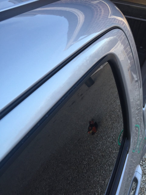

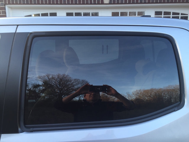

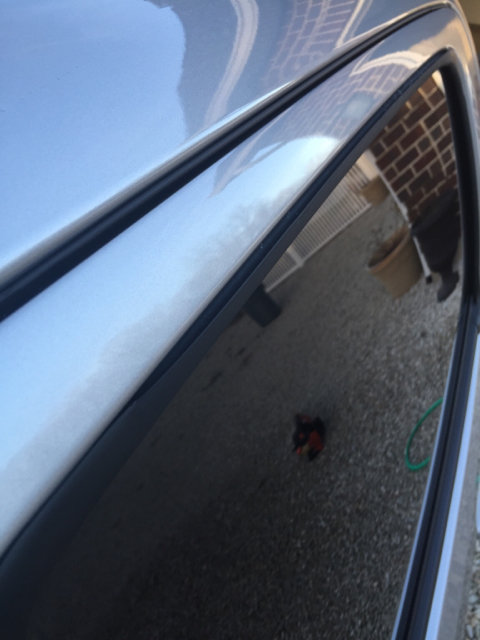

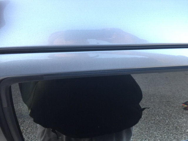

    Does anyone else's rear passenger window moldings not sit flush? Both rear doors are like this. Front are fine.

    Mine is also like this. Appears the "U" in the channel which accepts the window is too shallow. So when the window is in the full UP position, it's pulling the weather stripping away. The fix would be a revised weather stripping with a slightly deeper channel. If you back the window off just a hair, you'll see the weather strip will tuck back in, though it will be deformed from the extended pressure of it being over extended.
    Add another item to the list of minor things which will need to be fixed.

    Dealer inspected mine and agreed it's not correct. Waiting on a solution from Toyota. The dealer has four Tacoma double cabs on the lot, two have the same problem as mine.
