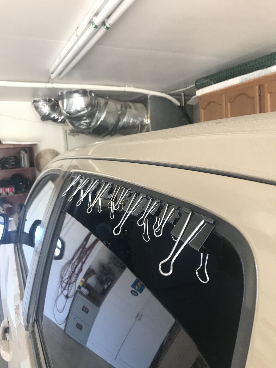

    What are the chances you can get the binder clips off there like REAL QUICK and put a piece of wood trim or cardboard (the length of the window) between the binder clips and the rubber trim? I am worried for you that the binder clips will leave imprints in the trim...

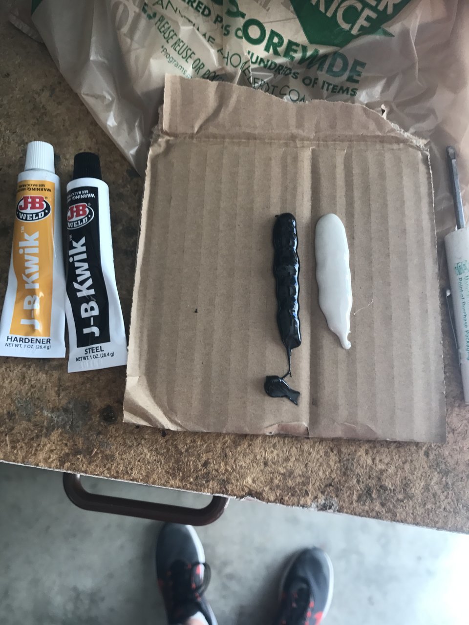

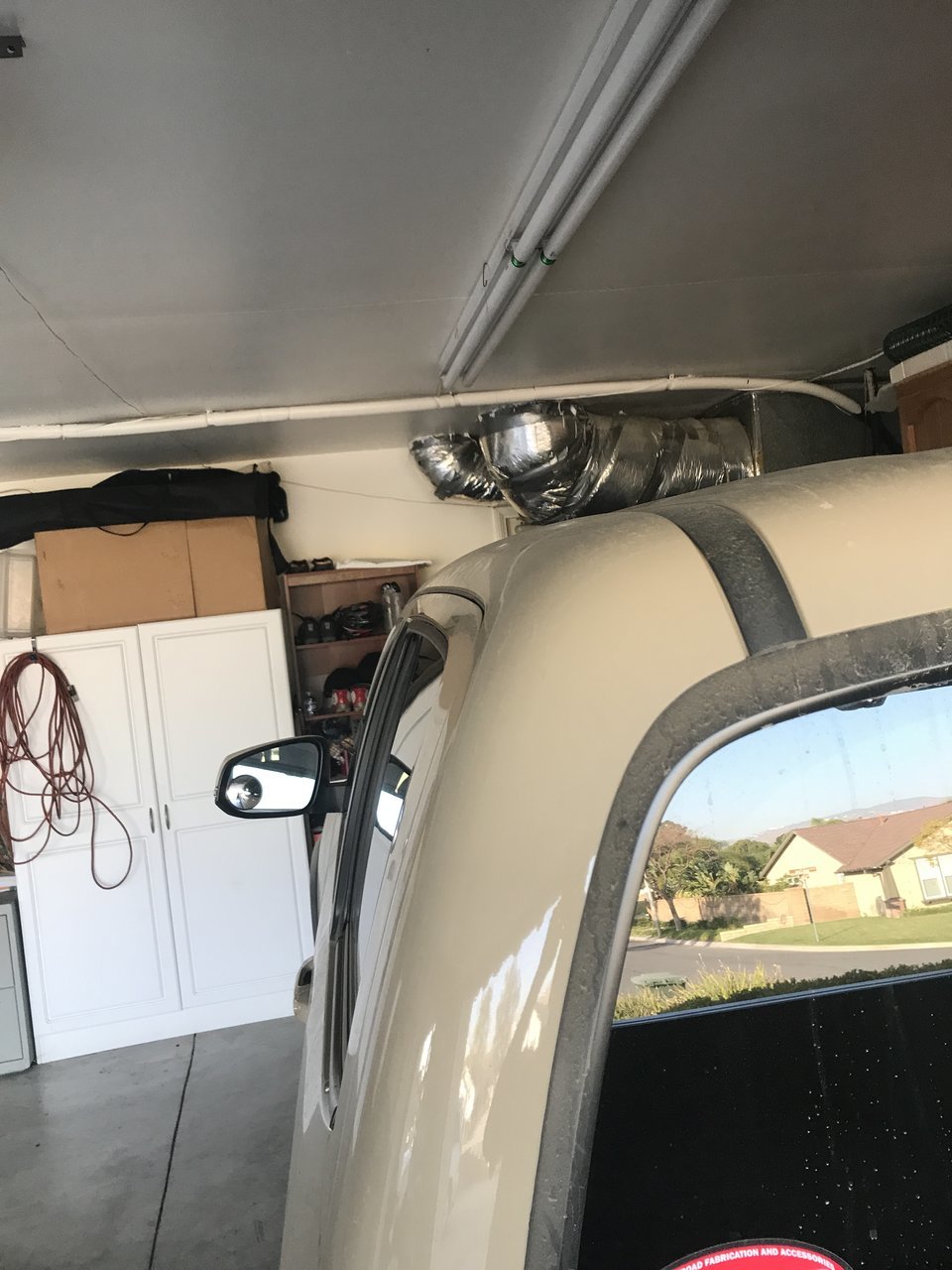

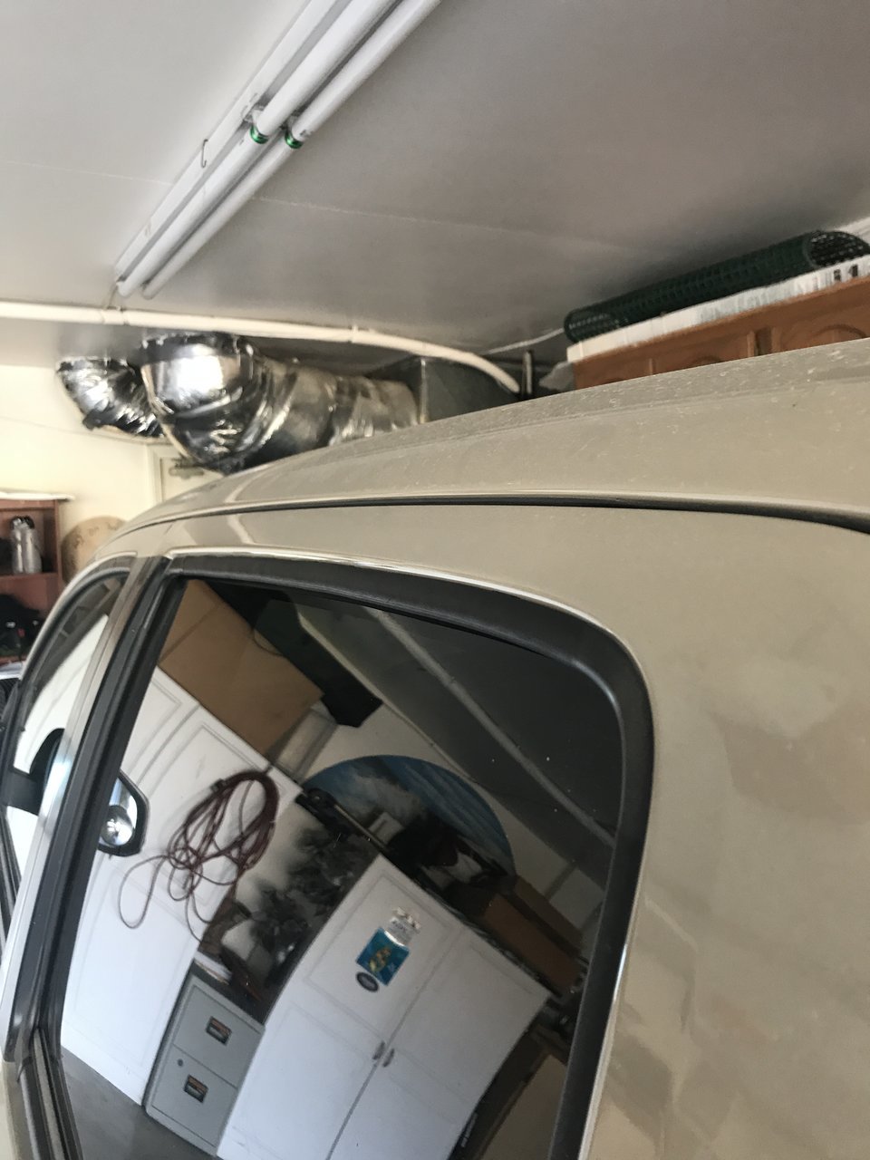

    Done and wishing I did this a long time ago. When the window rolls up it finally no longer pulls the trim with it. It sits flush and doesn't allow dirt and water to get in! I am now pleased. I went through 3 sets through the dealer and gave up and decided to fix it myself. Did both the passenger side and driver side rear doors

    Good point, no imprints! :)

    That turned out great.

    It's awesome. I'm rlly pleased with it. One problem down and onto the next one.... lol

    I only had the clips on for 10 minutes that's why it didn't make marks. I used jb quick and it sets in 4 minutes but I let it be for 4 hours before rolling the windows up.
