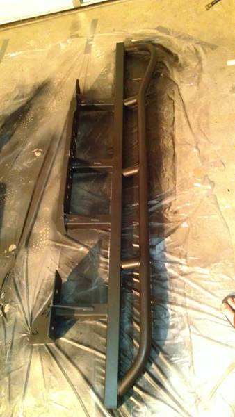

    I am going to use this space for a write up on installing Relentless Bolt On Hybrid Sliders with Kickout.
    Eric and his team make a high quality product.

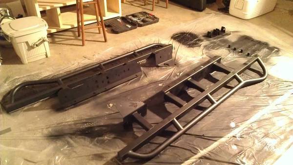

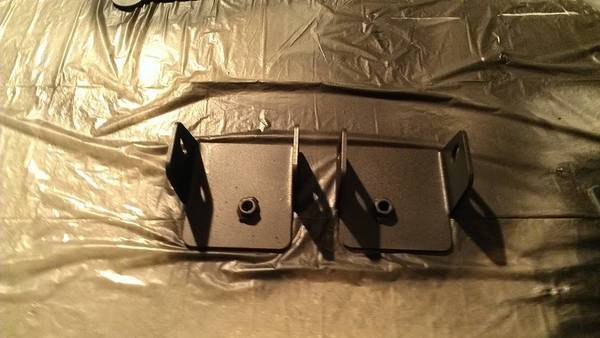

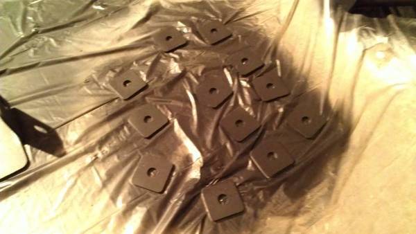

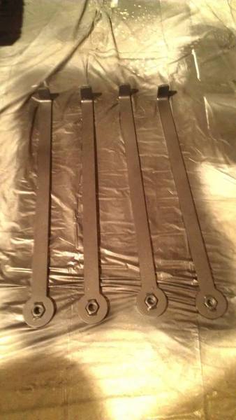

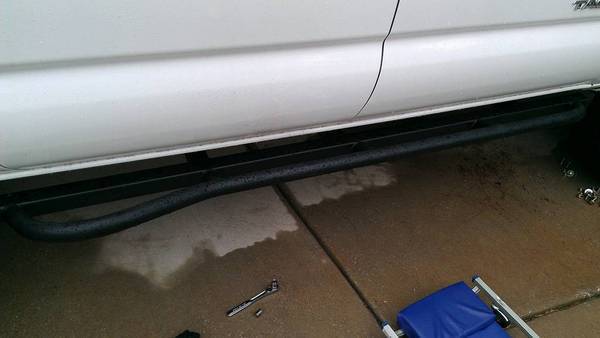

    I have painted all the parts that were bare metal.
    Square Washers
    U Brackets for Cross Member
    Extension Arms for Frame
    Driver Side Slider
    Passenger Side Slider
    All Parts
    Primer
    BedLiner

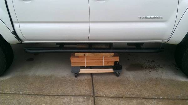

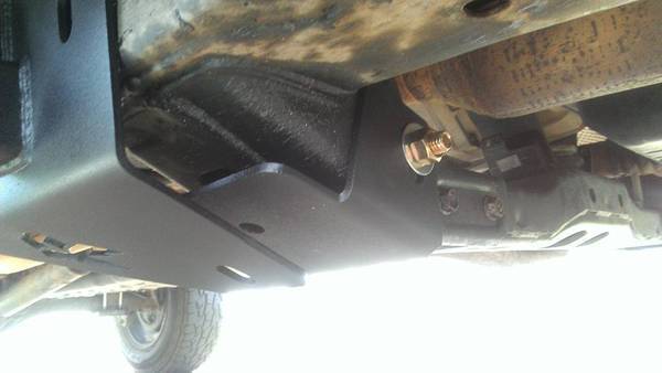

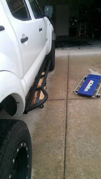

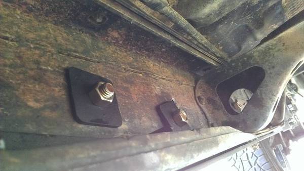

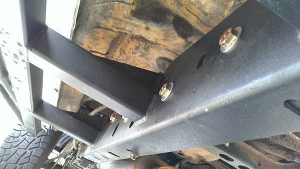

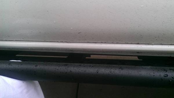

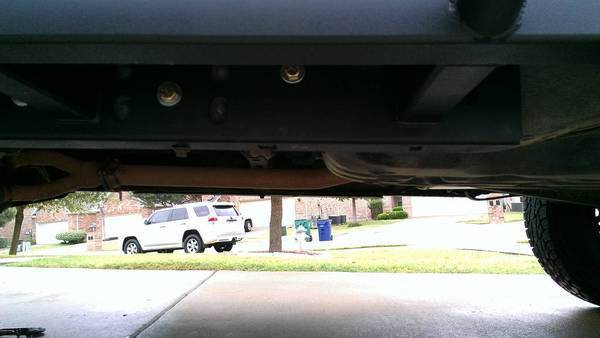

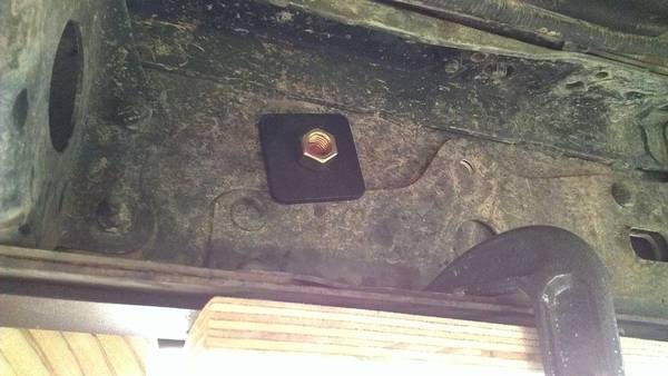

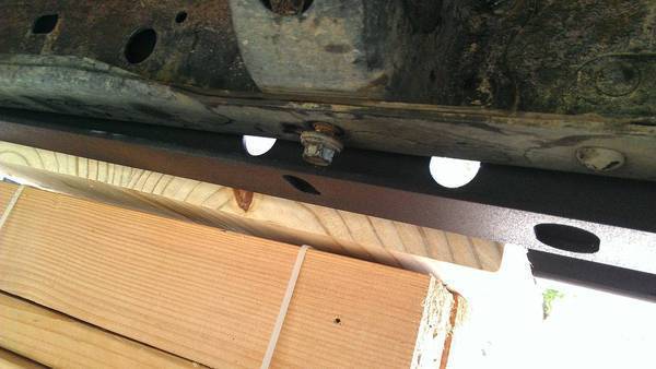

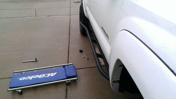

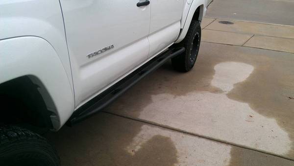

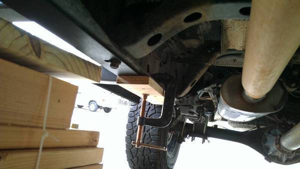

    So I have installed the sliders and performed a preliminary test.

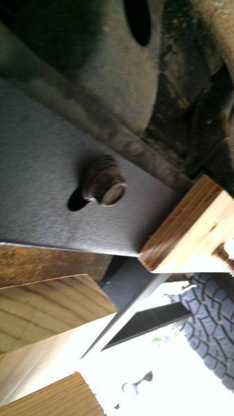

    I started by making a rolling cart stand that held the slider in place as close as I could get them to the holes in the frame.
    Once in place I positioned them as best as I could
    Then I installed the U Cross Member Bracket
    As always leave everything loose until all bolts and nuts are in place for fitment reasons.

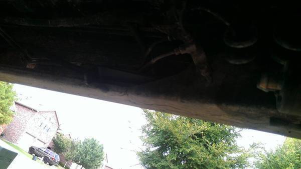

    Removed the Drive Shaft Cross Member Bolt
    Removed the Hose Bracket as it was in the way.
    Lining up the holes

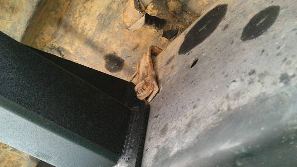

    Then I clamped the back so that I could keep the holes inline to start installing the bolts.

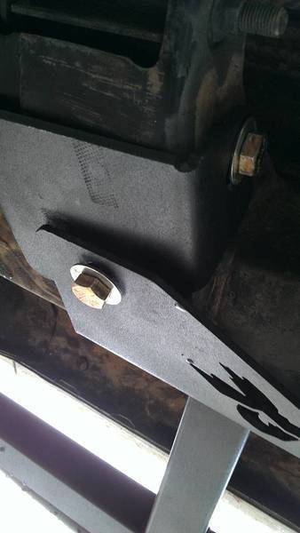

    I installed the U Cross Member Bracket Bolt to the sliders because it is hard to line up.

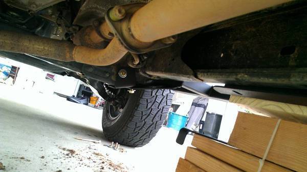

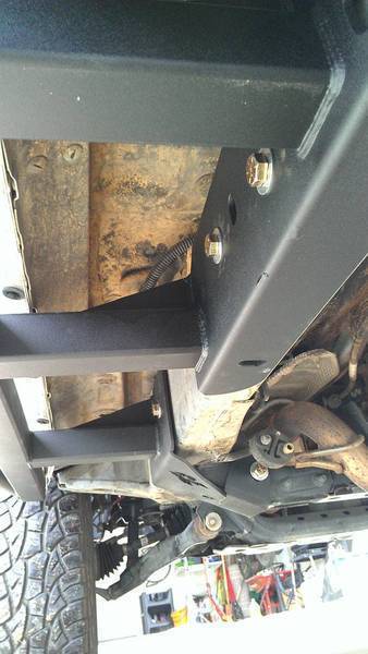

    Then I figured out what the extension arms were for
    Position them inside the boxed in part of the frame and install the bolt for the one closest to the back of the truck first as it is easier to get the front one in because the extension arms from the front will be close to the hole for the back one.
    Re-install the Drive Shaft Cross Member Bolt so the the rest of the slider is in place.
    Install the rest of the bolts from the outside
    Use the square washers on the inside.

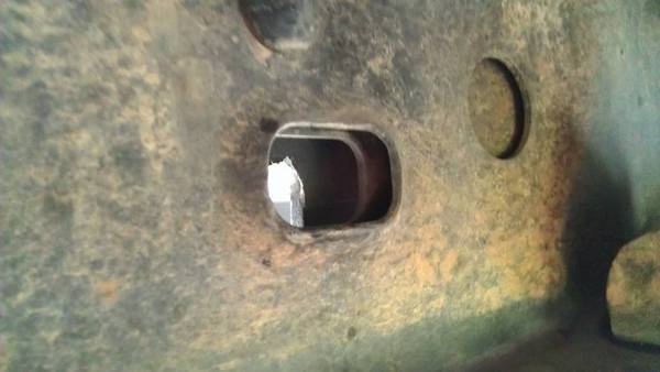

    Also the last hole in the frame toward the rear I believed was a mounting hole, but the bolts were not long enough to fit through it and get the nut on. So I do not think that is a mounting point.
    There is one bolt and washer that goes inside the boxed in part of the Drive Shaft Cross Member. One of those tough spots to get to.
    Passenger Side Done
    Driver Side repeat all steps

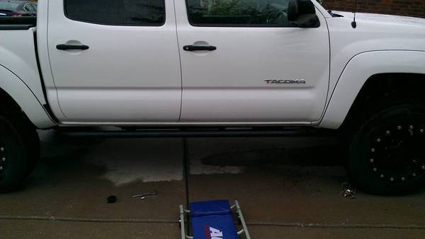

    Driver Side Bolted on
    Driver Side Installed

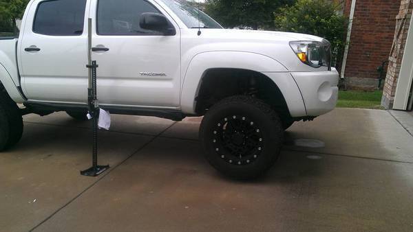

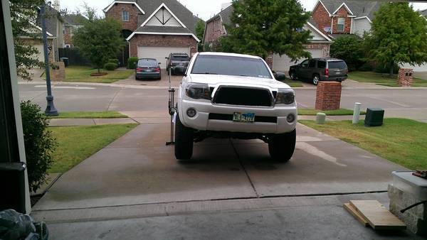

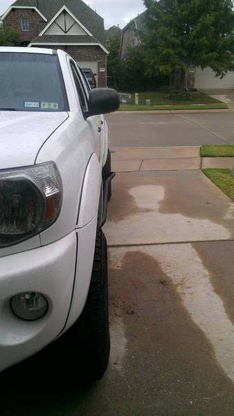

    Hi Lift Time with Relentless Hi Float Base
    I know everyone had been asking around if the bolt on sliders were strong enough for a Hi Lift.
    They flexed a little bit since I did not install the bottom two bolts that require drilling.
    It came close to the pinch weld but never touched.
    Done

    Very nice.

    If you had added the bolts to the bottom (where drilling is required) do you think it would have not flexed? They look like even without the bottom bolts that they would hold if you lost clearance and save your rockers.

    Yeah these are super beefy. I dont think you need the bottom two bolts unless you are just super careful.
    I can imagine once I let them sit a bit and then go back and torque them a bit more they wont flex at all.
    I havent been working out so I am kind of weak on the wrenching.
