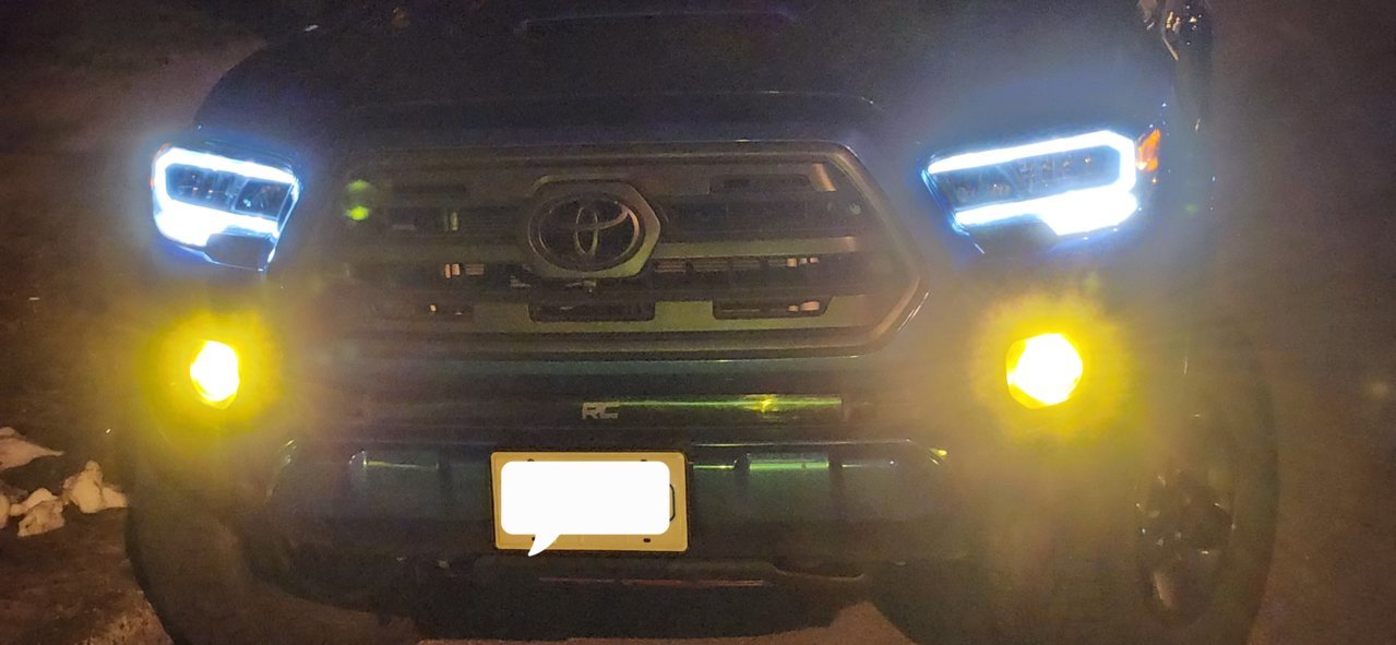

    I know it isn't an option in the question, but I paired the Elites with the LED headlights and I am very happy with the combo. The light output from the fogs is great on dark rainy night drives.
