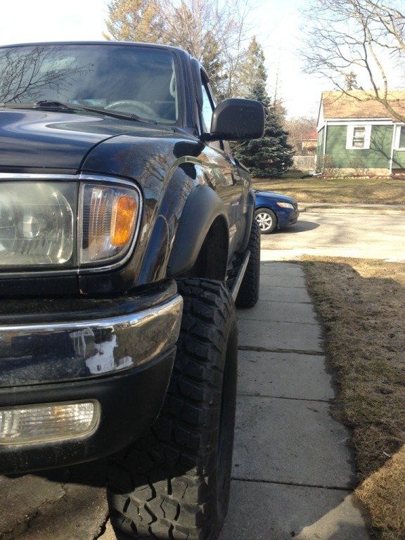

    took the winter wheels off today. I left the spacers on to see what it looked like. Never should have done that, it looks sweet< probably will kill my wheel bearings and i doubt i could stuff them. I think im going to take them off tomorrow. I do like the look without the center caps though.

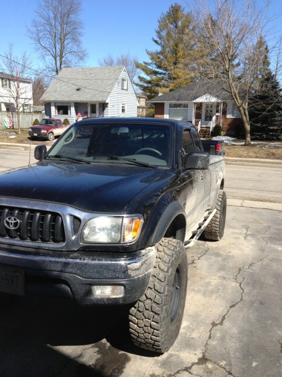

    Went for a ride the other day, nothing new other than I took the spacers off.54ECE3F2-BA2E-4964-B622-0594438F20BB-577_7a21b92ca1ef673f4996355d12a6698034819ae6.jpg

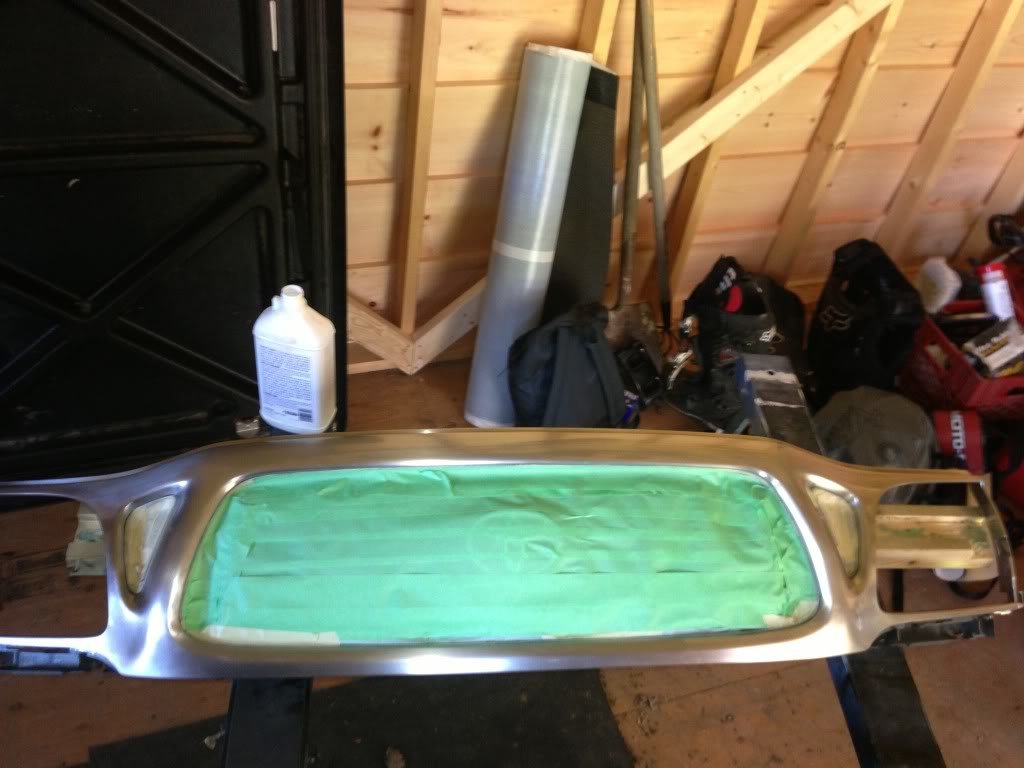

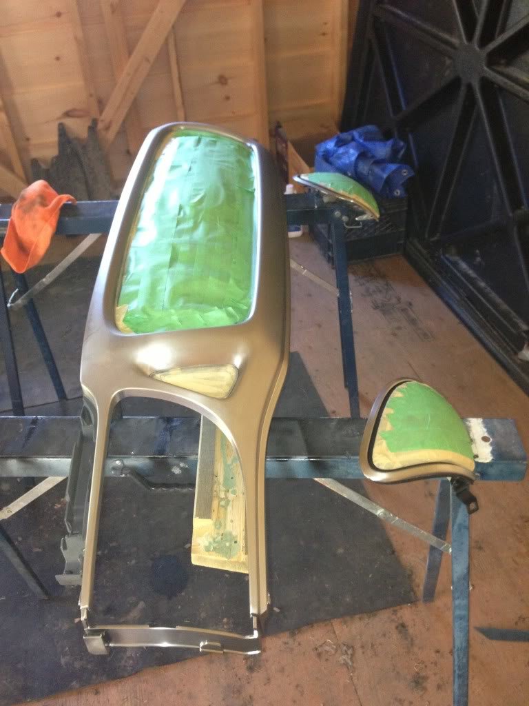

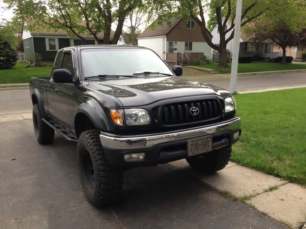

    Painted my grille today, I used scotch brite to scuff up the chrome. 2 coats of adhesion promoter. And then 3 coats of satin black bumper enamel. I think it turned it pretty good.
