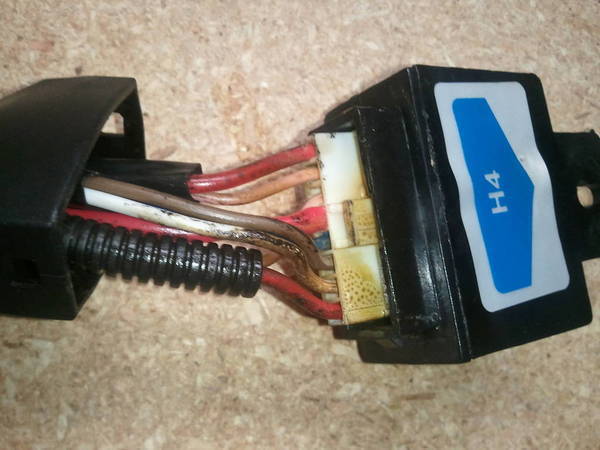

    Hey guys, I’ve had my DDM HID kit (Hi/Lo 55w 6000K) for a few months now and haven’t had any problems up until last week. I know some people have had issues with DDM but I couldn’t find anything like this. The first thing that I noticed was the passenger side would turn off randomly. Turning the lights on and off really quick usually solved this problem and powered up the light. Then a couple days ago I went to work and noticed my lights were on and stuck on the HI beams. I couldn’t turn them off even when I turned the car off.. so I unplugged the harness from the ballasts to cut the connection and went about my day. When I got home to look at the lights I detected a faint smell of burnt plastic and noticed that the housing on the harness was melted inside with residue all over it.. wtf. I’m less than 10 miles from work but is it possible that the high beams overheated the harness?? DDM is def getting an earful from me. What I haven’t decided is if I should just get my money back and go another route, or take the replacement harness… Anyone experience or heard of anything like this?

    I had something like this in my truck. When I first did the install the box totally burnt up. DDM replaced the box and that didn't work so they replaced the whole harness. I've had friend use DDM HIDs before with no problems. But as for me, my next kit is coming from retrofit source.

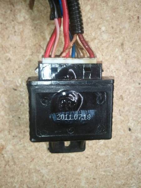

    its a crappy harness/relay many kits used. i had one go out on my gfs 55w kit luckily mines still working. they are not sealed and get water in them and short out. always seal the relays before installing

    My driver's side is the one that went out, and the p/side didn't. I installed them so the Relay and ballast on the P'side were on the inside of the fender wall, but the d/side ones were installed on the flat surface below the battery. Very likely that water pooled there and shorted mine out!

    the relays do get pretty hot sometimes but it could be just the connection to the bulb or the bulb or the ballast, but prom the pic its the relay. i just installed my 3000k 55w bi xenons and only one side worked and no highs. i had to manually bend all the pins to get a tighter fit on everything and now everything works. also dont forget to put some high temp grease on the bulb itself where it slides. take them apart they are very simple, all it is is an electro magnet and a spring. just lube the sides up and throw them back in and they will never stick as they do when they get older

    I just had the exact same thing happen with the exact same lights. I opened the actual relay casing and everything was ruined. I'm glad it didn't start a fire.
