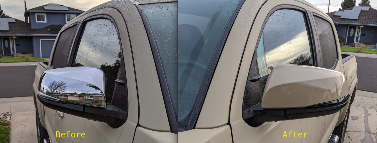

  19. Jan 12, 2020 at 5:01 PM
    #19
    ll_coolray
    ll_coolray [OP] Well-Known Member
    Dec 1, 2019
    #312188
    81
    Ray
    Rocklin, CA
    '17 Quicksand Taco LTD 4x4
    Swapped out the mirror caps this morning. So easy, took about 10 minutes total. While I was in there I dropped in MESO customs blackout turn signals. Really subtle change but I'm in love.
