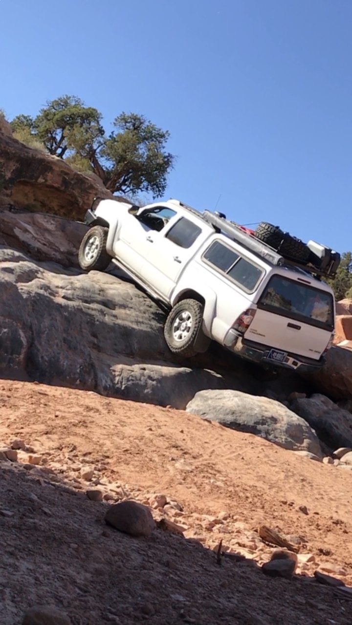

    Not a second gen issue. :crapstorm:

    Careful not to break that frame!

    :rofl:
    Good come back.
