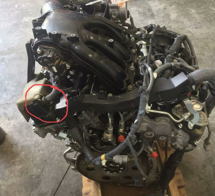

    The issue is that the PCV valve is at the rear of the driver side valve cover. The oil on the valve train returns to the pan at the front of the cylinder heads. On a steep incline the oil puddles at the rear of the cylinder head and the PCV system pulls that oil directly into the intake manifold. Depending on the amount of oil the engine gets down the manifold you are looking at anywhere from light smoking to a hydro locked cylinder. A catch can would help with this issue until it too becomes full of oil from both the incline and the manifold vacuum. The passenger valve cover is vented just forward of center on the cover just for reference. A direct drain line to the sump just after the PCV valve or a oil return galley drilled through the cylinder head and block would be a true fix for this issue.
    Rear view of 3.5L PCV valve location circled.
    Passenger side 3.5L valve cover vent location circled.

    A catch can won't help in this situation !!!! , basically what's happening is oil is pooling over a valve spring at the rear of the cylinder head . This pooling of oil is to much much volume for the valve stem seal to keep oil from being sucked down the valve guide
    So the result is oil being sucked into the cylinder ea time the piston is on it's intake stroke and creating oil smoke upon the exhaust stroke

    OK: How is a 2nd gen 4.0 V6 different? The PCV valve is (also) located at the rear of the driver side valve cover. Assuming the return drain is at the rear of the head?

    Agreed a catch can is only going to give you a little extra time before it starts to do the exact same thing. Once the catch can fills up with oil the results will be the same.

    The valve is located at the rear on a 1gr but it is baffled on the inside of the valve cover to a location near the front.
    The 2gr fks drivers side valve cover baffling is at the rear of the cover.
