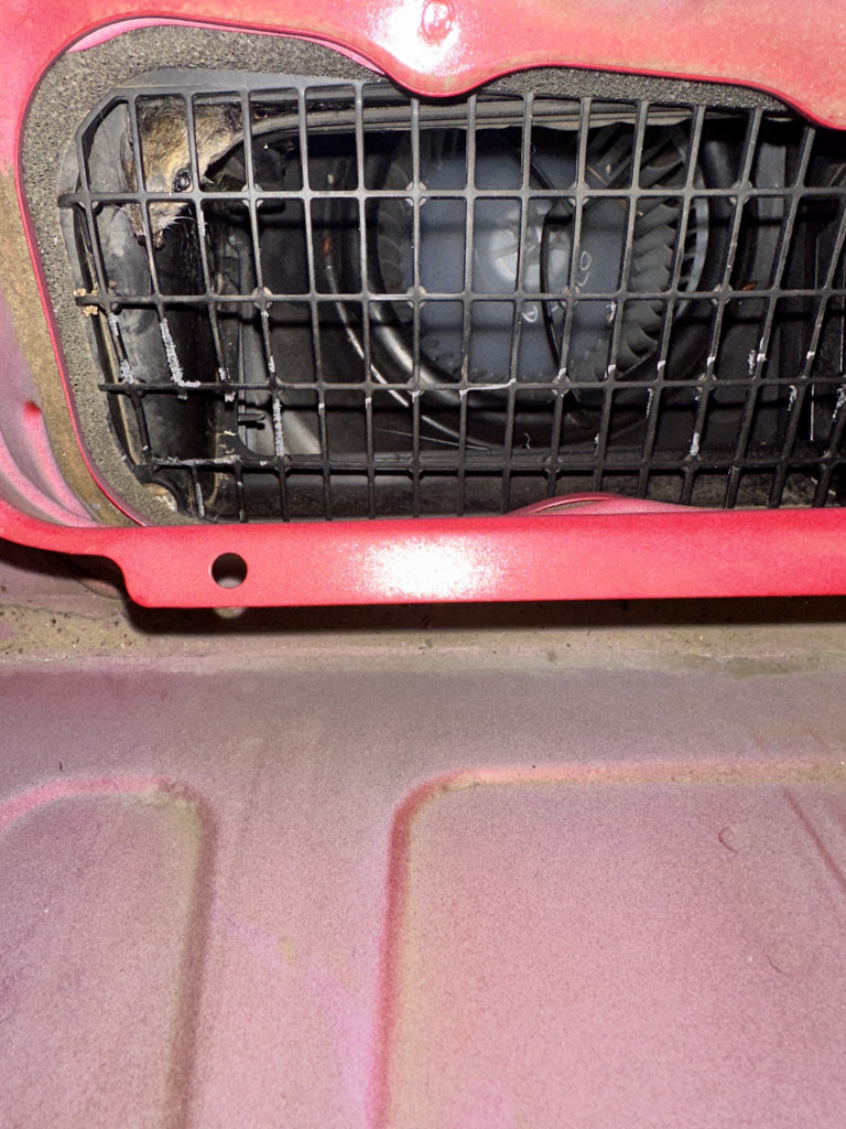

    I would check the air filter / box, I would pull the wiper blades and cowl off, pull the glove box out and look around inside the dashboard. Good luck.

    This^^ cabin air filter area, if the blend door was open then it coulda gone deeper into the ducts.

    Cabin air filter box makes a great final resting place for mice.

    This thread, big time. All three tacos I've eaten (lol) literally the first day home this is the first thing I do. We have horrible mouse problems where we are at. And also the engine air intake under the right front wheel cover -> OP, I'd recommend doing this too right away as since they found the cabin inlet, the might have found the engine inlet and heading towards your air filter box.

    Thanks for all the responses. I did find and follow the thread referenced above. I did have to remove the wind shield wiper arms, as the cowl on my 2017 can't just be lifted up a bit to get to the air intake. Interestingly, my truck had a hard plastic screen over the air intake from the factory. But the mouse was able to get in anyway. This is the one picture I took, you can see the factory screen in place, and the mouses head where it got stuck between wall of the air intake portal, he got his head stuck, ,and died. I cut out the factory screen, and then managed to get the mouse out. No blood, guts, etc.. I went to Lowes and bought the same rain gutter leaf guard screen as the guy in the thread referenced above, so hopefully I won't need to do this shit again....
