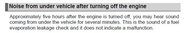

    For what it may be worth?
    Yesterday I heard a strange noise coming from the truck (it had been parked for a few hours). Searching for the noise, I'm pretty sure that it was coming from the E-Vap Canister. I believe that the pump was running? I have a post in the Technical Forum questioning if others have heard this? I was slightly concerned with current draw on the battery.

    This is explained in the manual. It happens about 5 hours after being parked. Completely normal operation and will not draw enough to kill the battery.

    This only happens once five hours after you shut the vehicle off. It won't occur on consecutive days that the vehicle has been sitting parked.

    That is a normal scheduled operation in any modern vehicle. It has to happen a certain number of hours after the vehicle is shut down. The pump will draw current while it is running, but this is expected and the battery can handle it. It only happens once after turning off the vehicle, so it does not happen again if the vehicle is parked for several days.

    This is normal on all vehicles now. The purge pump is low draw and only comes on for a short time anywhere for a few minutes to a few hours after shutting of the engine.
