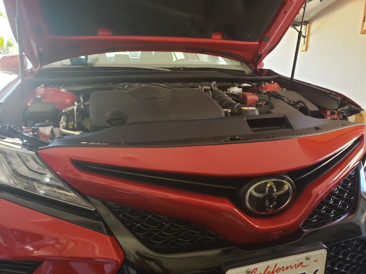

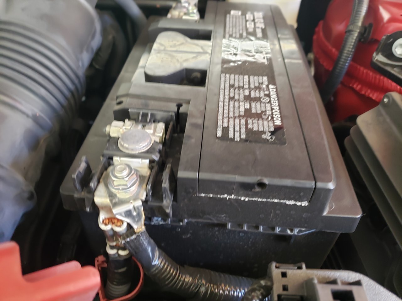

    Wrong. I gave my wife's 2019 Camry it's first engine oil/filter change today and noticed the 2 month old OEM battery is already starting to seep corrosive acid and turning into the white stuff:
    If left alone it would eventually reach the battery tray and begin corroding it. This is one of the reasons I hate lead acid batteries and ran lead calcium batteries before the AGMs became available.

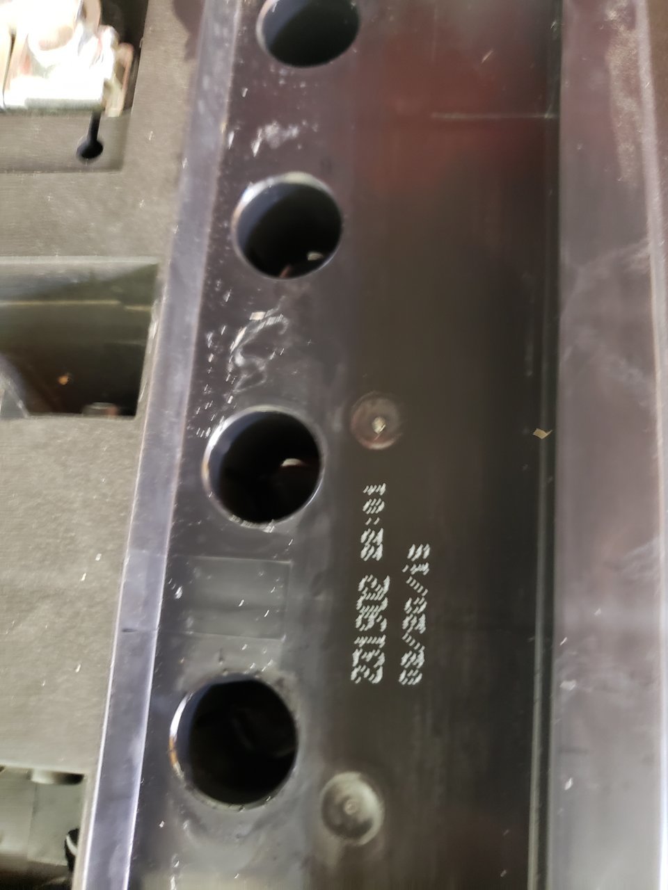

    Popped the cap and I noticed some cells were low and carefully added distilled water, taking care not to overfill it. Note the battery is dated/stamped 02/20/19.
    With more and more AGM batteries becoming available I will be replacing this $hit battery from Toyota very soon. It's not worth my time or my investment to wait until this battery craps out on me or the wife, then have to call the dealer for a tow only to have them reinstall this garbage.
