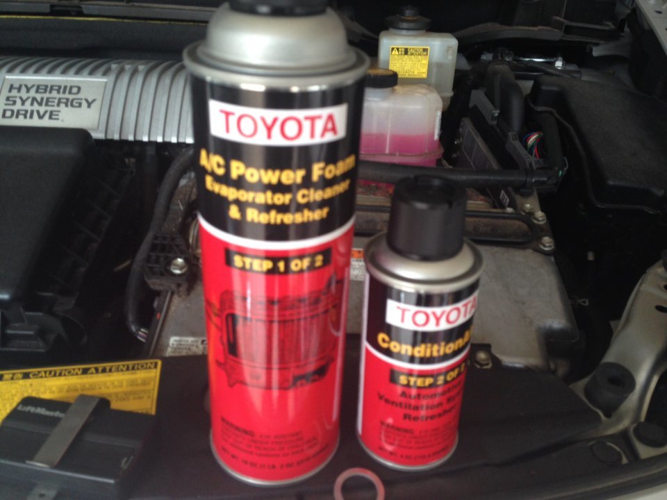

    Op, run to your toyota dealer and buy some of this.
    Part # 00289ACRKT
    Should cost you no more than $35.
    On the main can, you dont have to disable the ac and all that crap.
    Simply get a drain pan, shake the crap out of that can, insert the tube into the ac drip line, start spraying it in. The key here is slowly. Don’t go full trigger press, I have found that spraying this stuff slowly it works the best. Once you empty half the can, do NOT pull the plug out of the drain tube. Take the top off the can and set it in your drain pan. This stuff is real nasty and it will make a mess if you just pull the plug out of the drain tube. Repeat steps for the second half of the can, then follow the instructions on the can for the final steps. The small condition air can is straight forward, just follow the instructions on the can. This will make your air vents smell like a new truck again.
