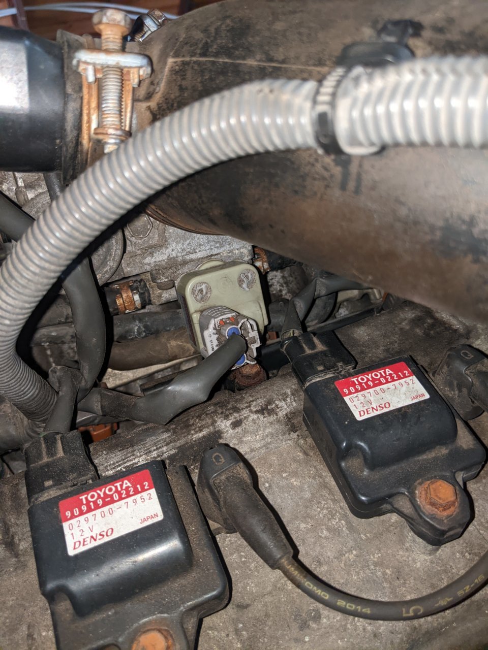

  12. May 29, 2022 at 3:05 PM
    ztwatson
    ztwatson Well-Known Member
    Dec 6, 2021
    #383995
    999
    Milwaukee, WI
    2004 Tacoma TRD Xtra Cab
    The idle air control valve. It regulates your idle when not driving. When mine was not properly connected the truck ran very rough at idle, mostly fine otherwise. But I would just check that the electrical connection to it is snug. Easy to get to, over on the passenger side next to the coil packs. Shown as the grey connector on this pic.
