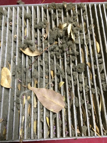

    circling back around... that mesh in the engine compartment, just in front of the windshield wipers is indeed the cabin air intake?

    In order to see the actual air intake the black plastic cover has to be removed. Under it on the passenger side there is the actual intake and it is not covered or have a mesh over it. Just a big old hole going straight into the cabin air filter area.
    A rodent can get there via the fender well area with no issues. You could remove the black plastic cover and install a mesh cover over the intake which would prevent a recurrance. Someone on here did this before and has pictures. I'll see if I can find a link.

    IMO if you are having an issue with mice getting in, a cover as shown in the picture I posted should be adequate to keep them out. I wouldn't consider that a constriction. I would install a good screen mesh as shown, using copper if it could be found as mice do not like copper. Stainless steel would also be a very good material.

    Ah-Ha! I was fooled by the plastic cover. There is a grate in this cover, which looked fine. I'll need to get something over this wide open hole.

    Just swapped mine last night and it looked disgusting. Anyone else have foam deposits from the inside part of the housing right above where the filter goes? It's a little concerning to me.

    Guarantee those foam chips are from a mouse chewing the foam inside your engine bay on the firewall. Check it out. That's how I found out I had a mouse and discovered the little bastard had built a nest in the air intake that the OP discovered. They like the foam. Probably soy based or something. Toyota should have covered that intake better. I might make a screen this spring to prevent it from happening again.
