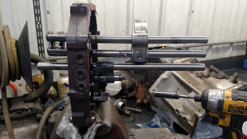

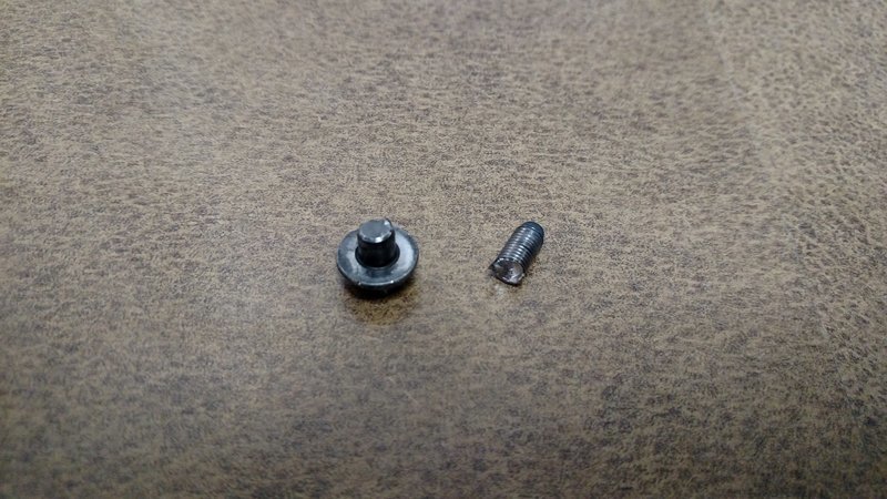

    And the culprit is a small bolt that holds the shift fork to the 2nd gear shift rod. My synchros, bearings and input shaft are all pretty used so since it's apart I'm gonna have them replace. IMG_20160914_115636494.jpg IMG_20160914_112401585.jpg IMG_20160914_115636494.jpg IMG_20160914_112401585.jpg

    One thing the guy at the transmission shop said is that it looks like my trans has been opened up before. I wonder if they replaced the shift fork and tightened that down to much. I can just wonder. Now - I will have a new transmission!
