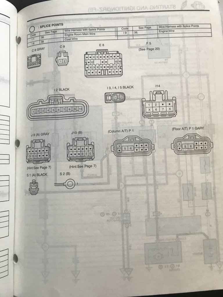

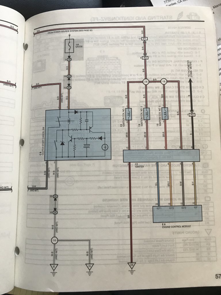

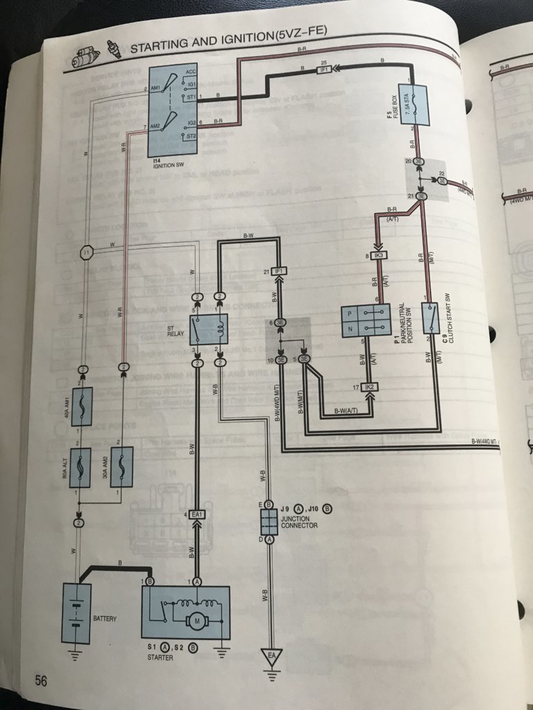

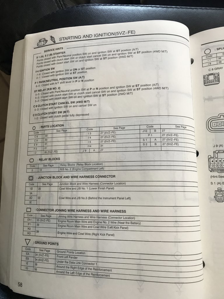

    The last 2 pages arnt really necessary unless you have an odd ball problem
