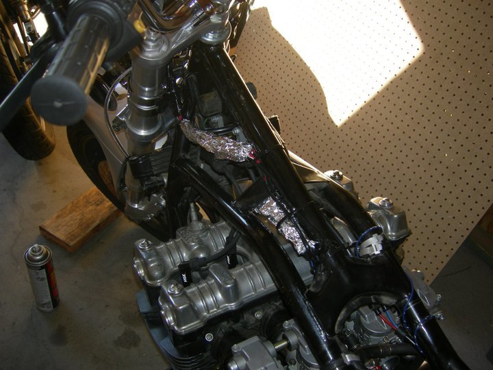

    I havent read through the rest yet (which i will in a min) but i have had HID ballast(or somewhere between ballast-bulb) interference in the past on my motorcycle. It affected my oil pressure warning light and ignition. Once when i stalled the bike, light was killed which did not do any other damage to by bike. After that I dont know if it helped but i wrapped my headlight wiring in aluminum foil.lmao
    However since this is DC system, only problem i can think of is shortage/ overload/ inductive voltage somehow, but who knows...

    Gladiator
    And did the foil wrap help?
  9. Oct 5, 2016 at 8:16 AM
    #249
    krzysnwbrdr
    krzysnwbrdr Well-Known Member
    Sep 26, 2016
    #198247
    220
    Masaki
    2016 Black Tacoma TRD Sports DCLB
    It seemed to help but i only had problem once, so im not 100% sure if it was caused by it or not.lmao
    But there was definitely a noise and got better a little
