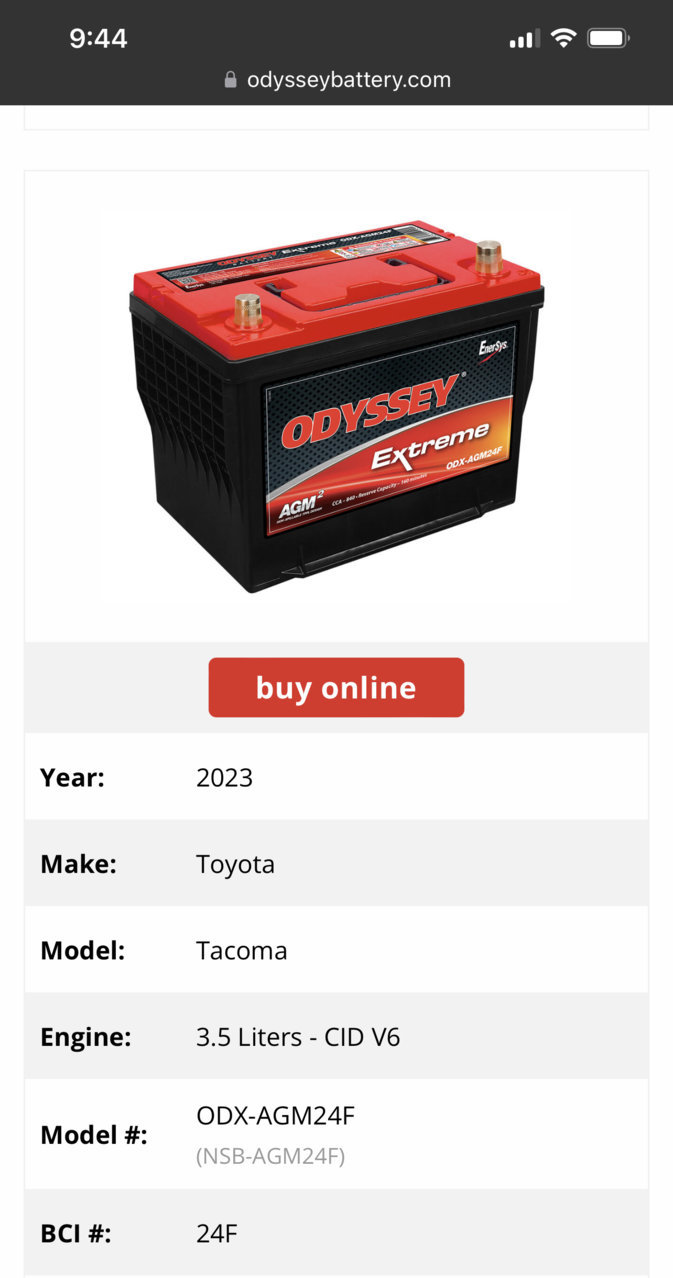

    Or Odyssey AGM if you run a lot of lights, ARB fridge, etc
