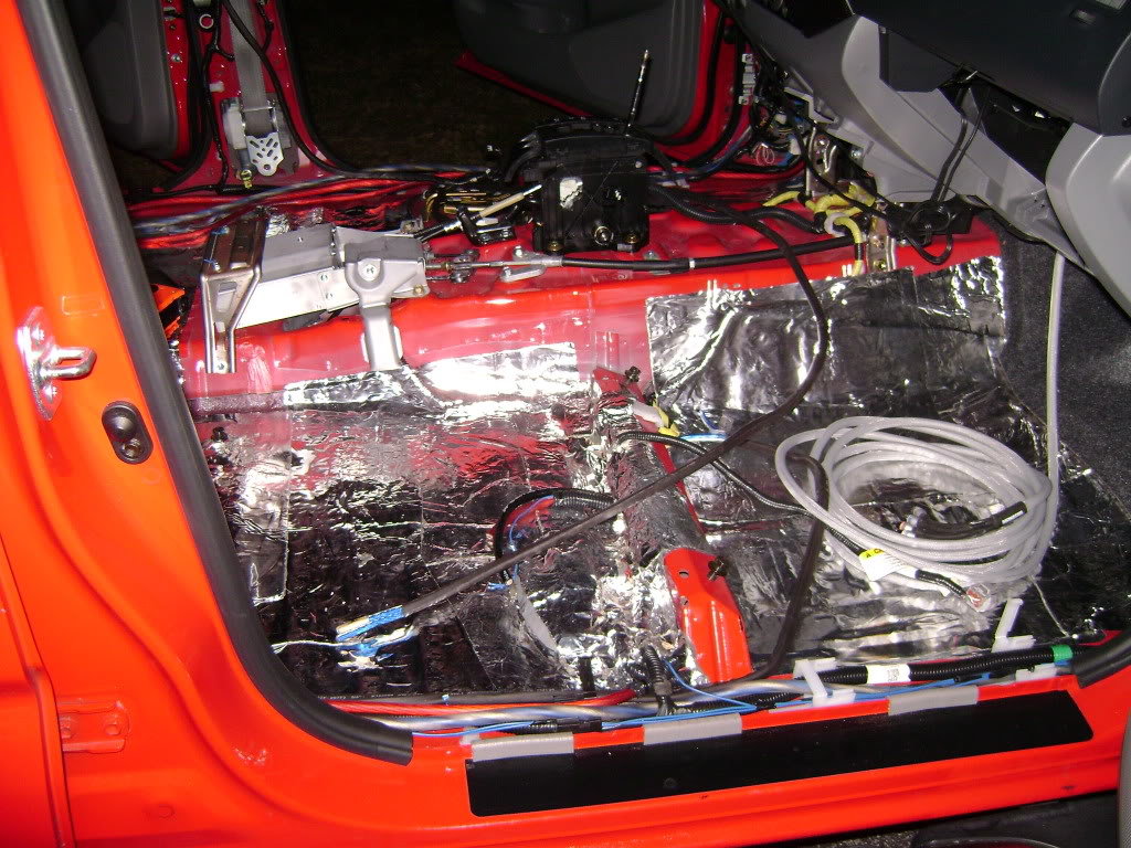

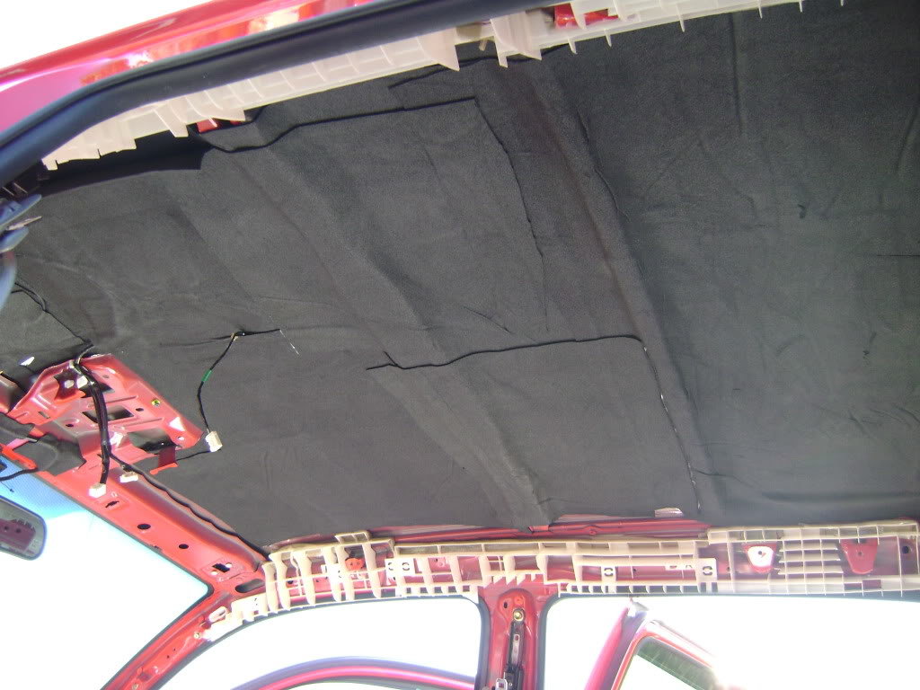

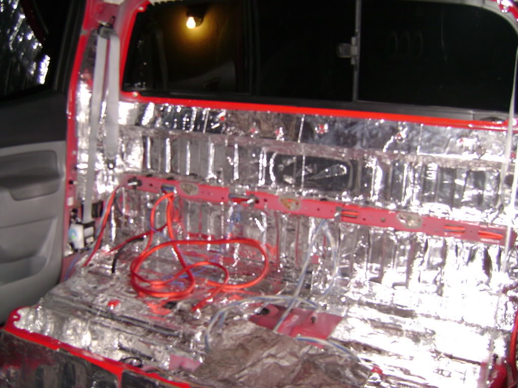

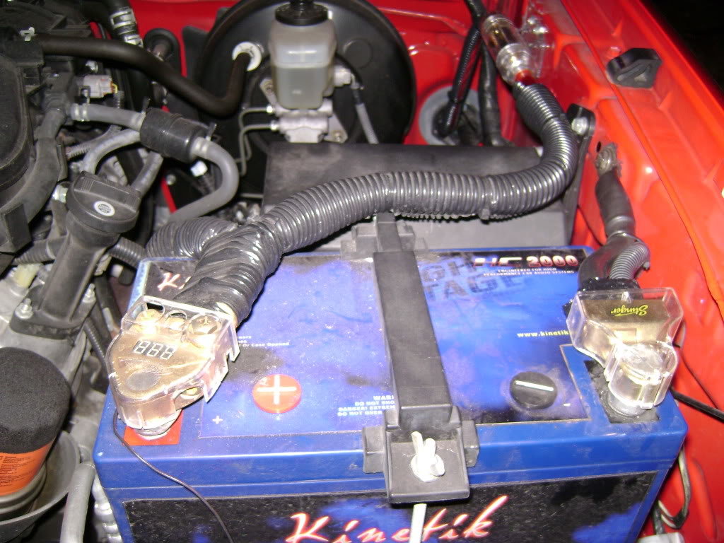

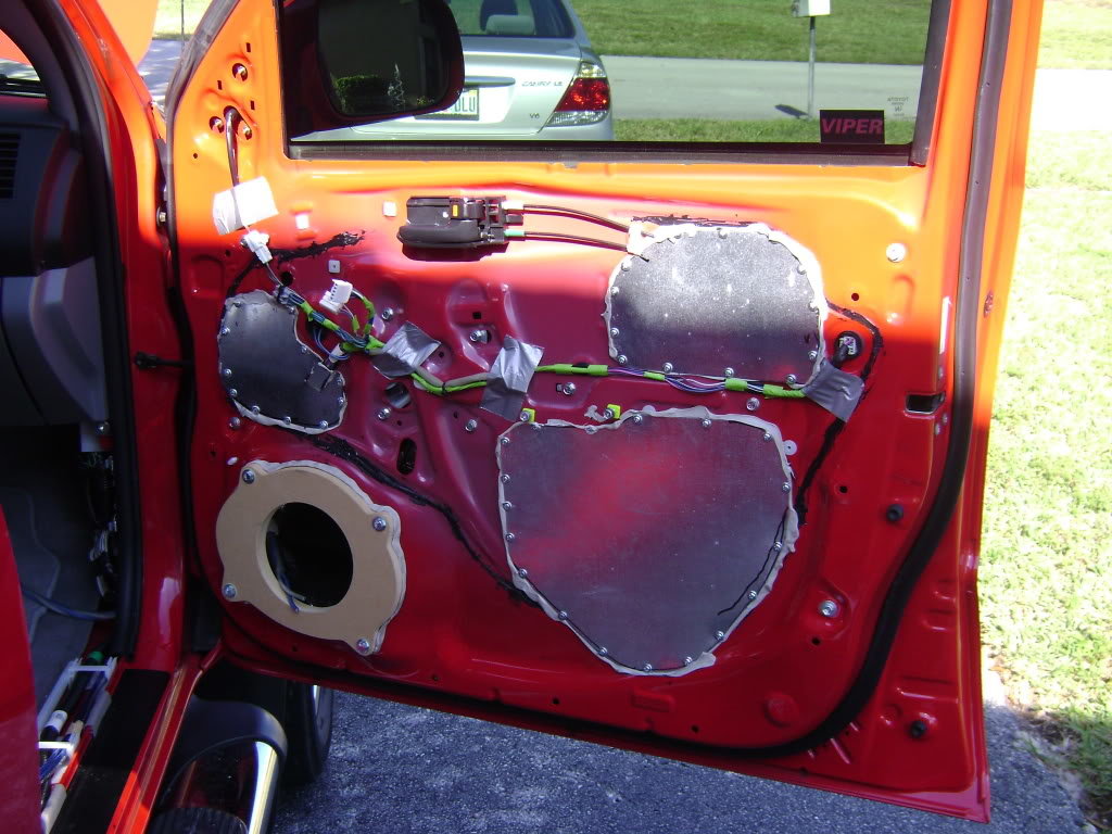

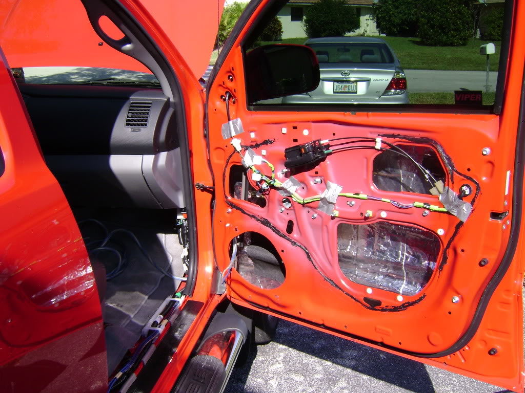

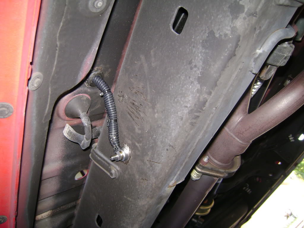

    I started by installing the kinetik batter, 0 gauge battery ground and engine to chassis ground, alternator to fuse box and fusebox to battery. I elected NOT to install a lead directly from the alternator to the battery, so I guess you couldnt call this the "Big 3"...but at max volume, AC running, dome light on etc.. my headlights do not flutter :) ofcourse it helps that I have the 130 amp alternator compliments of the tow package...

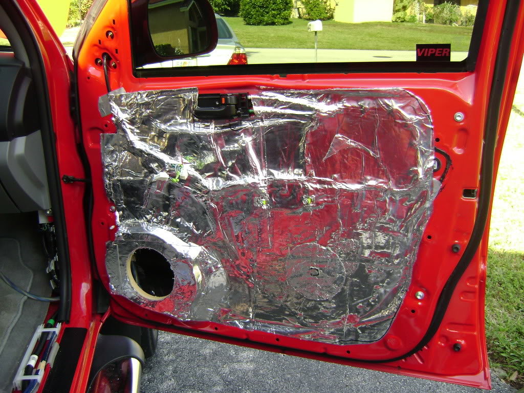

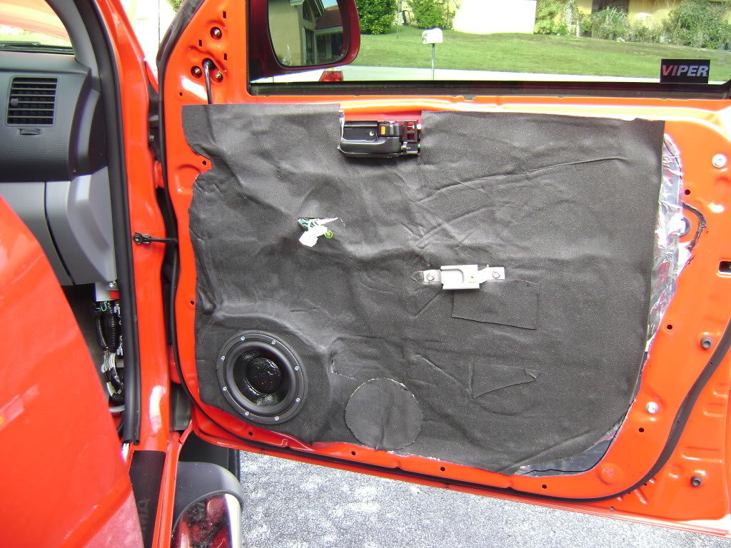

    Once my fab work was done, amp rack prewired, everything on hand...I began with the doors.
    Ramaat BXT-II 120% coverage outer skin, 120% inner, and ensolite.
    all access holes sealed with butyl tape and 22 gauge galvanized. baffles bolted using 1/4" hardware.
    all 4 doors done the same way
    minimim 1 layer of ramaat and ensolite on floor...250% coverage on roof and rear wall.
    Very pleased with the ramaat product, and Rick is the best...unless your un a hurry to get of the phone and get back to work...lol...

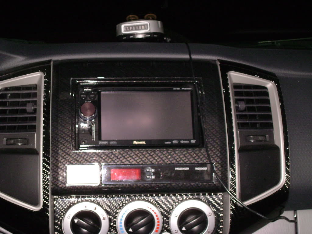

    I hid the GPS antenna behind the drivers side A-pillar with very little effort...my signal is perfect.

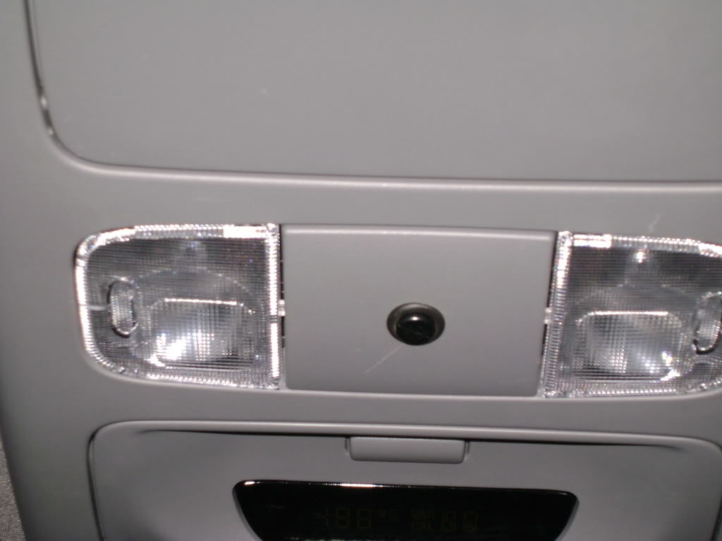

    I put the microphone here...note the 1 scratch I have yet to fix...which I actually did later when removing/reinstalling the mic after I had to perform the compass/temp mod repair due to a poorly soldered transistor :(

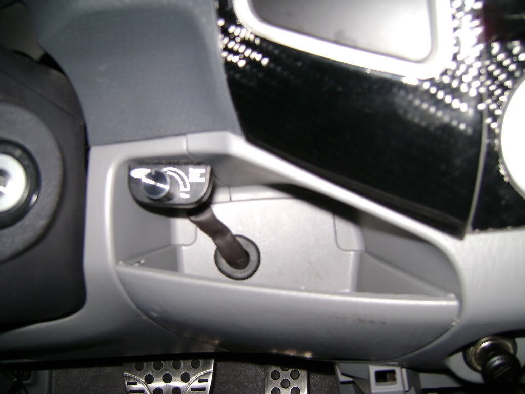

    The sub bass control went here using super duper Home Depot velcro...I was pleasantly surprised how secure it is...

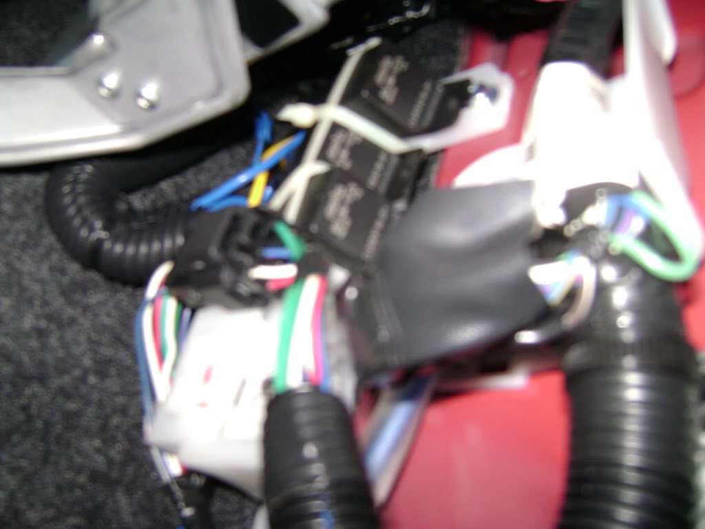

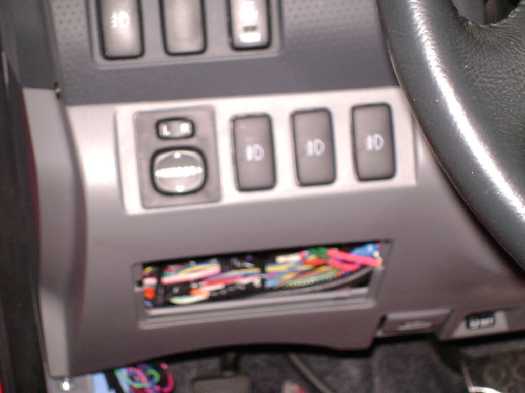

    purchased/installed 3 factory fog light switches as amp remote switches
    1 controls midbass, mids, and tweets (front stage)
    1 controls rear mids and tweeters (rear stage or fill)
    1 controls sub amp
    all 3 switches run to relays installed near the passenger kick panel area...

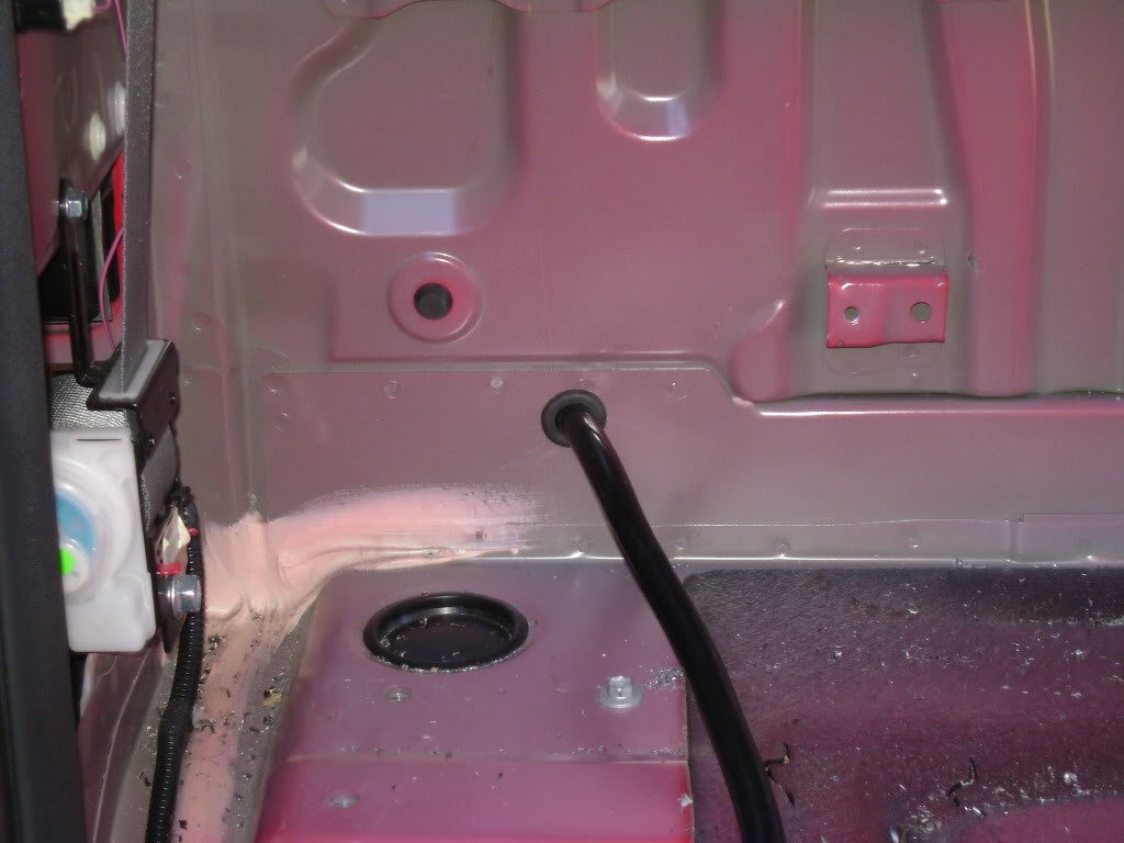

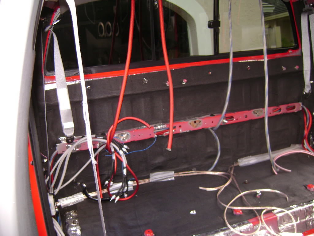

    Its been a few years since I installed a system this "complex", so I spent time on details like grounds to avoid stressfull trouble shooting and alternator whine down the road.
    Each amp located under the front seats has and independant 4 gauge ground which runs through the floor (and grommet) and to a JL ground lug wich is bolted driectly to the frame of the truck.
    The "main" 0 gauge ground that feeds the streetwires block at the rear runs through the back wall, and also directly to the frame. My longest ground is approximately 14".

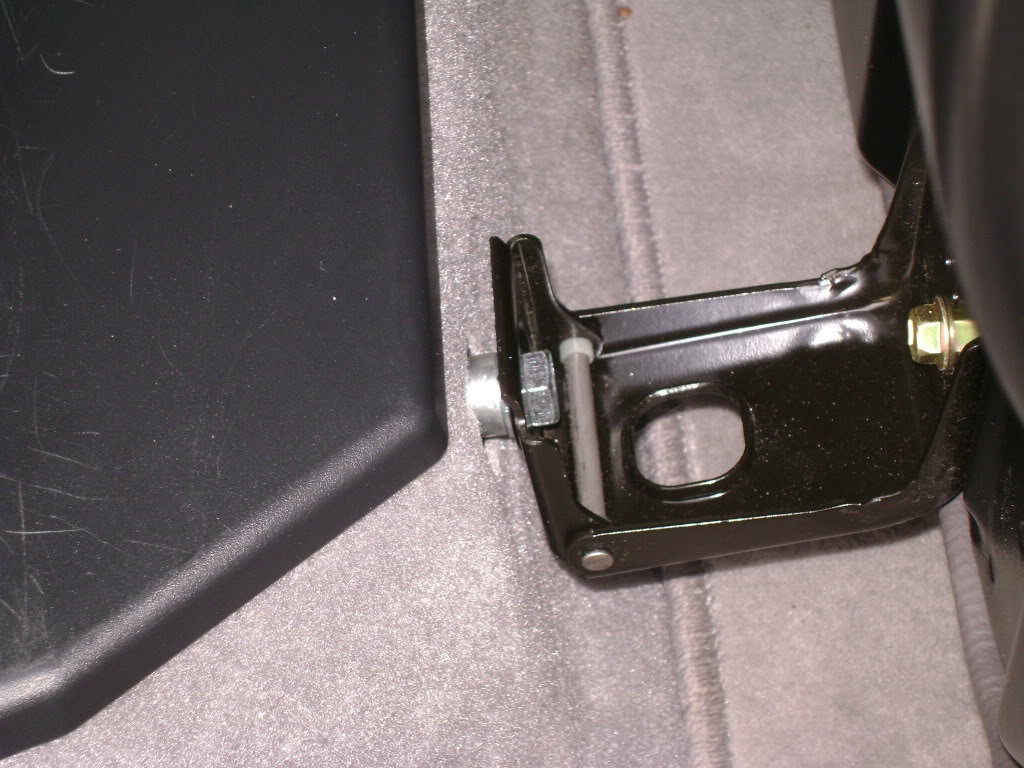

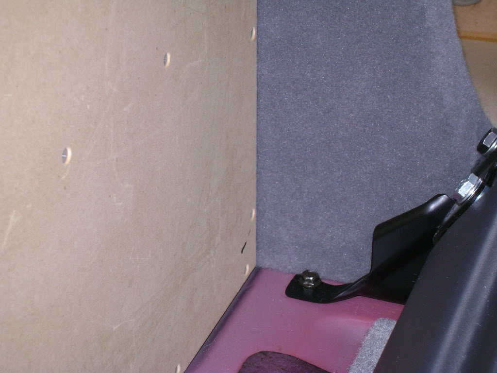

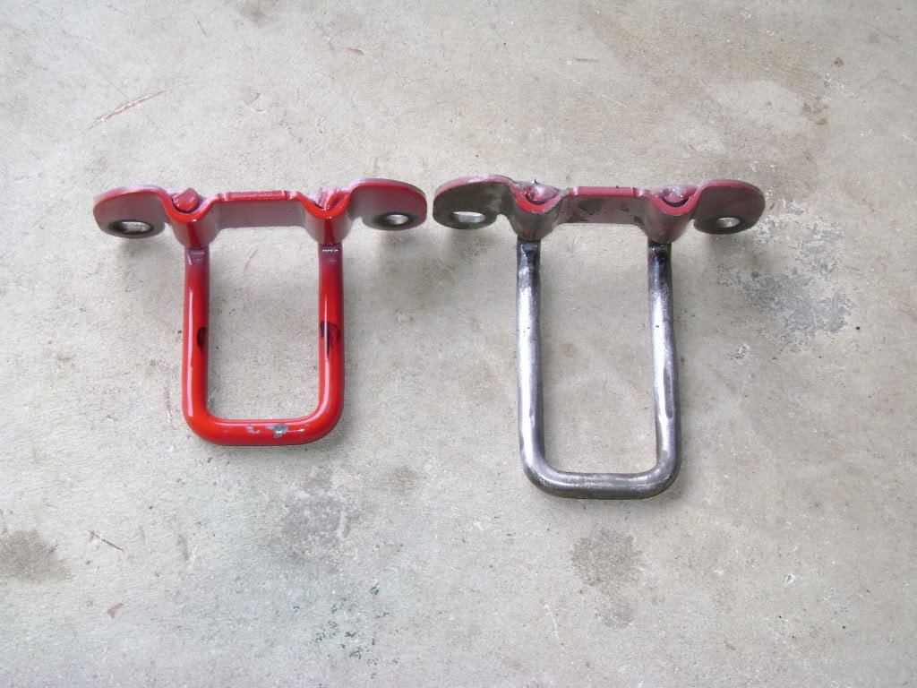

    like most, I didnt like the idea of loosing the plastic seat backs or not being able to properly deaden the rear wall in order to allow adequate space for my sub enclosure...so after a a few days of experimentation I was able to move the back rests forward 3/4" using spacers and longer bolts, and the seat bottoms forward about 1/2".
    I then removed and extended the rear seat "latch" catches using 5/16" round bar and tig welding...although those without a welder will be happy to know the rear seat backs will still latch on the OEM brackets after being moved...but I wanted a full 3/4" of additional room top and bottom...
    I previously posted more info on this here on another thread...I will post that link later for those who may want to consider this. It was the best decision I made, as I was able to deadend the hell out of everything, keep my plastic seat-backs, and not rub my sub ;)
    I also notched the center seat bracket while I had everything apart...
