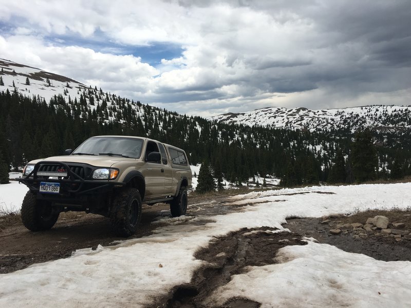

    Went to the Colorado Toyota Jambo... I just wheeled wheeler lake and knew that i needed armor asap

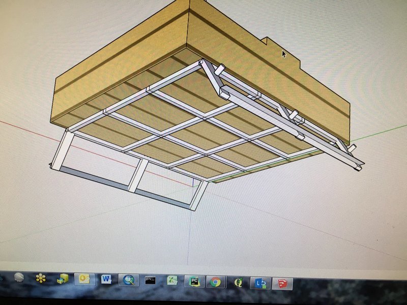

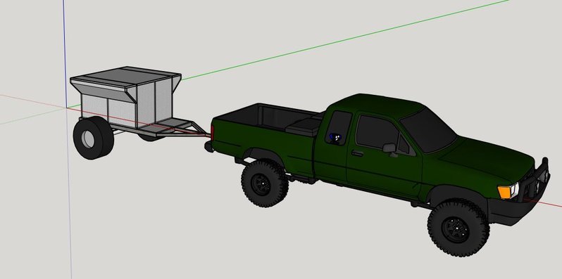

    Thinking about building an adventure Trailer... this is how far i got with the design today.

    updated trailer.... it is coming along should be sweet to have all my camping gear and a RTT on it.

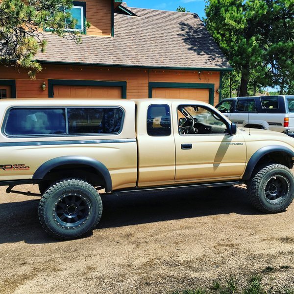

    Got my topper color matched to my truck

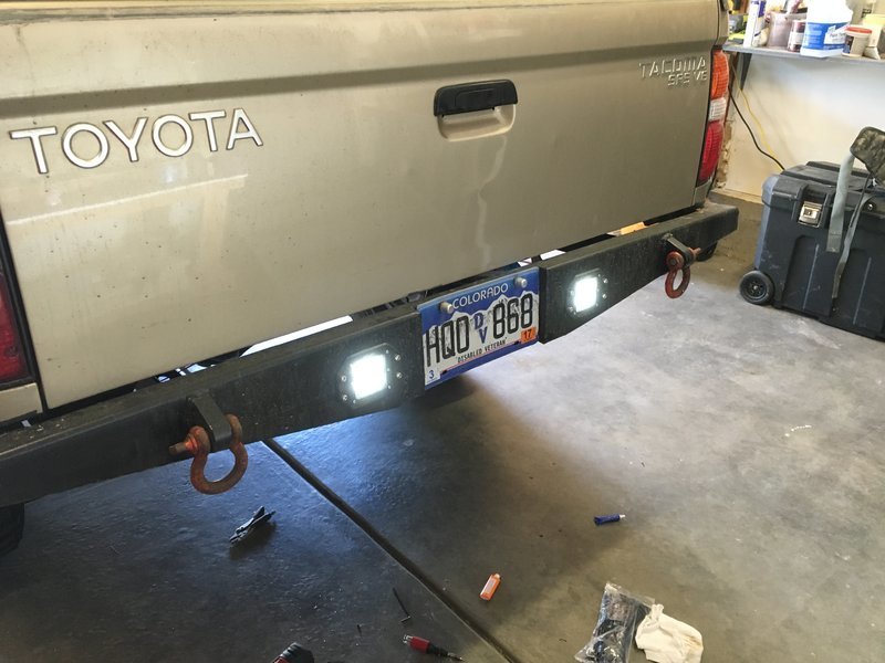

    Wired up and installed new reverse lights and waiting on my led light bar matching switch

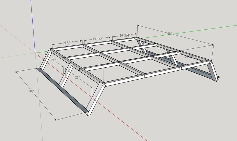

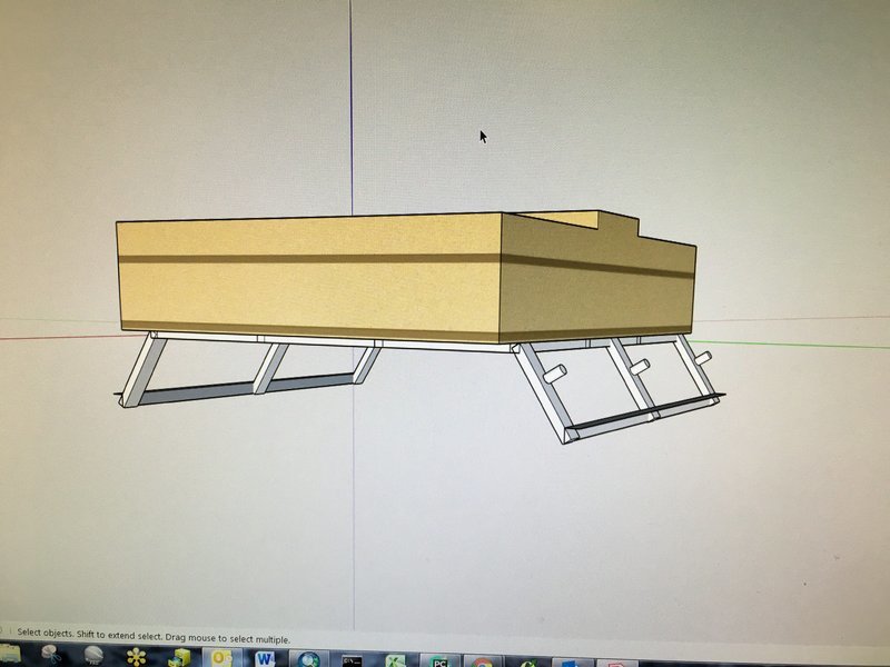

    Would you looky here.. Decided to design my basic rack today and pick up the metal. I took the dimensions from the Tuff Stuff RTT I ordered and created a rack (Much like box rockets) to hold the tent.
    My plan is to run the rack in the summer and the topper in the winter since Colorado it loves to snow.
    With my measurements the tent should sit even with the cab of my truck... Or atleast close. I will have to measure the real size of the tent when it gets here to determine the height.
    The plan is the build the rack next weekend when the tent gets here.image.jpg

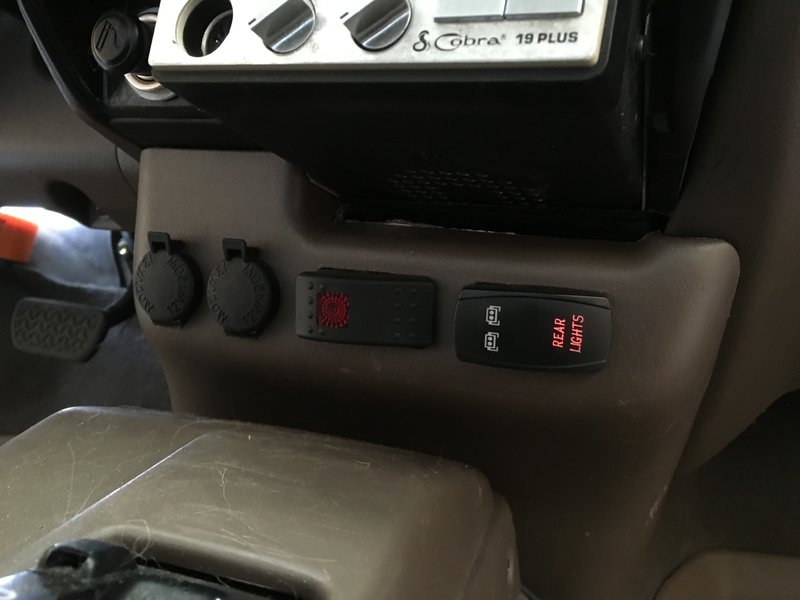

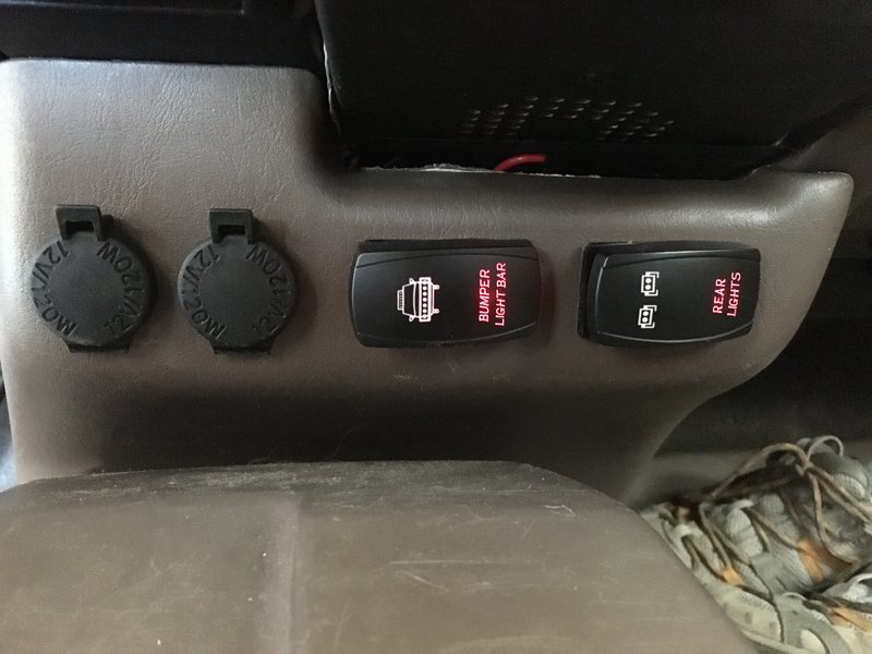

    New switches installed!

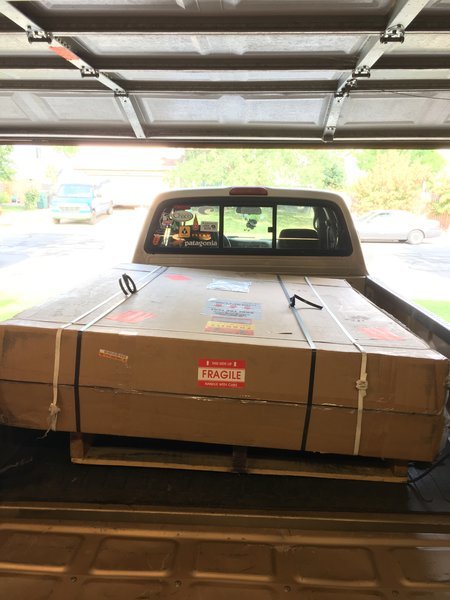

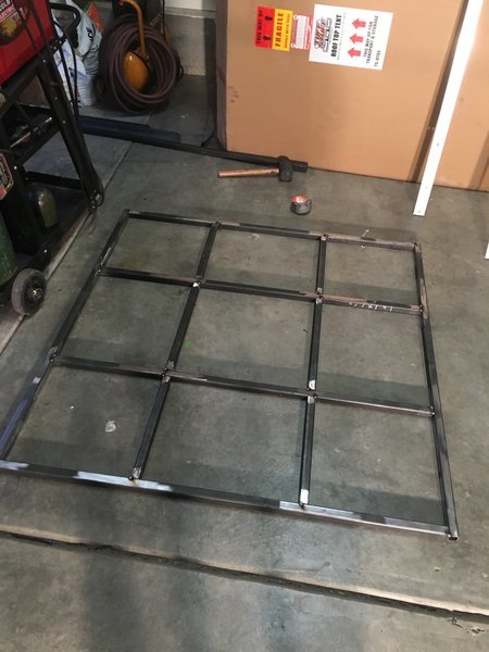

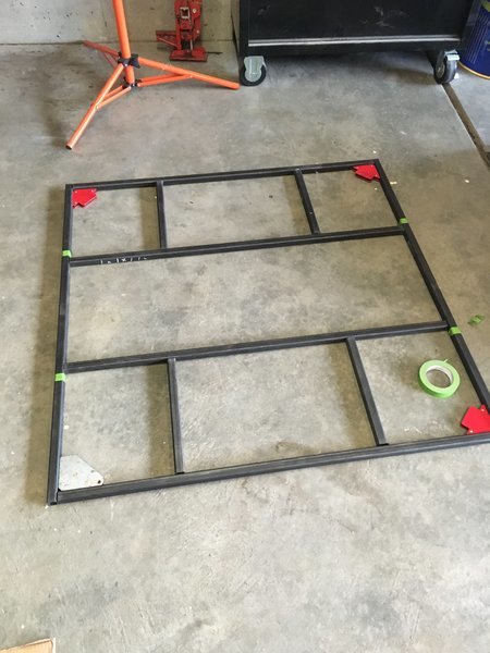

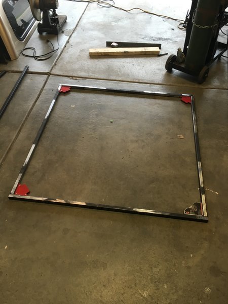

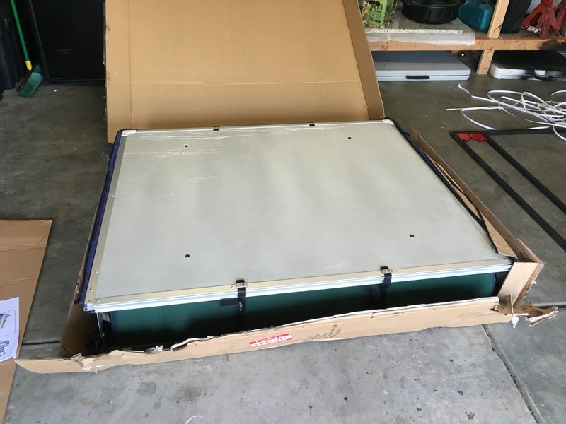

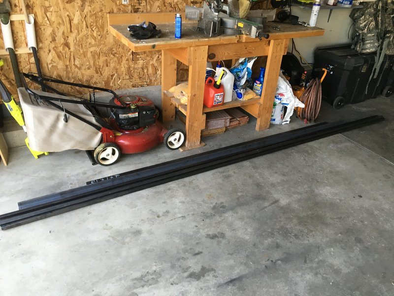

    Got my RTT today and started the rack!

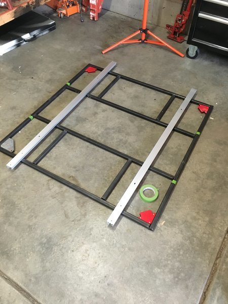

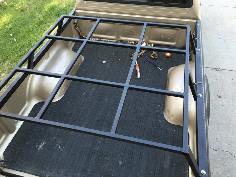

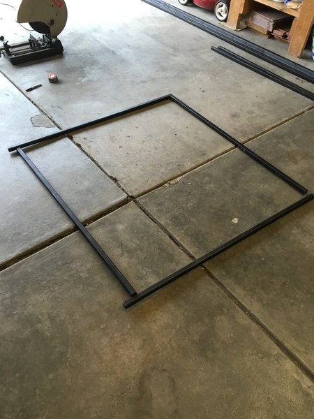

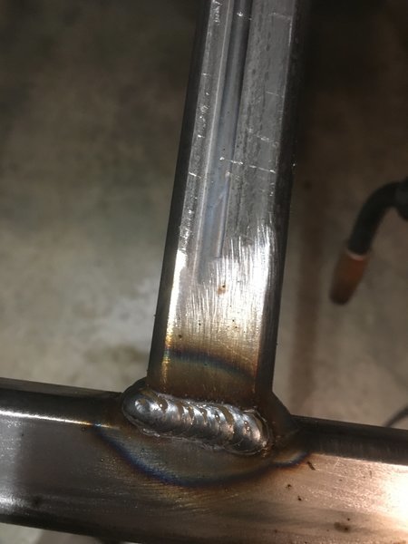

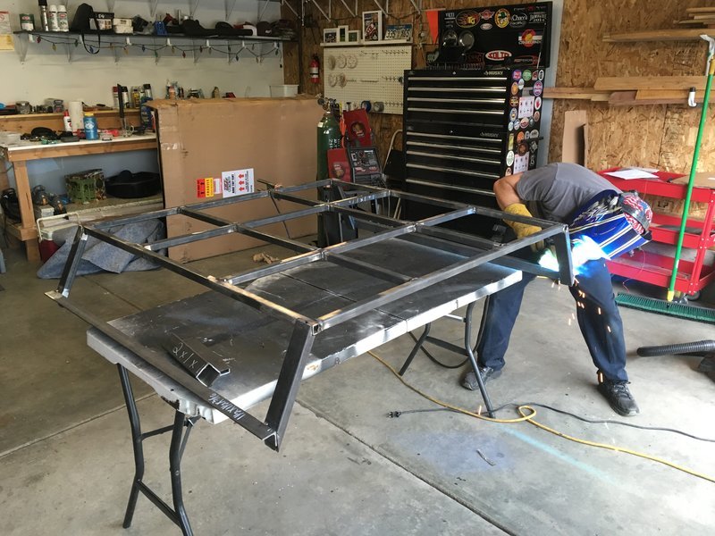

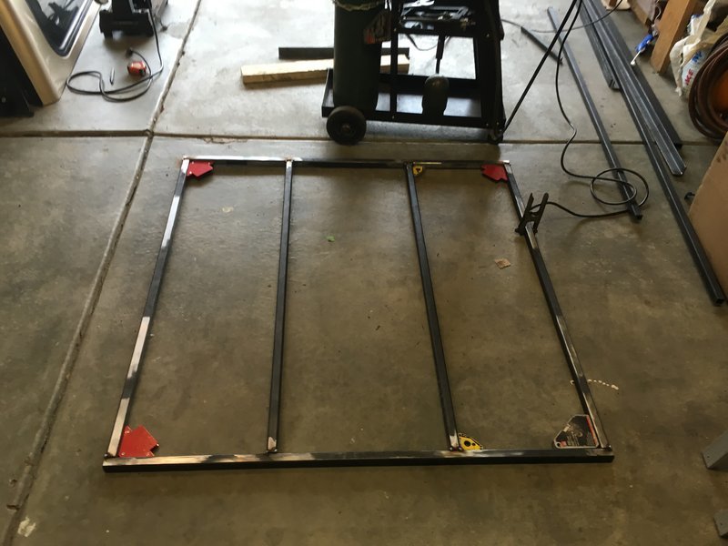

    Got some welding done ... Finished the main part of the rack......
    Tomorrow I should have it ready for paint! image.jpg image.jpg image.jpg image.jpg image.jpg

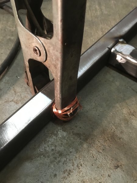

    Pro tip take some wire and wrap it around your ground... You will never have issues with grounds again

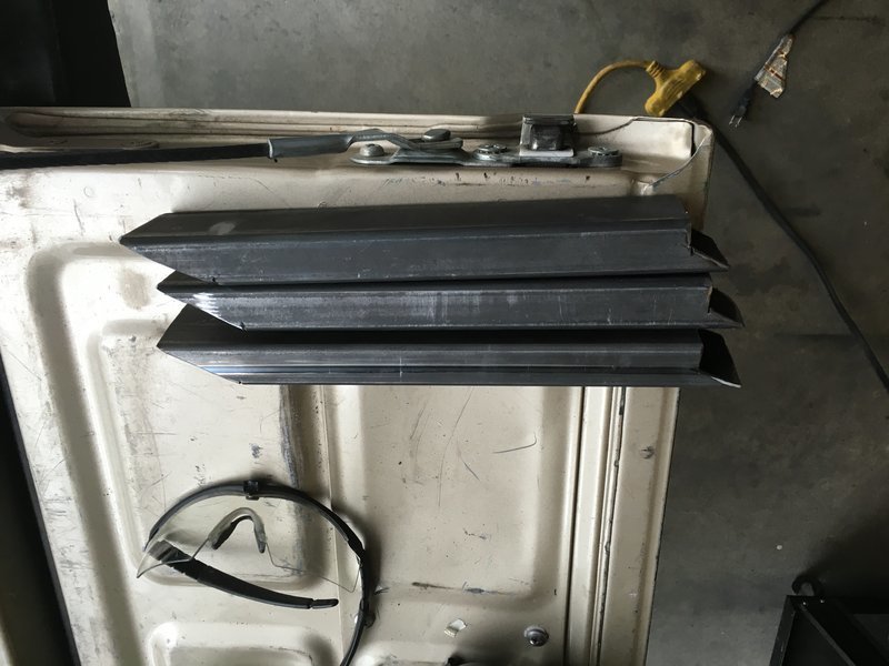

    Got 90% done with the rack!!! So excited to see the tent on my truck. I will be adding a highlift mount and some tabs to the rack... Then grinding down the top welds on the rack and painting it!!

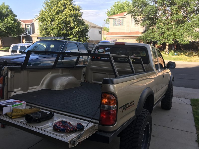

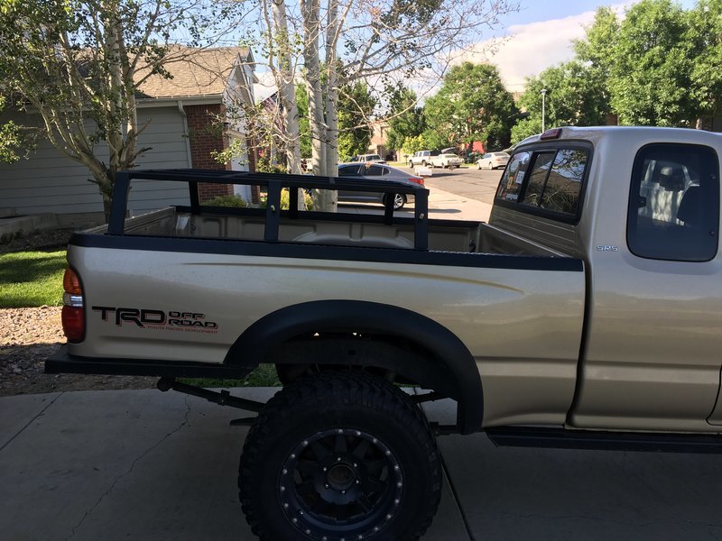

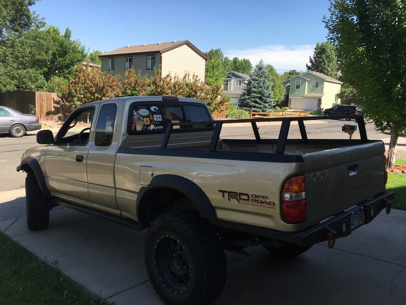

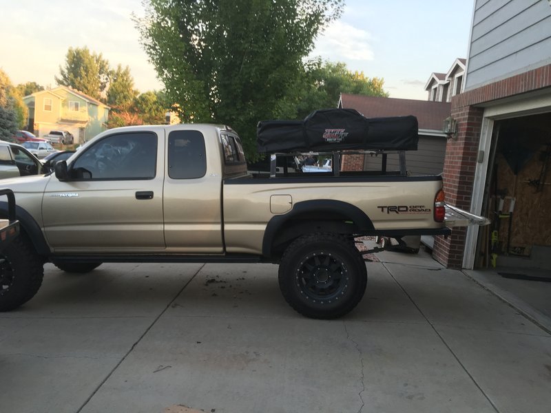

    Rack done and installed... I will prob add a fire extinguisher and maybe a shovel and ax mount opposite the holiday mount but we will see.
    Now I just need someone to come over and help me put the rtt on!

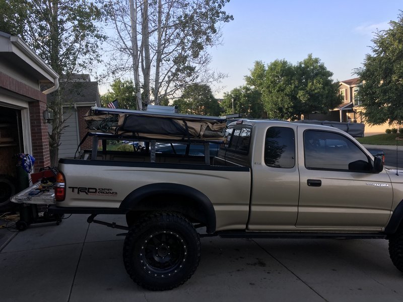

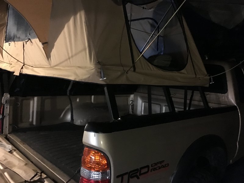

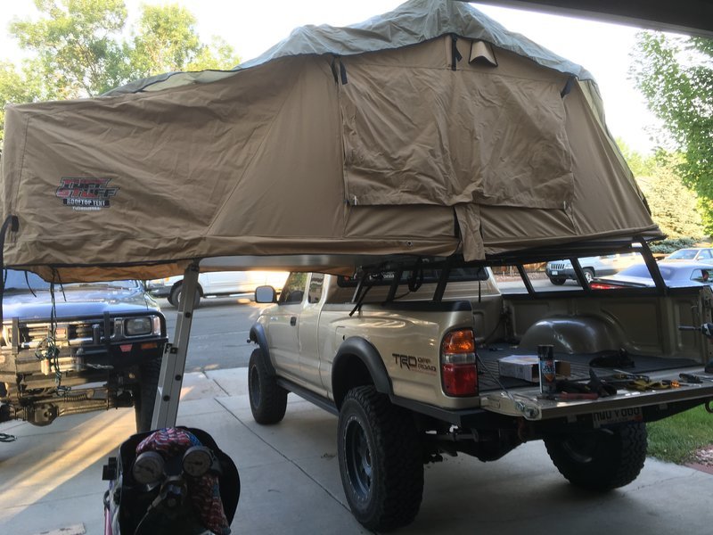

    First time in it! I was so excited and my rack turned out great I think!!! I will post pictures of our camping and exploring trip this weekend in the mountainsimage.jpg image.jpg

    It was fairly easy to build... the arms from the bed rail to the rack was the most difficult part ... if the rack was smaller (its 48x48") you could maybe just make 2 angled cuts rather than the multiple cuts and my crazy cardboard template lol
