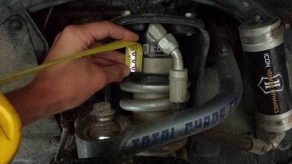

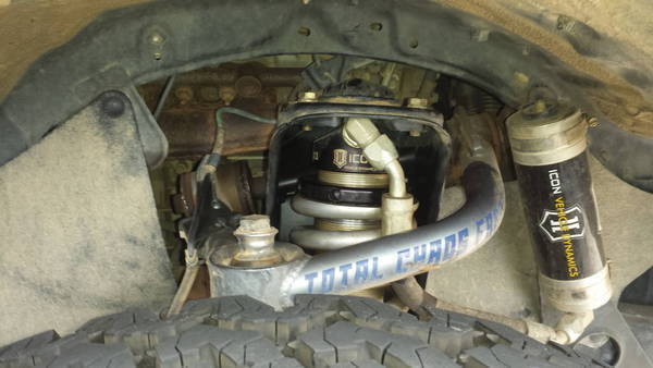

    Did a little tinkering today on the front end. Ended up taking around 1/2" of preload off my front coilovers.
    Before at ride height with horrible UCA angles
    After adjustment at ride height. Now UCAS are just about centered. Might take a hair more off, but we'll see.
    Not really surprising at all but the front is that much softer.Glad I finally did it!
