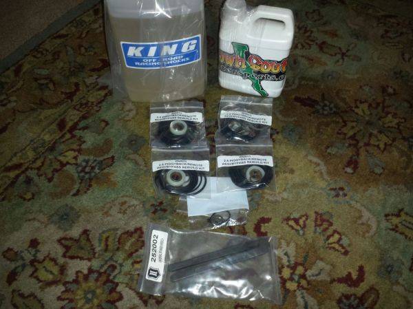

    Looks like I have a little project to do next week. Crossing my fingers everything goes smoothly!

    How much is the shocks oil alone?

    1 gal + 1 quart was $44 before tax.

    That's the "special tool" needed for the icons......almost cost as much as the oil. :mad:

    So you got a gallon and a quart for just your rears, or all four? Always good to have extra but I used maybe a half gallon for my rear 12" 2.0's. And the front coilovers were even less.

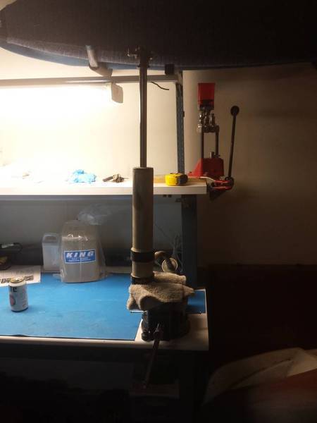

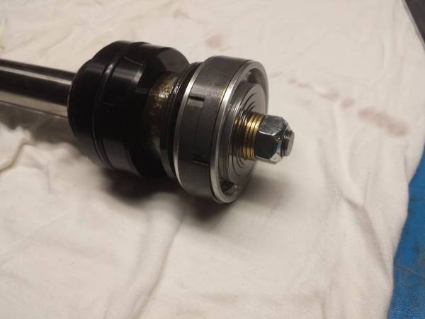

    Started this project tonight. And so far so good. Definitely a nice learning experience.
    Had to stop for the night though. Found that the shims that were shipped to me have a larger ID than what's already on the Icons. Icon shims are .435" ID and my new ones are .5". Didn't seem right, so I'm going to call up DSM tomorrow and make sure.

    My bad. Yeah, the Icons are .435" and the new ones are .5" ID.

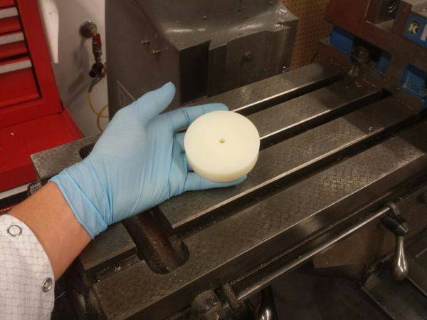

    spent a good amount of time playing with the truck last weekend and found that the new SuperBumps compress down to almost NOTHING when hit.......fortunately no damage. But it's crazy that these front bumps compress to a thickness way less the the stock bumps. :eek:
    Oh well. made some custom spacers at work out of UHMW. 0.745'' thick should stop me where I need.

    I didnt think they would compress down to nothing!! I mean, daaayuum!
    I had some down time at work so I turned them down on the lathe. Luckily we have tons of this stuff just laying around work. Should have used the black stuff we have but that would have been more work....and I was a bit lazy today.

    The shocks went back together flawlessly. I took my time with the first one, and after that the second one was a piece of cake! It's way easier than I expected. But I haven't had a chance to really test them out yet. They were hydrolocked so I can tell they're better already! Haha
    Now that I know what I'm doing I'm very tempted to buy a bunch of different shims and just keep changing things around until I like them. I finally found a spring compressor that will work so I'll be doing the fronts next weekend! Thanks for the help Marc!
