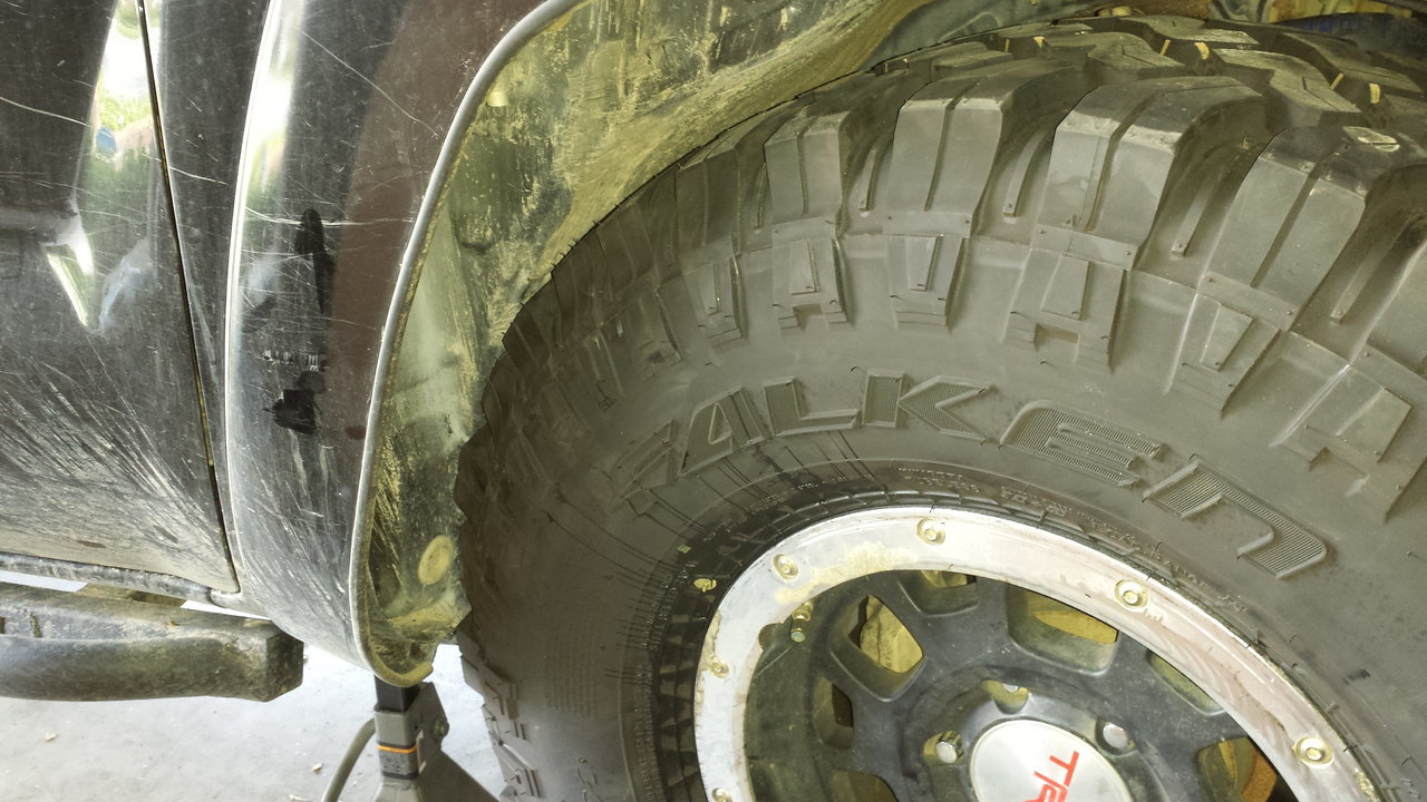

    Do the cooler for sure! It was super overcast this weekend and my tranny was over 200 most of the time.
    Also I rubbed the shit out of my tires on the firewall lol

    You are 100%right, barely any preload at all.
    Installing it today hopefully! :thumbsup:
    I rub my cab mount big time, so I started there. Cut them back more and boxed them yesterday. Finishing them now.
    I'm installing a little larger bump spacer to try to keep this from happening again. Once I get the hardware for that (no one in town sells a M10 x 1.25 SHCS so I had to order from McMaster) I'll cycle it and find out where else it's rubbing. Front/upper fender wall will need some massaging for sure from the looks of it.

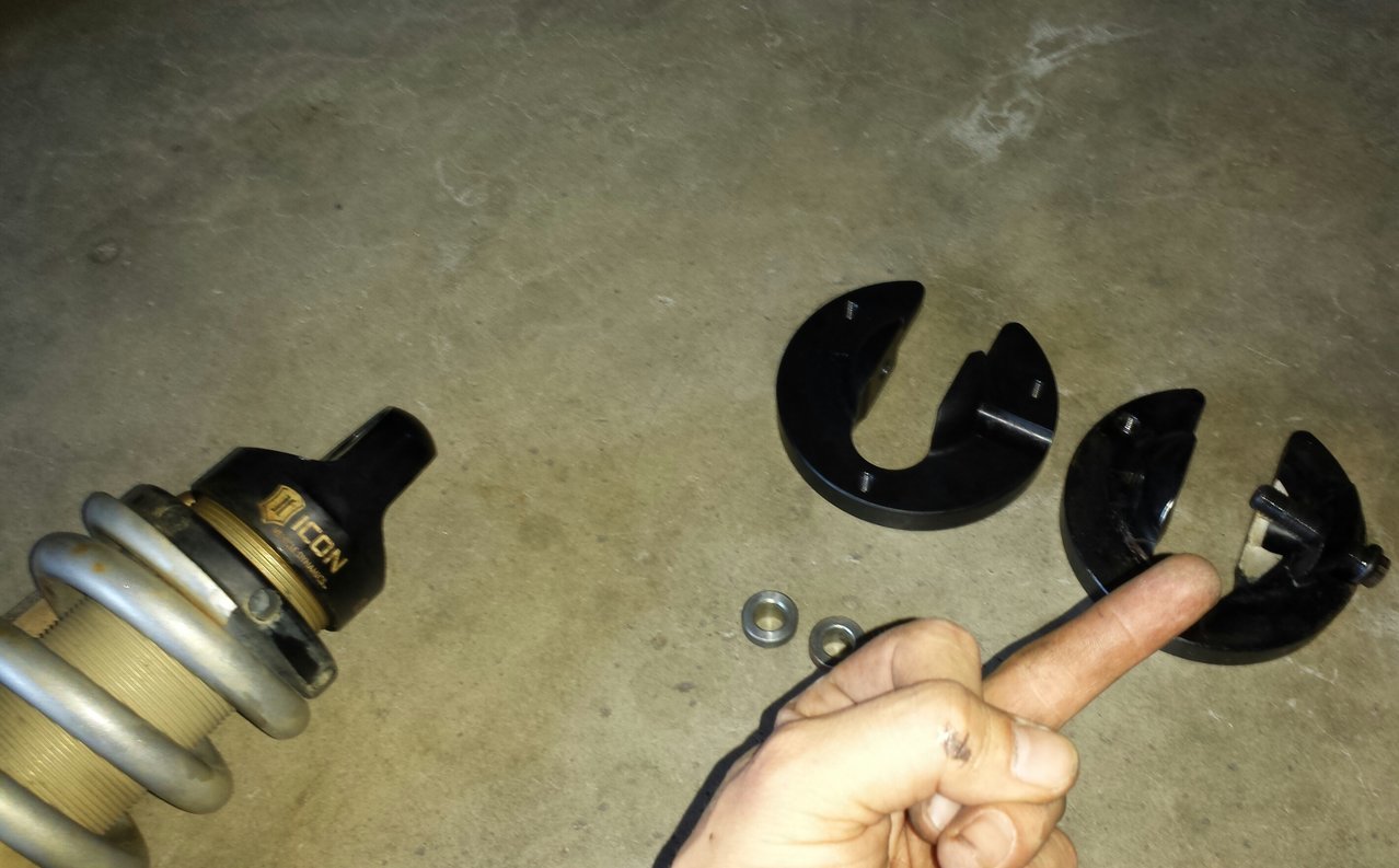

    Icon is shipping me replacement parts "under warranty" (they are 5 years old :notsure: ) today. :woot:

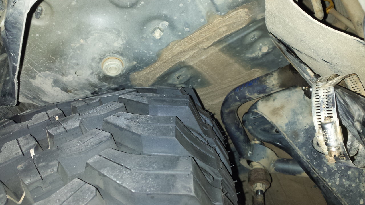

    Having 100% of your turning radius at full bump is overrated, right? :rolleyes:

    You're gonna need spacers bro

    For what, the UCA?

    Yes...I was running 4" bs and rubbed my uca
    At 4.75 it rubbed so bad
    Especially aired down. Now I run 1.25"

    I already have 3/4" spacers. The picture is deceiving though, that space is a little over an inch. But yeah, I'm keeping this in mind as I still might.

    Out with the old, in with the new....

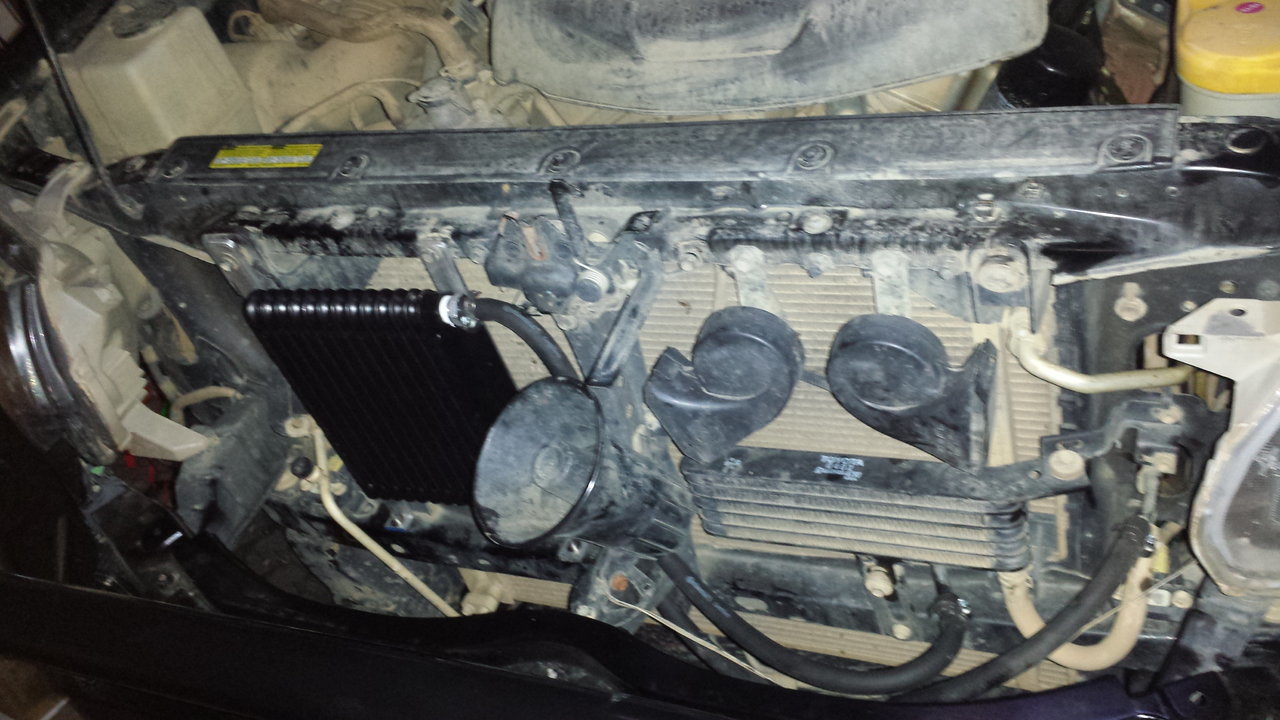

    Tranny cooler installed!

    Did you do a fluid swap too?

    I was supposed to get a complete flush this Tuesday but since my coilover was busted, and the parts didn't come in until yesterday, I had to cancel. Getting it done next week though. :thumbsup:

    So does that mean you're running low??
    Did you use the same cooler as linked a few pages back?

    No, I filled the cooler + lines to compensate for the extra volume.
    Yeah, same cooler that @inv3ctiv3 linked.

    Sweet. Did you have to weld to mount it? I gotta do this asap

    No welding, just bending AL and drilling a couple holes.

    Just went and looked! Looks easy. I don't even have a drill up here though lol
