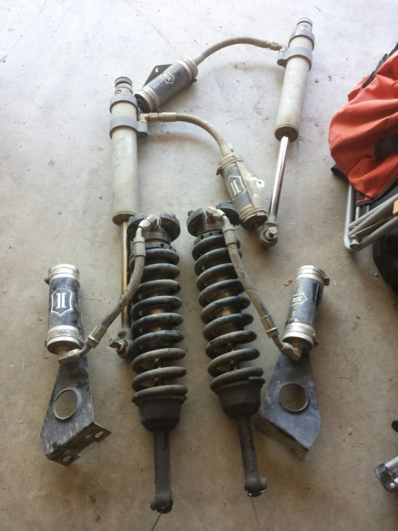

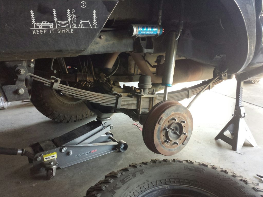

    Finally got around to taking the Icons off!!
    And put some kings on all 4 corners!
    And also installed a warn wEnch :D

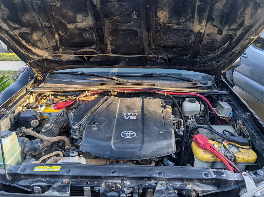

    Joined the cool kids recently a threw in a second battery (don't mind the body ground, that is getting upgraded) and the BlueSea MLCR. I isolated the new battery so it's only connected to the starter and have the accessories battery connected to everything else including the solar panel. Upgraded the "big-3" as well. :cheers:

    How much of a MF'r is it to add an extra battery back there with that pump?

    I built a bracket to hold it myself but didn't like it so I ended up just buying the battery try from OffGrid. It literally took 5 minutes to install, very simple!

    So it sounds like the hardest part of this project is just paying for it? LOL
    Did you follow any tutorial?

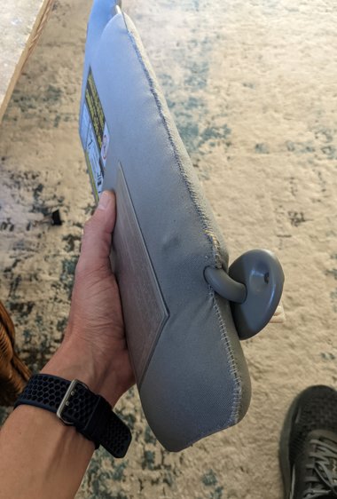

    Even fixed my drooping and noisy sun visor with my mad-good sewing skills. :laugh: best part is you can't see the seam once installed. LMAO!

    Hardest part was the wire routing since I used 1/0 for everything and also upgrade the big-3. There's not a lot of room near the starter/frame ground and those wires were originally bundled together with the COM wires to the starter. It was the hardest part, but not really that hard compared to a lot of other projects. So yeah, paying for it hurt the most. lol! I read some other threads but didn't really follow anything specifically aside from the wiring diagram provided with the MLCR. Super simple. Connect both batteries+MLCR and rewire positive from the starter to the new battery.
