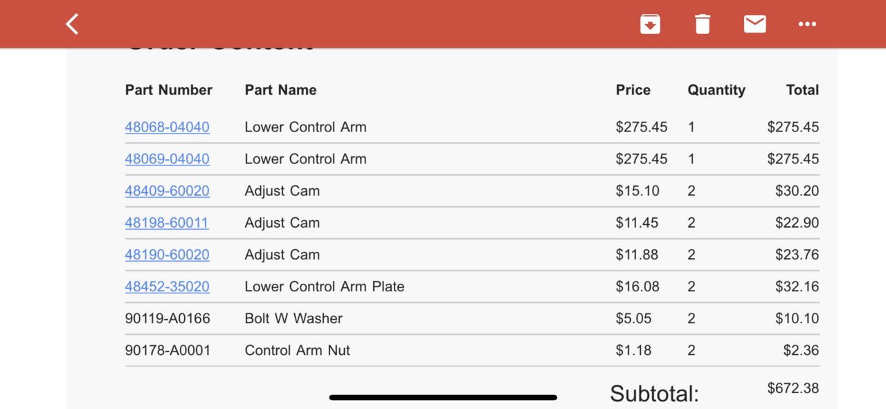

    He got them loose but the sleeve is totally seized in the bushing. Labor on pressing them out and new bushings in isn’t worth it. I ordered new OE LCAs (which come with new LBJs) and cambolts.. thanks for all the help guys. This one stings a bit because when it’s all said and done, all I achieve is an alignment.

    Parts ordered for anyone curious:

    Hey @EDDO, is it pretty self-explanatory which of these cambolts, nuts, plates go on which connection points on the LCAs? Some of them look pretty similar from what I can tell.. Hoping once I get it all it’ll be clear
