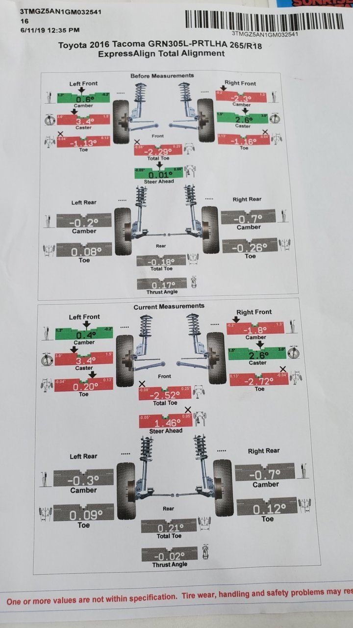

    This happened to me recently, I hit a pothole while turning and knocked my camber out of wack... brought it in and they said $1900 for the job. I find it hard to believe the pothole caused it but that's what the dealer is saying. 2016 with 58k. Going through mechanical breakdown insurance so :bananadead:20190611_123215.jpg

    Suppose you can elaborate what they want to do for that $1,900? That alignment sheet suggests a little more than a common pothole caused those numbers. Did you hit a big hole really hard?

    They said they have to cut the LCAs out and install new parts, labor, taxes; that's all I know so far. I hit the pothole at around 60 while turning.
