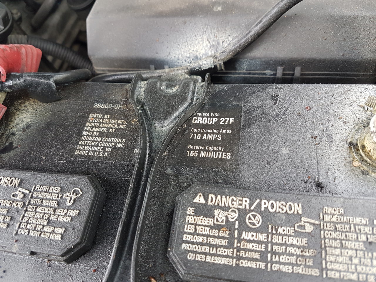

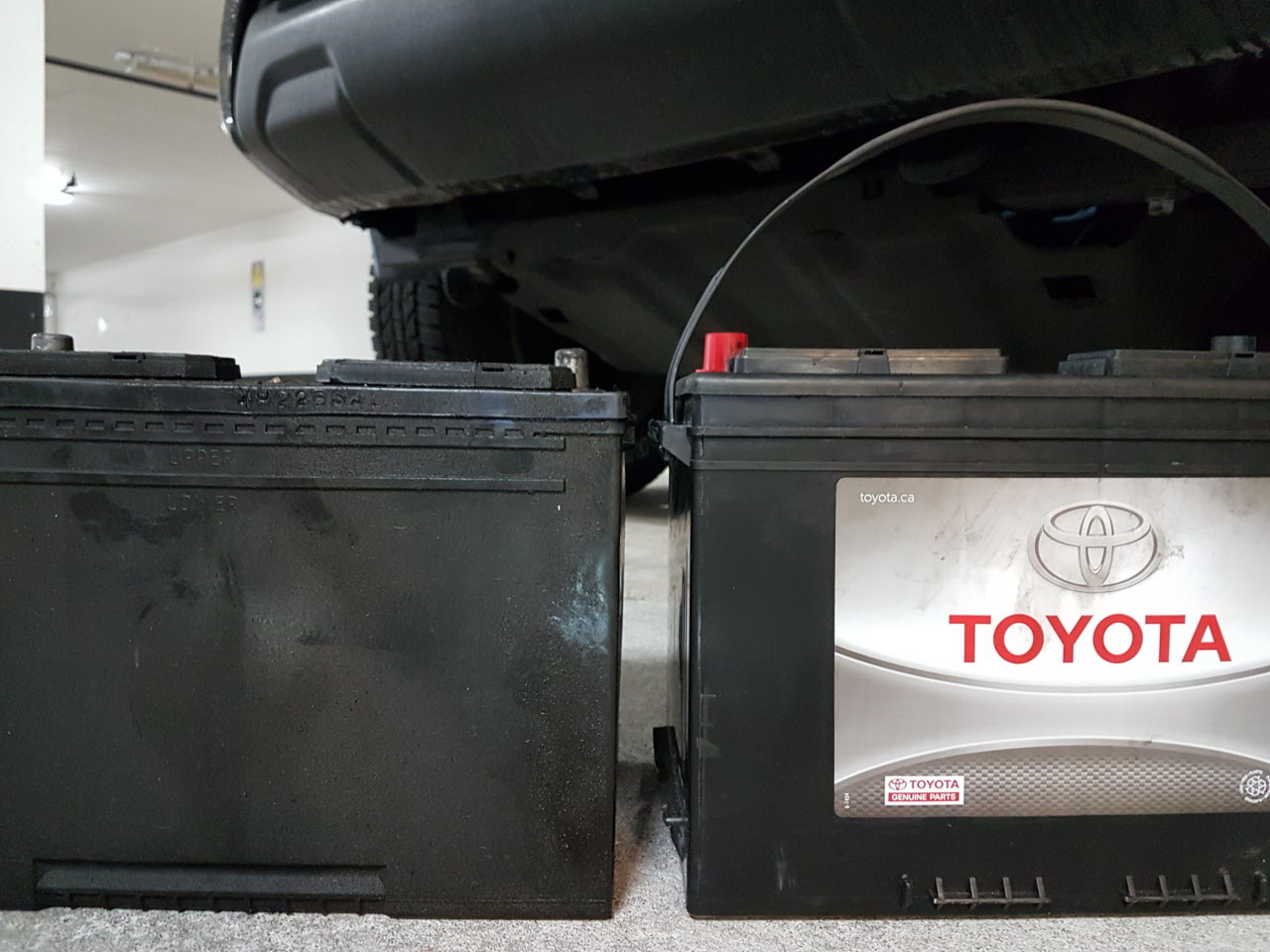

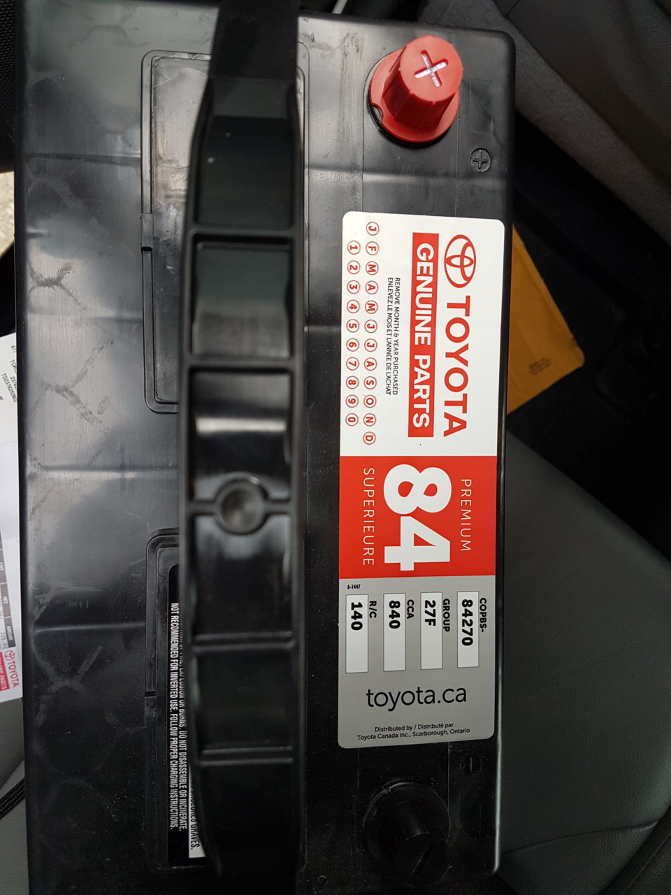

    20201014_133102.jpg 20201015_133746.jpg 20201014_132339.jpg Same story in October 2020.
    Proactive change of the OEM battery (6 years old) for my 2015 TRD Sport led me to this issue.
    The solution offered by the parts counter guys was to remove the original plastic tray, and install the battery without it. Hooks and crossbar fit, but very snugly against the top-rear edge of the battery.
    Pics hopefully clarify the problem OP, myself, and others may have had.
