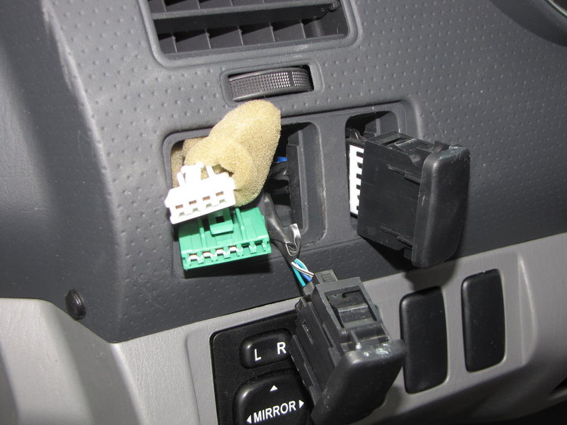

    I have a 2006 Tacoma pre-wired for fog lights (i.e. plugs hanging behind the bumper plastic blanks), but when I take out the dash blank there are two female plugs (a white four hole one and a green 6 hole - though only 4 of the 6 have wires to them). can you tell me which, if either, of these is the correct plug?
    I will attempt to add a photo of the plugs, if you could tell me which one to use that would be great.
    Any suggestions on switches and relays and prices would be fantastic - allowing for shipping to BC, Canada.

    SirGeoff- The fog light should be the white 4 pin. I just took mine out to confirm.

    Derecho,
    Many many thanks!!! now I have to figure out how to link that Toyota white 4 pin female to a non-Toyota lighted toggle switch (Toyota want $92 for a switch that others such as Otrattw or Oznium offer for $12!!! and the Toyota relay is $135!!!).
