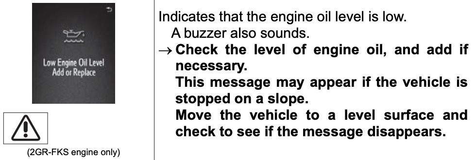

    You may very well be right. IIRC the warning light said "low engine oil level". I was a bit freaked at the time and my only thought was to get the engine off so although that is what the manual says it should display, can't confirm. For the oil pressure to be low on level ground, wouldn't the level have to be below the pump intake which would mean a 5 quart or so oil spill in the garage?upload_2023-10-5_18-6-24.png

    2gr-fks has an oil level sensor. It is inside the lower oil pan

    Rob
    2020 TRD OR
    Good to know. Thanks for the info. Any idea how much oil is still in the pan when the sensor registers low?

    Probably the warning level is set relatively to the oil strainer. I'm guessing 1.5-2 qtrs on level surface
