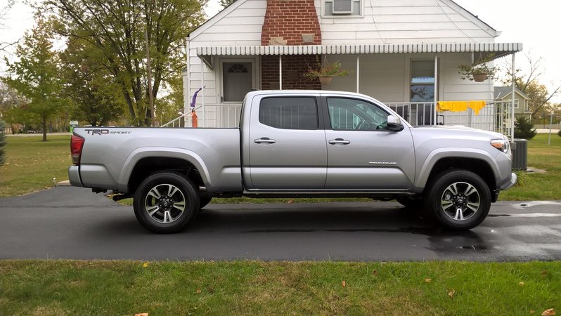

    Her is a pic by the way,been drivin a reg cab Tundra for 16 years,always wanted a Tacoma,love this thing so far!WP_20151017_11_25_55_Pro.jpg

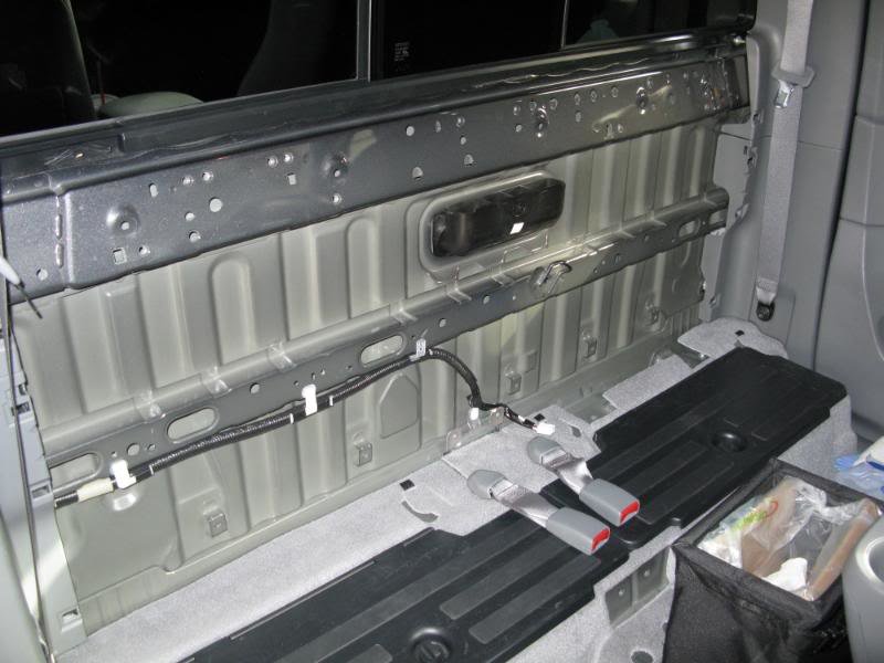

    there are cab vents back there to equalize the pressure so you can open and shut the doors.
    Maybe if one isn't snapped in all the way it allows more outside noise in??

    Where are they?
