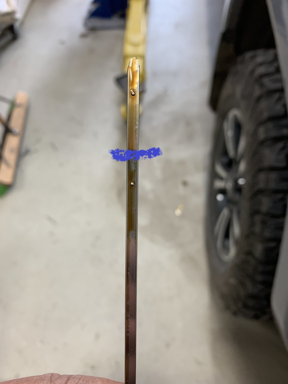

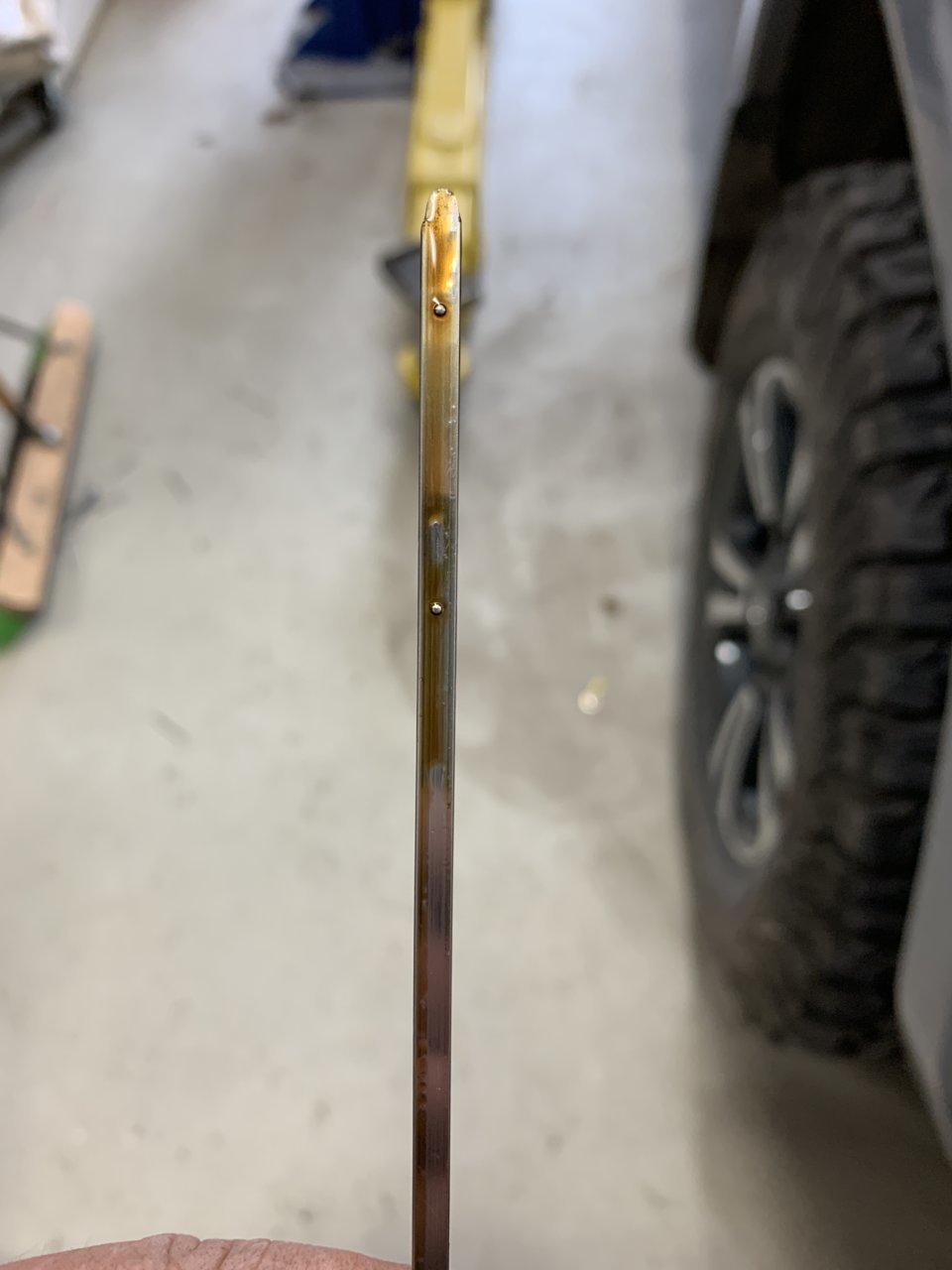

    Honestly it looks fine, and it looks like you don't know how to read a modern dipstick.

    My thoughts exactky. To me it looked like this was the level line, so it only looks to be less that a quart high. Not sure why everyone thinks there’s like 12 quarts in there lol.

    Please teach m e how to read a dip stick. it read the same after multiple
    Please teach me how to read a dipstick. It reads the same after every time. Why should it be any different than my last vehicle which was only 10 years old.
    Dealer drained 3/4 of a L out to bring it back to proper level. Im not sure where y'all got 12 quarts from... Its been documented but they still claim "Science" that it was over full. Head office is extending my warranty based on the simple fact that this is not the first time this specific dealer has shit the bed maintaining my 2016 and 2018.

    Did your last vehicle use 0W20 oil? It's really thin and hard to read. Pull the stick, wipe clean, WAIT a few minutes (like 5-10), straight and straight back out, level is where the break is, which to me looked just under the full mark. I like to check mine after its sat over night, then the tube is clear.

    Pull the dipstick out and leave it out for 5-10 min. Put it back in, and then check the level. Make sure to check both sides of the dipstick. One side is usually messier than the other side, the side of the stick that looks cleaner will have a more defined oil level mark on it.
