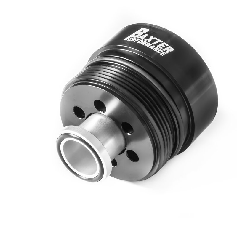

    My dealer, Charles Maund Toyota in Austin, over tightened mine. The first time I changed the oil after my not-so-free oil changes ran out, I broke 2 of the cheap oil filter wrenches trying to get the filter off . Finally, I bought the Snap-on oil filter wrench for Toyota. When I put it on the filter and turned, the filter housing snapped before it let go. Fortunately, when it breaks, it's easier to get off and I had no trouble removing it. Had to buy a new oil filter housing. Called and left a message for the service manager at Charles Maund, but he never called me back. The service writer said that they wouldn't pay because I broke the housing, even though there's only 1 way that the housing would be that tight. Lesson learned.

    I had the same problem. It is Baxter Performance.

    What is this Baxter spin on adapter you speak of and by what URL may they be found?

    I've done bit of small time shade tree work on my vehicles and simply prefer clean hands. Man, some people like to judge. I didn't get anywhere with local dealer and I'm just going to buy an aluminum adapter and take care of at the next oil change.

    $199. :eek:

    Yes it is a bit pricy, but no more oring replacements and no need for special wrench to remove filter. Had a canister spring mechanism go bad in a 3.6L JK and left me wondering what ended up in the motor. Yes, some oil will spill out when spin-on filter is loosened but that is normal for any spin on. Oil change takes 1/2 the time so for me this is great. Price of quality spin-on is less than same quality canister. Will I recover my entire $199? No but the lack of hassle makes up the difference.
